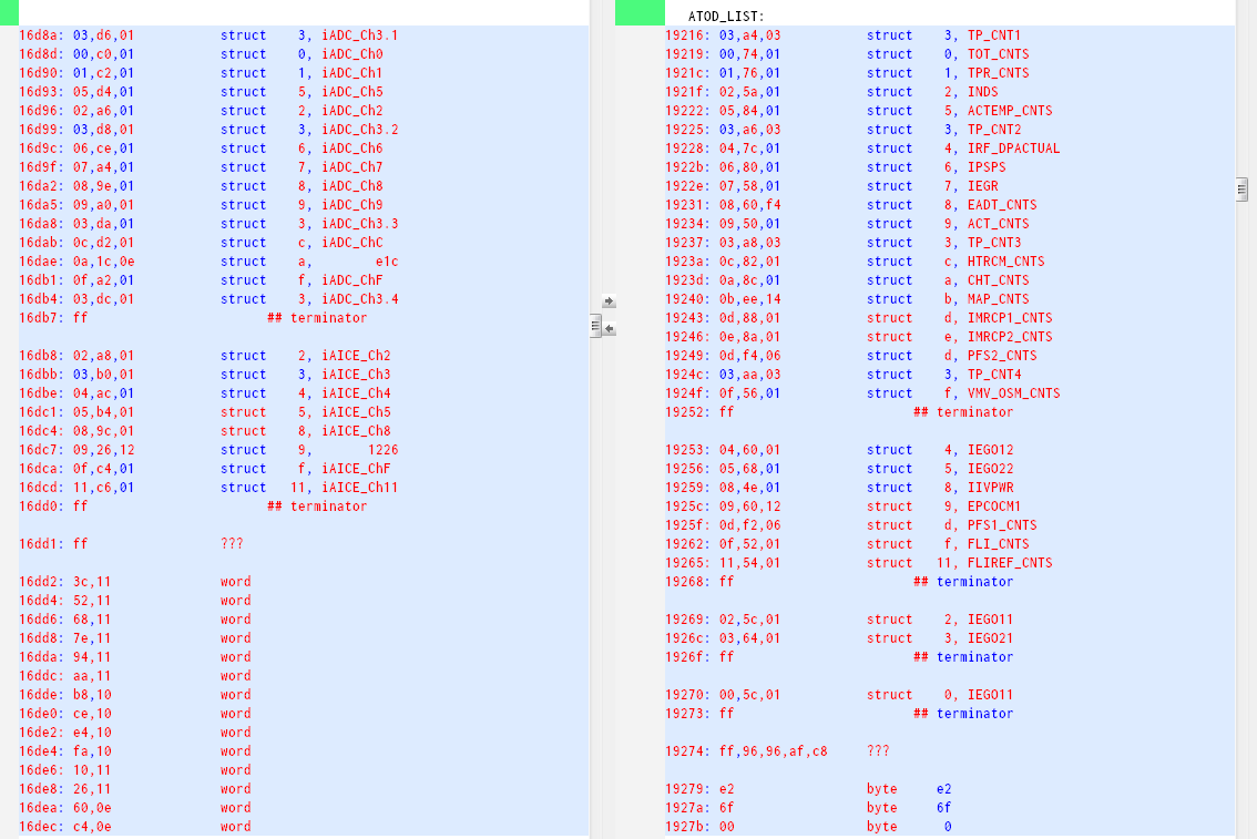

Having run SAD with the DIR converetd from DMR, I've opened both EQE3 and REAC4 in ultracompare.
I've manually aligned the ATOD_LIST in each.
The RZASA DMR had names for the ATOD_LIST and all the analog channels.
Straight up we can add to the EQE3 DIR;
SYM 16D8A "ATOD_LIST"                         # Address of analog to digital channel list
One of the channels stands out because of repeated use. That's interesting lets check that one out.
Both RZASA and EQE3 read Channel 3 multiple times. The RZASA DMR has it as TP_CNTx. Good enough for Ford, good enough for me.
Let's see in EQE3 if TP code is the same.

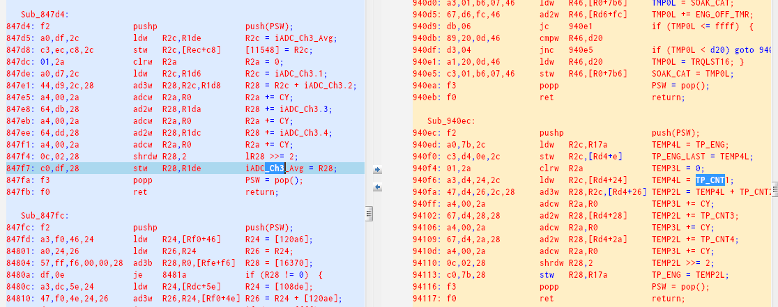

I search EQE3 for _Ch3 and get a hit at 0x847D4.
I search RZASA for TP_CNT and get a hit at 0x940EC.
Line them up to compare
They are a match.
We are going to edit or add to EQE3 DIR.

   ATOD_LIST:
16d8a: 03,d6,01           struct    3, TP_CNT1
16d8d: 00,c0,01           struct    0, iADC_Ch0
16d90: 01,c2,01           struct    1, iADC_Ch1
16d93: 05,d4,01           struct    5, iADC_Ch5
16d96: 02,a6,01           struct    2, iADC_Ch2
16d99: 03,d8,01           struct    3, TP_CNT2
16d9c: 06,ce,01           struct    6, iADC_Ch6
16d9f: 07,a4,01           struct    7, iADC_Ch7
16da2: 08,9e,01           struct    8, iADC_Ch8
16da5: 09,a0,01           struct    9, iADC_Ch9
16da8: 03,da,01           struct    3, TP_CNT3
16dab: 0c,d2,01           struct    c, iADC_ChC
16dae: 0a,1c,0e           struct    a,      e1c
16db1: 0f,a2,01           struct    f, iADC_ChF
16db4: 03,dc,01           struct    3, TP_CNT4
16db7: ff                       ## terminator
   Sub847D4_TP_CNT>TP_ENG:
847d4: f2                 pushp                  push(PSW);
847d5: a0,df,2c           ldw   R2c,R1de         R2c = TP_ENG;                     # [1DE]
847d8: c3,ec,c8,2c        stw   R2c,[Rec+c8]     TP_ENG_LAST = R2c;                # [11548]
847dc: 01,2a              clrw  R2a              R2a = 0;
847de: a0,d7,2c           ldw   R2c,R1d6         R2c = TP_CNT1;                    # [1D6]
847e1: 44,d9,2c,28        ad3w  R28,R2c,R1d8     R28 = R2c + TP_CNT2;              # [1D8]
847e5: a4,00,2a           adcw  R2a,R0           R2a += CY;
847e8: 64,db,28           ad2w  R28,R1da         R28 += TP_CNT3;                   # [1DA]
847eb: a4,00,2a           adcw  R2a,R0           R2a += CY;
847ee: 64,dd,28           ad2w  R28,R1dc         R28 += TP_CNT4;                   # [1DC]
847f1: a4,00,2a           adcw  R2a,R0           R2a += CY;
847f4: 0c,02,28           shrdw R28,2            lR28 >>= 2;
847f7: c0,df,28           stw   R28,R1de         TP_ENG = R28;                     # [1DE]
847fa: f3                 popp                   PSW = pop();
847fb: f0                 ret                    return;

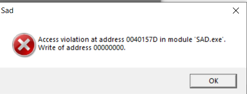

when I try and run my bin through the sad.exe windows version I get an error message. So I stopped using that version. Maybe I am doing something wrong? I just run the sad.exe and go to open and click on the bin I have been using
They are a match.
Also..I am sorry, but I feel stupid. I don’t see where they match up exactly. Should I only be looking at a portion of the code instead of the whole line of code to match?
"Exactly" is setting the bar too high.
You should be looking at what each line of code does and in combination as a subroutine. More or less the opcodes and inputs.
Ignore the addresses, they rarely if ever match across different strategies.
Rzasa has names but eqe3 does not until we add them. Overlook that to see the underlying code sequence.
Try comparing the same code from both as raw lst, maybe it will be clearer.
Both subroutines add the 4 reads from analog channel 3 together, then divide by 4 using shift right >>2. They are averaging 4 reads of throttle position. They also save the previous average before updating the current average. So they match because they do the same thing.

BOOSTEDEVERYTHING wrote: ↑2023 Oct 24, 15:45 when I try and run my bin through the sad.exe windows version I get an error message. So I stopped using that version. Maybe I am doing something wrong? I just run the sad.exe and go to open and click on the bin I have been using
That's program crash, you are not doing anything wrong, that is some kind of bug... !DAMN! (or stronger). That should never happen. It should be robust to everything, even user errors. If there is a serious error it should just refuse to disassemble.
"write to address zero" hmmm....that's DEFINITELY a bug on my part.
Yes there are some versions with bugs in which cause crashes. SAD should say what version in the xx_msg.txt file (where xx is the bare name of the bin (ie. without the .bin)).. can you tell me which version ??
Generally the latest version on github is the best (but not always, new bugs can creep in...) Official stable is 4.06, but if you go into 'development' subdirectory it goes to 4.012 . If you are using that one, I am interested in how you managed it (so I can fix it).
Please confirm - 1) which bin. 2) send your dir file and cmt file if you have one.... and I'll see if I can find the bug.

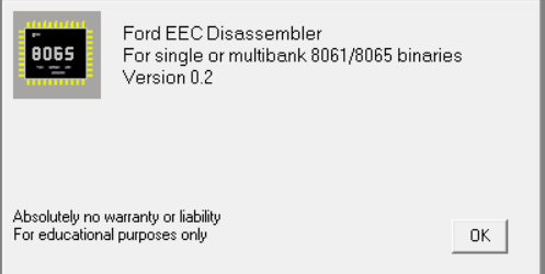

Posts: 442
Joined: 2023 Sep 06, 13:11
Location: Charlotte NC , USA
Re: EEC V file conversion
the version is 0.2 in the about drop down, not sure if that helps?I will post a screen shot and the bin I am using.
eqe3_ml2_8a1a_stock read burn1fnb.bin
(256 KiB) Downloaded 575 times
