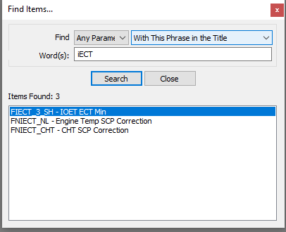

BOOSTEDEVERYTHING wrote: 2023 Oct 08, 22:12 I can't seem to find either one, I'm not sure what i am doing wrong. IECT may just not be present because it uses a CHT sensor instead.
See if you can find ACT_CNTS or ACT_CNTS.
_CNTS suffix may be used instead of i Prefix.

FIECT cane be found in the CDAN strategy document which is on github.
https://github.com/OpenEEC-Project/Strategy-Documents
CDAN wrote: - FIECT_3_SH = ECT to force alternate fire, high load.
