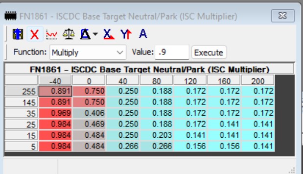

How much did you change FN1861 table?
I noticed when I started dialing in my startup idle, I had to make bigger changes than I thought (like increments of 0.5) to get noticeable changes in the colder temp columns (100F and below).

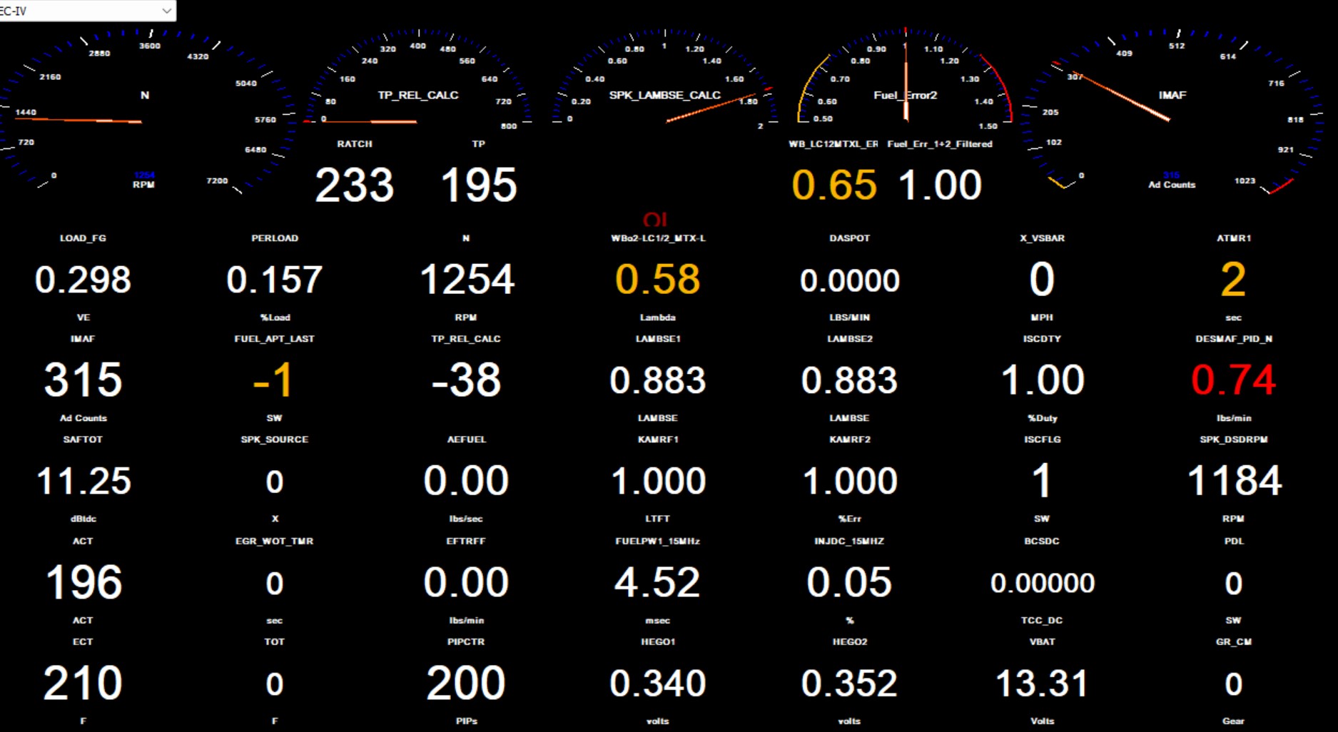

The ISCDTY is going to 100% immediately after startup and stays there for 5 seconds then starts to come done. There must be a table that I'm missing. Attached is a screenshot of FN1861 and the dashboard.
- Posts: 7113
Re: High initial startup RPM
desmaf is adding 74% duty cycle

Where do I look to find out what's causing the desmaf to add 74%? I've read the writeups over and over and cant figure this one out.
- Posts: 7113
dsdrpm is higher than actual N rpm so closed loop idle control is adding air to reach target idle
if its commanding that high of an rpm when warm started and still not hitting target then there are 2 most likely culprits
first its either too lean at startup and the engine is needing a ton of air. Go add 0.15 to the startup enrichment table for the first 15 seconds and see if it makes her happier.
and secondly for it to command that high of a duty cycle when hot starting either the throttle stop is too far out which you can verify but waiting til she gets to warm stable idle after shes been running at least 5 minutes over 200 degree coolant temp. If the iscdc is above 35% then the throttle stop needs to be opened up. Otherwise the idle air control valve is probably not working correctly either wiring or its weak / old or installed backwards.

I figured it out. I was adjusting the ISC multiplier the wrong way. It wanted more but I kept taking it out.
