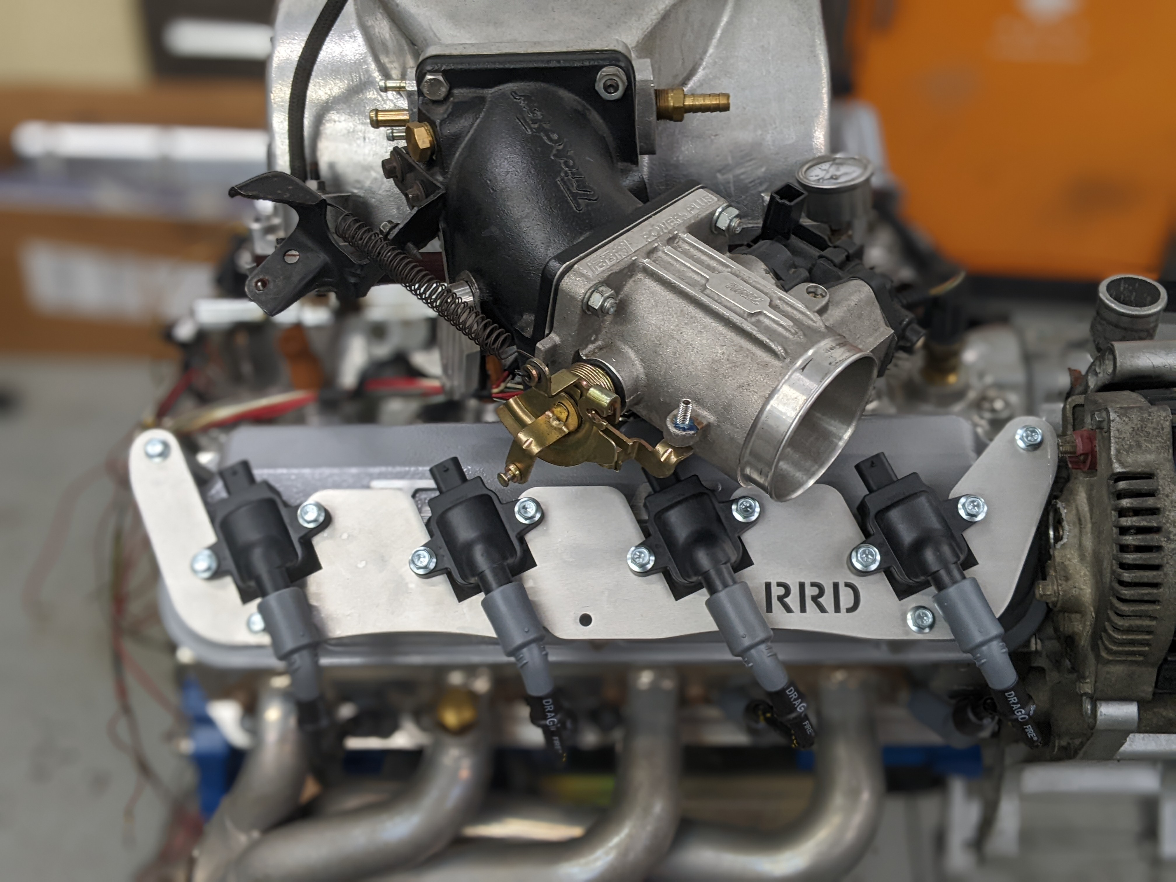

As been mentioned, I plan to use the 7.3L Godzilla coils for my coil near plug setup. There are options out there to mount coils on a SBF but they are quite expensive. While I like the idea of welding bolt pads onto of the valve covers I didn't want to mess up the brand new trick flow coils and I haven't welded aluminum before. So that leaves a bolt on option. My plan is to design a plate and then use standoffs to mount it above the valve cover. After a little bit of cardboard aided design and transferring it to Fusion 360, I got this:
I have really come to like designing in Fusion 360 and then uploading to SendCutSend to get plates cut. Along with parts from McMaster-Carr I get this awesome looking setup.
I think this really turned out great. Now this does require an intake manifold spacer, which I already had installed.

Re: Mustang SBF EECIV to EECV Swap
Good job on the coil mounting brackets.
I'm doing the same, but I do not like the mounting of coils directly on top of valve covers.
My plan is to mount to the outside of valve cover, more directly overtop of spark plug, but also more directly over top of headers.
Is this a heat problem, mounting over top of headers/spark plugs, beside valve cover?
Is this why almost all COPs are mounted on top of valve cover?

I'm not sure but there could be a heat problem. You may also need custom or shorter spark plug wires. I think most are on top of valve cover due to convenience of being close to engine harness and flat mounting surface. Personally I like the look of coils on top of valve covers, which is why I went that route.wwhite wrote: ↑2023 Feb 12, 23:23 Good job on the coil mounting brackets.

For the bracket, the 7.3L coil mounting holes are 2.315 inch apart. The holes in the coils are slightly oversized allowing some play when using 1/4-20 bolts. I don't know the dimensions of LS coils.
