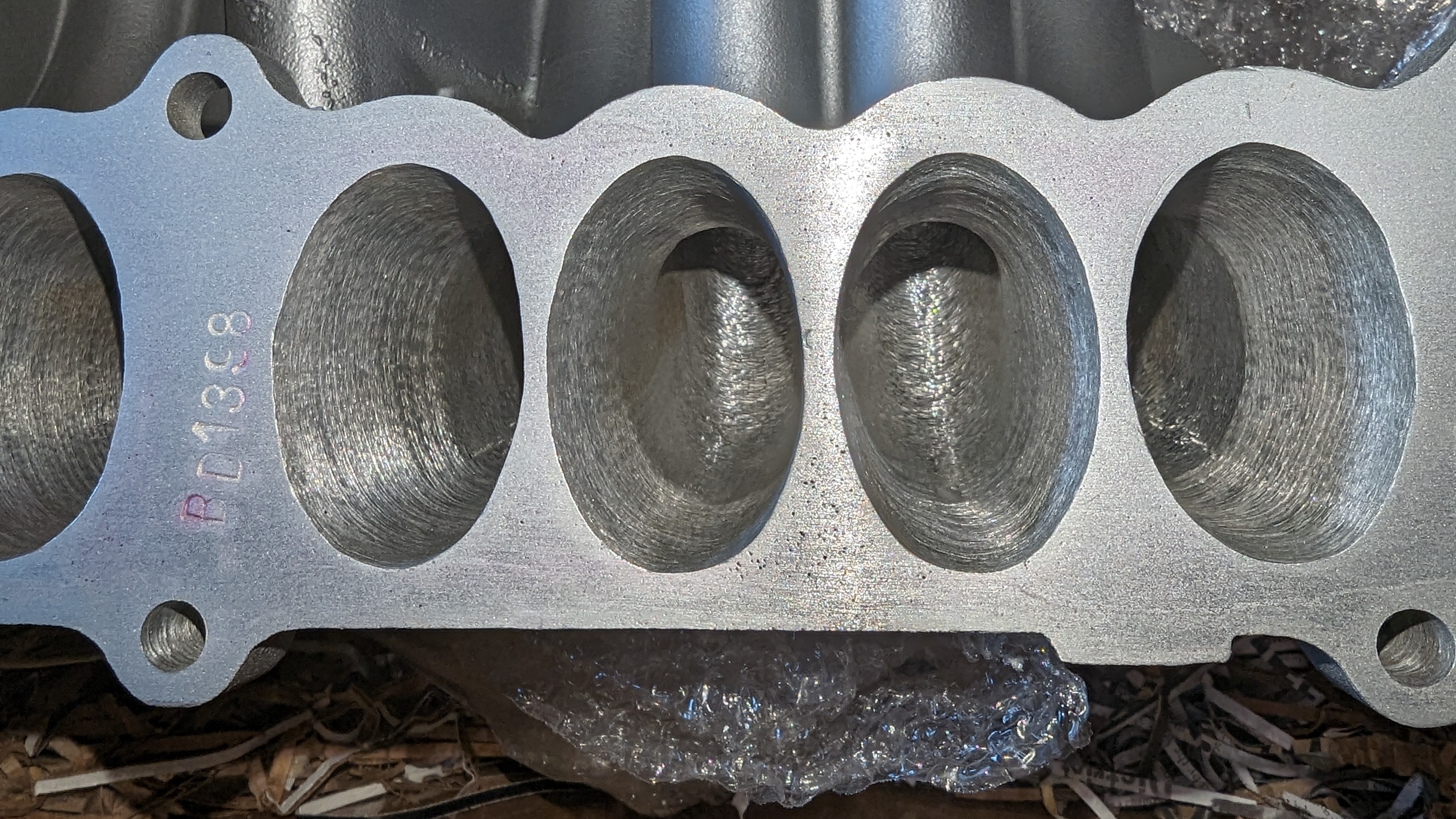

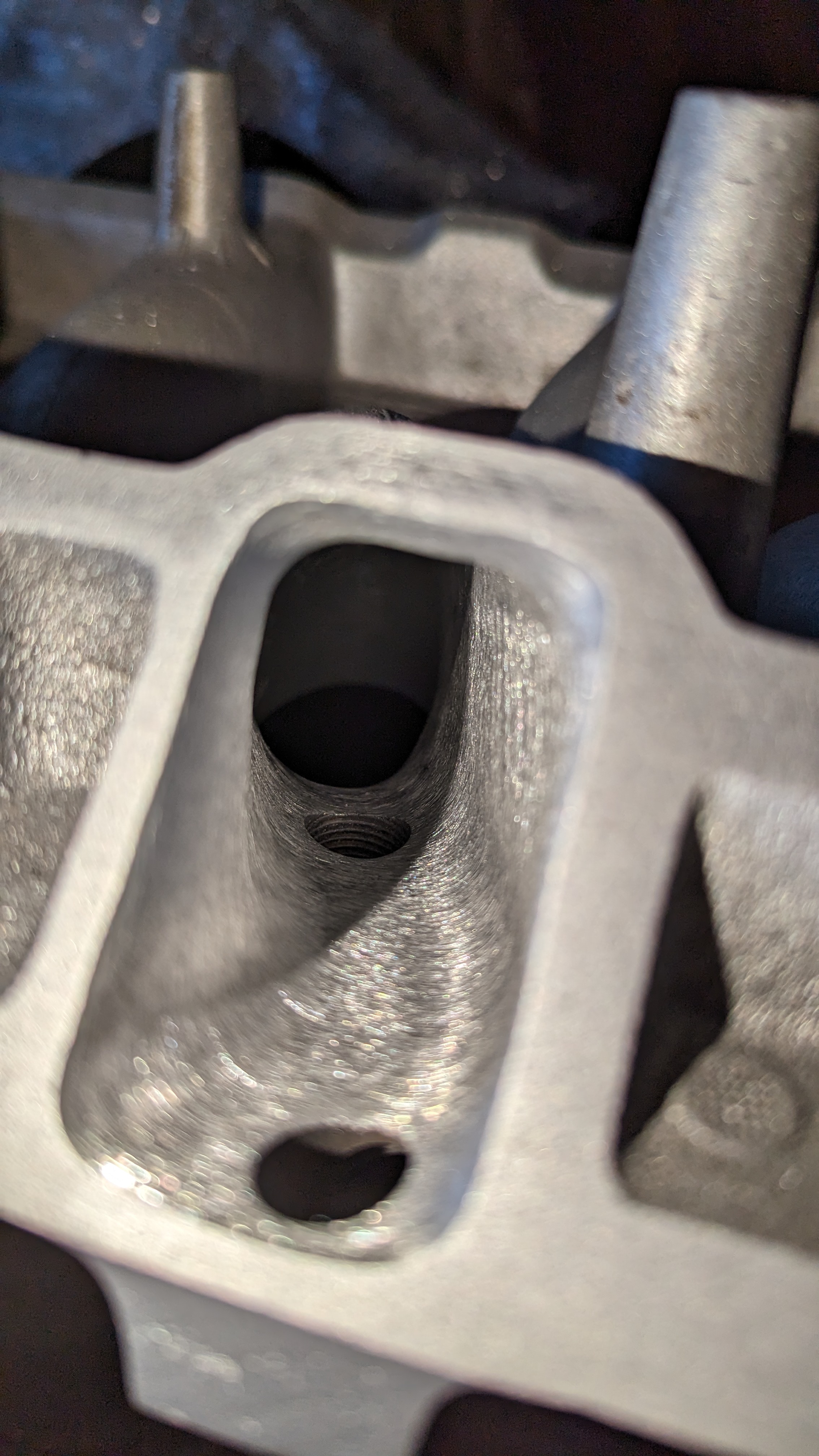

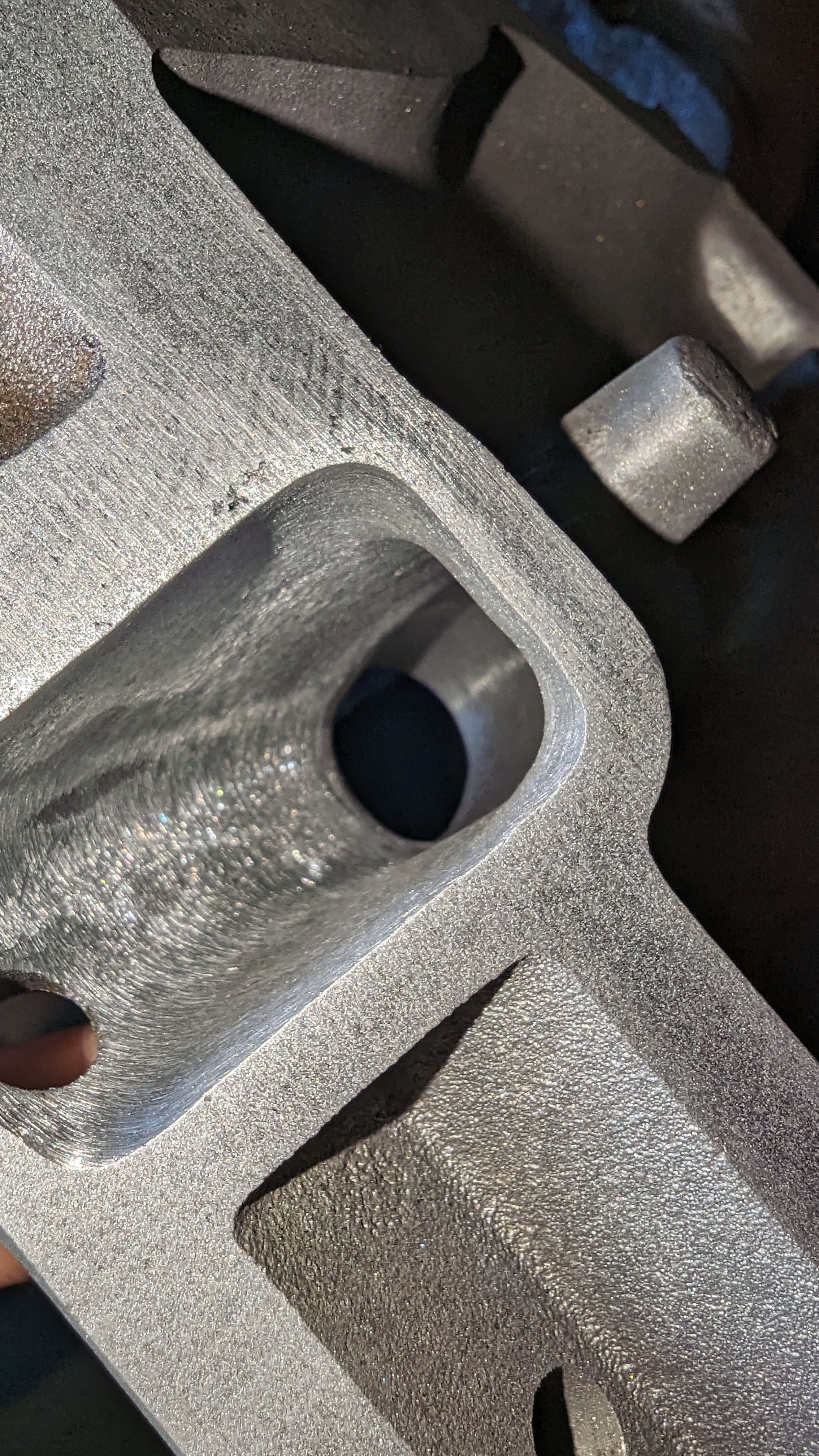

Big dogs is porting my stock upper and lower intake. They can get them to flow ~240 CFM which is nearly what the ported AFR heads flow. I'm pairing it with a 61 mm BBK throttle body.
