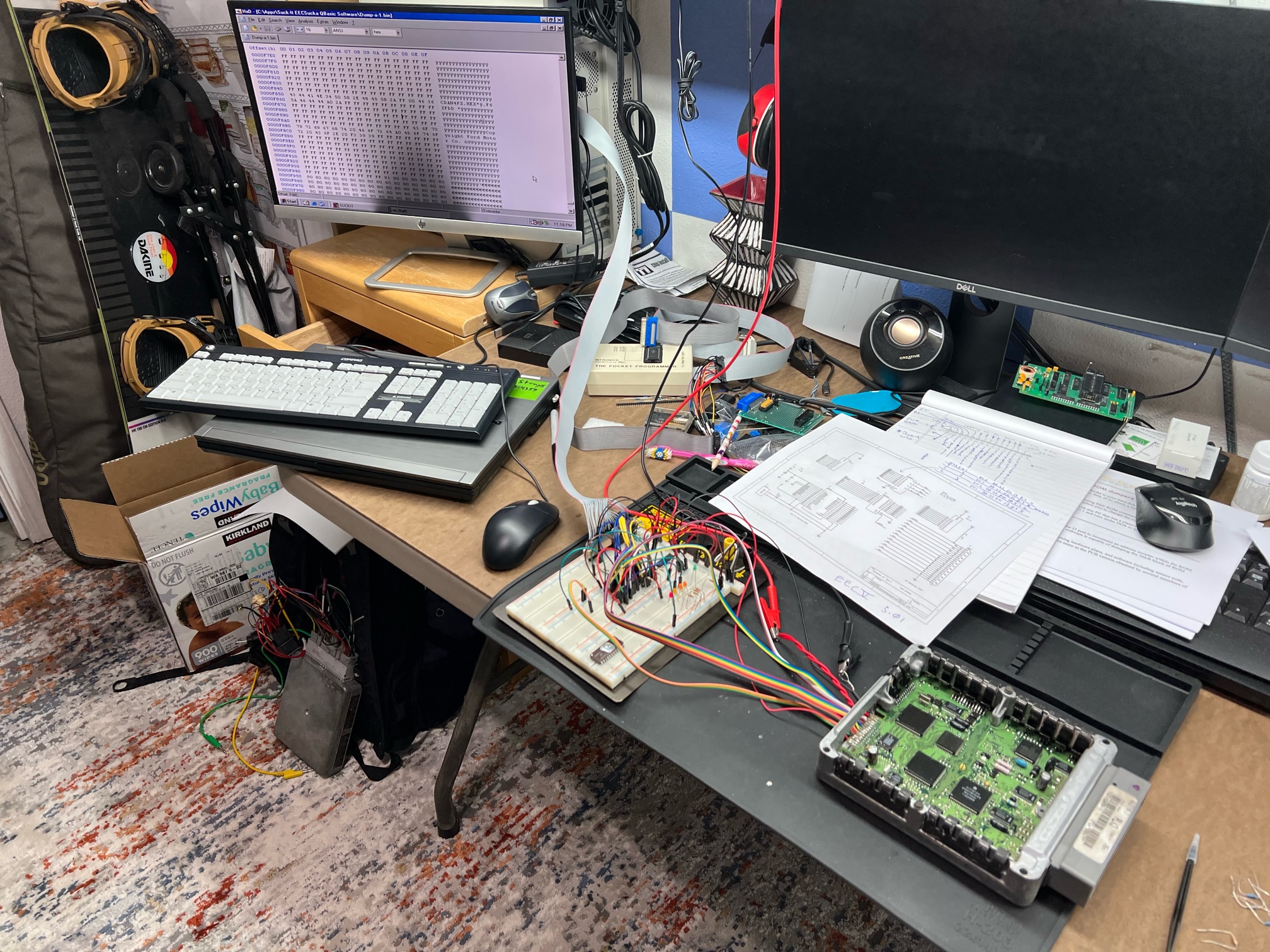

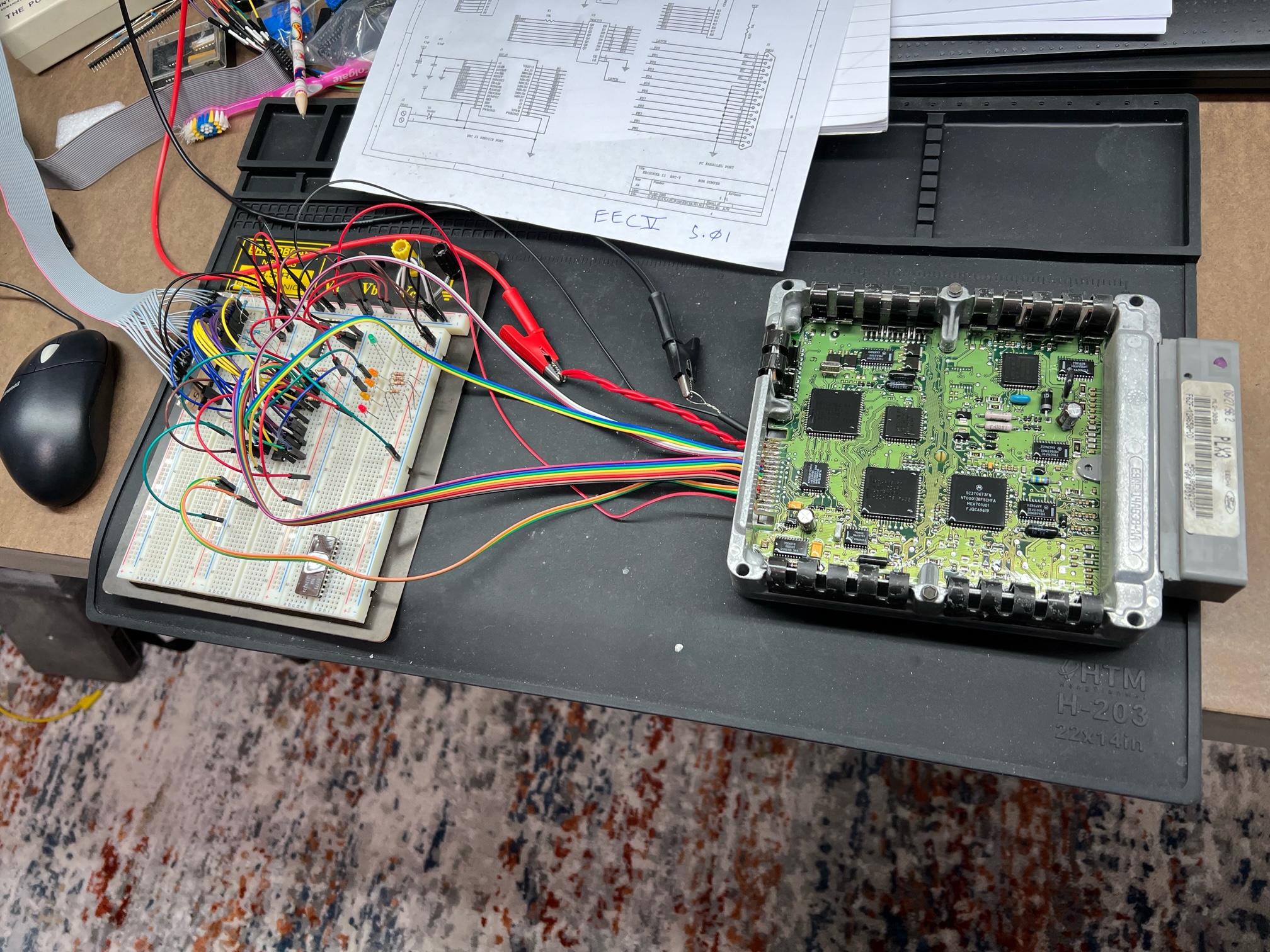

Some success maybe, having some fun either way. I'm really more interested in the GUFx EECIVs but didn't want to chance hurting one of these and so the 1995ish v6 mustang EECV PLX3 is offered as the sacrifice to the EEC GODS. This is a two bank EECV and I'm confused about the banks and read a bunch of Decipha's info here on this forum but still don't quite understand.
The hardware I've kludged up in these pictures is my best attempt of what I think was called EECsukaJR or maybe Son of EecSucka. It's using Andrew March drawing revision 5.01 titled EECSUKA II EECV. I'm using WIN98SE on an old Pentium3 1G computer with a built in parallel port (This is being done with standard LPT (not bi-directional). I'm using a program written by Craig Motes called SUCKIT.exe that reads for all four banks each getting their own output file. I would love it if anyone can help me determine if my reads are working. I'm using an old hexeditor called Hxd on the old WIN98 box and looked through the BIN files.
Bank 0 reads out all zeros from $0 to $FFFF
Bank 1 starts with zeros then at $2000 it has 27, FE, 0C, A0, E5 and other data including a bunch of $FF in blocks and $80 in block near the end.
Bank 1 also has promising looking info in the ASCII just before the weird block near the end CDAN4PX.HEX and Copyright Ford Motor Co. ends at $FFFF
Bank 8 starts with FF, 3E, 0F, 20, 03 and has other data all the way to $FFFF
Bank 9 same as bank 0 it reads out all zeros from $0 to $FFFF
The beginnings of Bank 1 and Bank 8 don't match up with what Decipha has in one of his writeups so I concerned if this is a good read????
Can anyone verify my read? Can anyone explain the reasons behind Bank numbering 0,1,8,9? Should be in a different thread I'm gettin way out in weeds here, please let me know but since this is a sub-category of Moates support, I thought maybe here is ok.
Thank you
J.W.S.
Thank you
J.W.S.
Reminder: Attached BIN files are form CDAN4 EECV calibration PLX3

Only Dump-A-8.bin has data (Garbage not a useable bin). The others are just zeros. Download this tool to help: Just drag your file onto the EXE to disassemble. It will tell you in the txt file that generates if you have a bad bin.

More good progress, I now have my bread board ECCSUCKA using a 74LS157 and found with 4.7K pull downs on MB0-7 I'm getting consistent good reads. I also changed the circuit some. The ECCSUCKA design I was following had MB5 not pulled down and instead going through a 10kohm resistor and to pin2 of the latch chip 74HC373. I read a detailed narrative on an Andrew March web page from the year 2000 that explained loading $20 and $00 into the EEC. My changes include disconnecting the MB5 from the latch and pulling it down like all the other MBUS lines.
Quote from an Andrew March web page
"The hardware design of the dumper is a little bit sneaky. Notice that initialising the Slave Program Counter involves writing either the value 0x00 or 0x20 on to the MBUS at various times. In other words, the dumper only has to control just one bit (MB5) to generate these two values. This is achieved by a single latch output that sets the value of MB5 via a 10K resistor while the remaining bits (MB0-4, 6, 7) are held at logic zero by pulling them down through 10K resistors."
So far, I'm concluding that the "EECSUCKA II EEC ROM DUMPER revison 5.01" that I have built is not the correct design that Craig Motes was using when he wrote his QuickBasic SUCKIT.EXE program that I'm trying to use. Like I mentioned above I also had to pull down a little harder on the MB0-MB7 lines by going to 4.7K pulldown instead or the 10K. The SUCKIT program reads for the full 64K for each bank and outputs 4 separate files one per bank. I've learned a new word (Concatenate) that simply means to link or chain the HEX files together and then I get a 256K file. I found on Decipha's disassembly write up page the instructions for getting this back down to the 112KB it should be.
It helped having the real PLX3.bin file from sailorbob to understand what I was cutting out of the file to make it a good 2 Bank 112K file. I also found a shortcut that works because I'm getting 2 completely blank 64K banks filled with 00s why add those in to just have to cut them back out. Banks 1 and 8 are reading out with 00s from address 0 to $1FFF, the actual data starts and address $2000 with the identifiers that Decipha also mentions in his disassembly writeup (27,FE,0C,20 for Bank1 and FF,FA,E7 for Bank8). If you only concatenate banks 1 and 8 you first delete $0 to $1FFF then delete $E000 to $FFFF and your done the file should now end at $1BFFF. After the file is fixed up it has start with the bank 1 identifier at address $0 (27,FE,OC,20) and the Bank8 identifier FF,FA,E7 is at $E000 and the file ends at address $1BFFF.
I would still like to know what the skipping bank numbers is all about and why Ford did this if anyone know or has a theory.
Thank you
J.W.S.

Craig's 'Suckit' program is written for the 'Son-of-EECSucka' design which I am guessing (I have not seen the 'Son-of-EECSucka' design) is not the same as the Andrew March 'EECSucka' variants.
If you are looking to improve the design then something these basic parallel port ROM dumper designs don't seem to allow for is that the MBUS should be tri-stated whenever the DI is to be changed.
