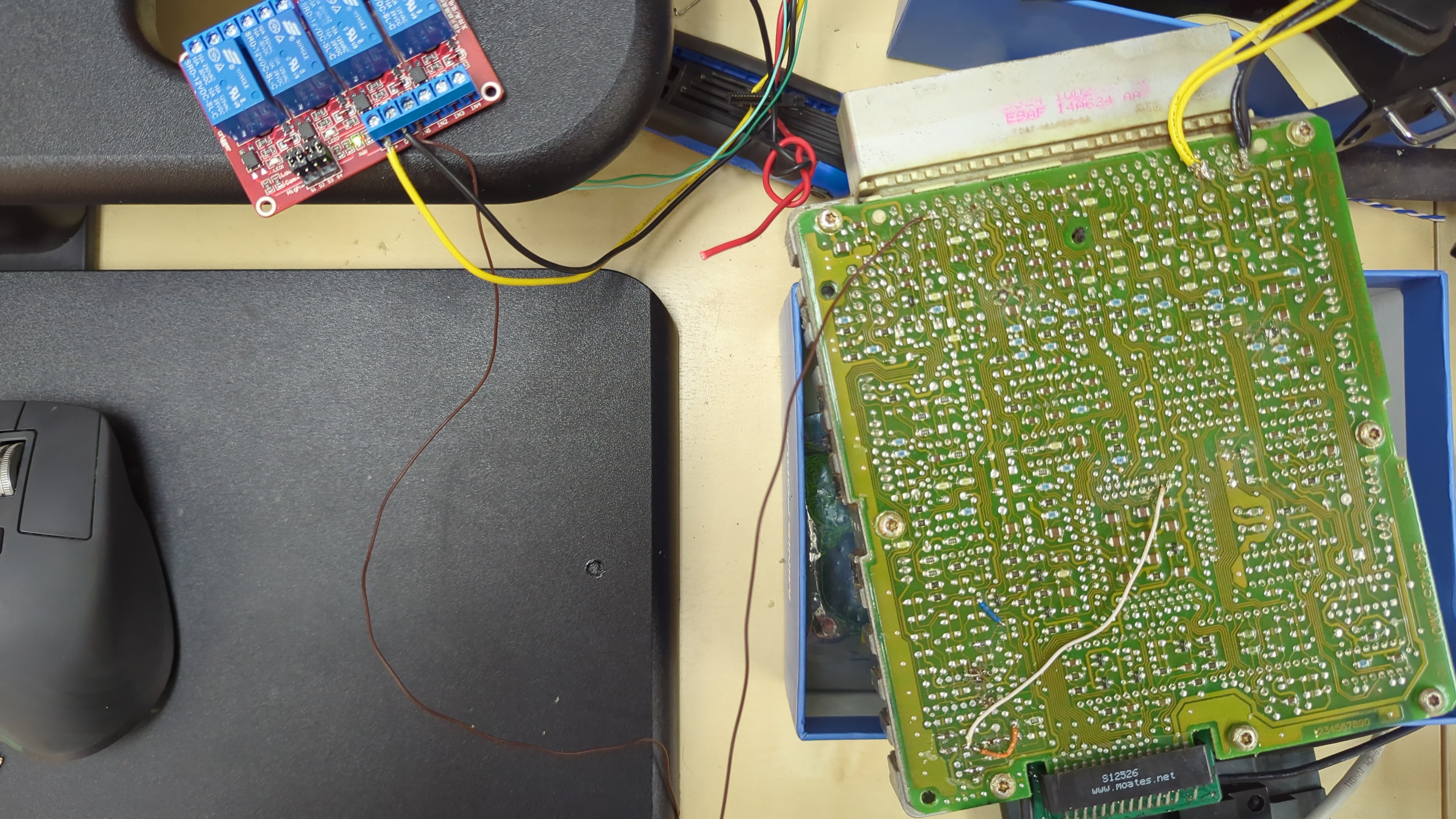

Finally figured it out! I'm using a pull-up resistor connected to the 5 volt reference pin. That is then connected to the ECU pin and the high input of the relay board. Once I implement the optocoupler circuit, I will send pictures and schematics.

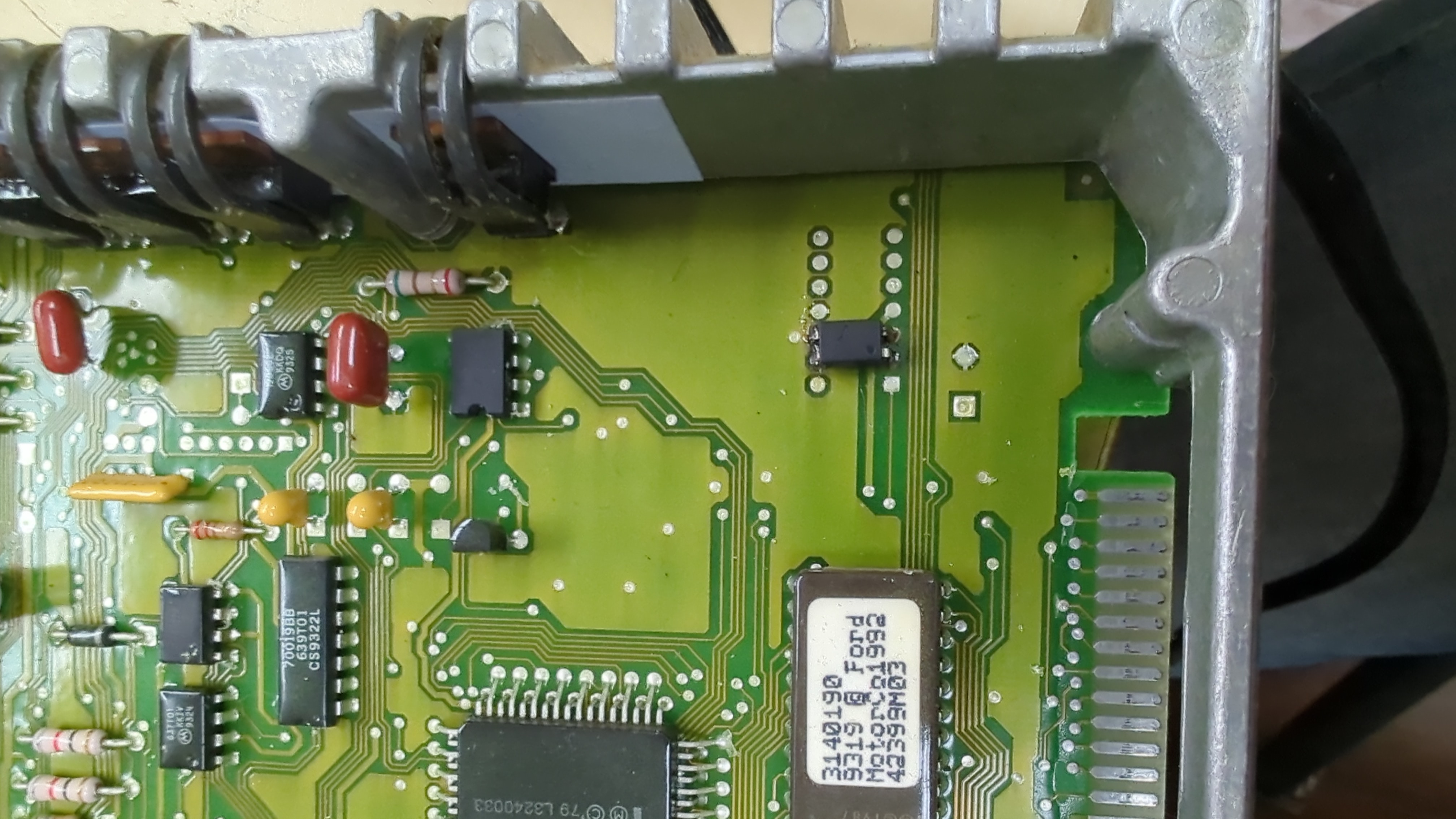

Got the optocoupler circuit figured out. I was able to use a bunch of available pads/traces and solder it right in. Not my prettiest work but should get the job done safely. IC is Cosmo 1010. More to come.

That’s awesome. That spare pad area you used is where the knock sensor chip would be on 6cyl sd47 hardware, fyi
