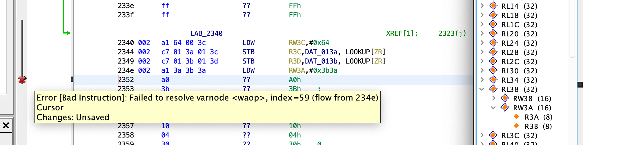

Found an issue with the following line:
My emulator shows disassembly as:
The problem is that R3b is not word aligned, and your disassembler shows it as R13a.
Should disassemble as
Also, using Ghidra, it is impossible to disassemble due to the misalignment.
The above screen shot shows RAM area, double word reg RL38, then word reg R3a, and byte reg R3b.
I'm not sure if your trying to log a word or a byte.
If byte R3b, then opcode needs to change.
If word, 3b, needs to change.
2352: a0,3b,30 ldw R30,R13a Log_Rg = Odd_Md_Rg; Code: Select all
// AssemblerFormat: LDW areg, breg
// Instruction operation: (RB)<-(RA)
// Execution states: 4
// Machine Format: [ ^A0 ], [ SourceRB ], [ DestRA ]
0x2352: LDW 0xA0, areg 0x3b, breg 0x30
AddressMode [Direct]
Get Word Register:R3A = 0x3B3A
Set Word Register:0x30 = 0x3B3A[hi: 0x3B lo: 0x3A]= 0x3A3BShould disassemble as
2352: a0,3b,30 ldw R30,R3aI'm not sure if your trying to log a word or a byte.

Re: SFR+100 and R+100 8065 memory access
That does not make any sense.
Opcode A0 is direct addressing mode, using source register and destination register.
The bin plainly shows source register as 3b, and destination register 30.
The byte value in register 3b is set to the value 0x3b, from the previous opcode A1 ldw 3a, 3b3a.
Loading a word from register 3b, will actually load bytes 3a, 3b, takes more clock ticks.
Where 3b is odd, and on multibanks, uses this for odd or even bank number.
Where is word 13a coming in to play?
