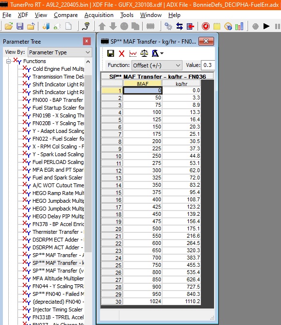

If I set MAF table for Kg/Hr incrementally from 1-29 (zero will be zero still) so basically it increments but wouldn't really put any amount of fuel in.... Would this be a safe/effective way to crank the engine over and purge the fuel in the cylinders from it being flooded?

Once the conversion takes place, this is how my MAF table ended up w/ the incremental 1-29 but still valid:
0 0.0
50 0.9
75 1.8
100 3.2
125 4.1
150 5.0
175 5.9
200 6.8
225 8.2
250 9.1
275 10.0
300 10.9
325 11.8
350 13.2
375 14.1
400 15.0
425 15.9
450 16.8
475 18.2
500 19.1
525 20.0
550 20.9
575 21.8
600 23.2
650 24.1
700 25.0
750 25.9
800 26.8
900 28.2
1023 29.1

no need
simply hold the pedal to the floor while cranking and it shuts off the injectors
and btw you dont have to change all the maf points just the second from the top
change 900 in your example to 0. then set the flows for that and the one above stupid low like you want.
example
1023 30
0 20
850 xxxxx unchanged and unused
btw you show your values inverted.
Also my crank pw code in gufx shuts the injectors off during excessive cranking regardless.
example
1023 30
0 20

I'll give the pedal a shot! And gotcha on the MAF, where clipping to 0 somewhere along the MAF curve I gather causes "that fault"? Somewhere I think you said/replied w/ EEC-IV it's forgiving in having a bad MAF table w/ a huge drop that breaks the curve (paraphrasing all this) like what you're suggesting to do, and it will run up to basically 900 and fault out but not fail. Later style ECMs, I think you (or whoever wrote this) said EEC-V was included, is less forgiving and won't run/cause much more undesirable results than Iv.
Love the manual hacks the engineers put in there :) I did see the PW crank code you have while paroozing and realized that's why it slows down/dies off vs. something else actually dying. Def thought my battery and/or starter was just dying at first but I could always restart and and it'd act normal till it dies off then rinse/repeat. It was clearly code ;) Thank you for adding that too btw!
Invert the table.... I've always wondered about my tables and the inversion... So lots of other MAF tables show highest/lowest like you suggest vs. lowest/highest like I have but some do too. Even EEC Analyzer and I'm sure Binary Editor show as highest/lowest.... I even wrote a conversion in my fuel spreadsheet to invert it when I needed to transfer it to say EA...
The reason my table is inverted is because that's how the MAF table shows in the A9L2_220405.bin file which is where I started. I just assumed you had it low to high for good reason in the base BIN, so I just stuck with that since day one and it's been 1,000s of adjustments since... Never had a reason to question/ask about it.... But aight I flipped it and I see even the graph displays correctly :) I'll test it tomorrow/this weekend.
Thank You!
Thank You!

I have no idea what your trying to describe about the maf but the ecu uses the top point for lookup and works down. Its the same for eec 5 as it is eec 4.
1023 23
0 20 <--- zero ends the maf curve
below no longer exists and is no longer part of the maf curve regardless of what you put in there.
900 1600
850 1400
800 ....
the above is a valid and non corrupt maf transfer.
You cant have any lower x axis value higher than the above value or it will corrupt. But 0 ends the maf transfer.
ex:
1023 23
1 20
900 1600 << will corrupt the maf.
remember all x axis need to be maximum to minimum values in chronological order for all functions otherwise youll corrupt it.
No, the reason why your maf is inverted is because you didnt setup tunerpro correctly per the getting started write up.
1023 23
900 1600
850 1400
800 ....
ex:
1023 23
1 20

Thank you Decipha and yeah that's what I was tryin to explain, but didn't do a great job ;)
And yes clearly I missed the reverse row but I see that's just a visual/display thing so I gather it wasn't really an issue but if I flip my MAF as is that probably won't go so well ;) I actually like the low to high view cuz I don't have to resize the History/Monitor/Dashboard/Comments window as far down :D

I did flip the table after reading the response initially and it does map correctly :D Haven't ran it like that but was curious. Got it all working and the purge fuel BIN I made works nicely. Because I really can't get the pedal down to over 900 TP I don't think I can initiate that clear command anyways so the MAF table is the best way to go in my case. The carpet limits the last bit of travel and I'm not fixing that any time soon...
So the cause of my flooding I believe was setting the Default Desired RPM and a couple other RPM settings to 688. It ran great all summer and even winter like that but I'm thinkin when I have my bad start and I flood it, the limit I'm setting on the RPMs (the original values were higher than 688) restricts it from turning over and further floods it. It's worse when it's extremely cold out but as said I've only had this situation a few times now but it's a nightmare gettin it restarted after. I restored it back to 1200 RPMs and the others to 725/whatever and it fires up NP and still idles around "688" anyways. It varies of course but w/ the MAF table good it idles proper and I see when it's cold it'll startup closer to 1200 then calm down vs. when I had it set to 688, that's pretty much where it always ran at.
