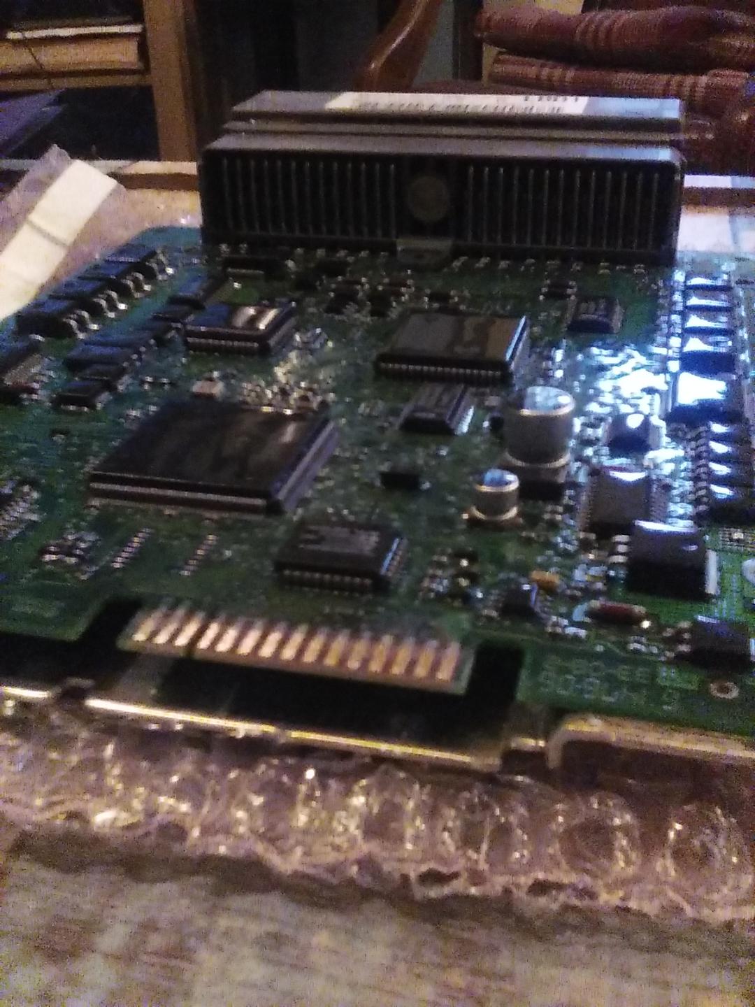

Here is the question. I have removed the newest style case cover of the EEC-V units. It has folding tabs. I've cleaned the J-3 contacts on the side that they are easy to get to.
I removed the 4 torx screws that hold the board to the aluminum back board. It appears that it is glued to the backboard. I'm trying to handle it with kid gloves. I don't want to use any flat blade (tip) screw drivers or razor blades to do this. Should it come a loose or do you just reach up in the hard to get to area with an emery board and attempt to clean the contacts. I don't have a junk 2003 PCM to experiment with to see what it would take to release the pc board from the aluminum plate that it is glued to. Thanks in advance for the guidance. ADDED 15 minutes later: The contacts are hardly visible to be able to reach up in there between the plate and the pc board.

No need to remove the cover just simply use dykes and cut the opening at the sides and fold it in up top for the qh to fit in.
Use an open end razor blade and scrape the plastic off. You can get both sides without taking the cover off.
Re: TunerPro RT w Moates QuarterHorse bench read
Thanks, Michael, for the guidance. In the tight spot I was able to use a dull Exacto blade to scrape the plastic and then a wore out Emory board to finish cleaning. I'm making sure not to get carried away and go to deep and get into the printed circuit.
