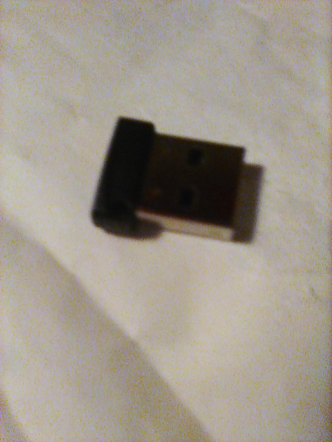

I guess that it what this little piece is called that plugs into the USB port on the laptop. I recently ordered module #29 from ECU Tools. I paid for the one module plus shipping. This question is for Michael or anyone else that knows the answer. I have the USB security key dongle. What do I do with it? Where does the # 29 module come from? a download? something sent to me in an e-mail? Do I now let Oleg know that the key arrived?

you download pcmflash and your good to go

It has been a while since I got mine but from memory, you download pcm flash and there was a registration or activation process in which you send in something like a device code and they send a response code back which activates the software. Sorry I am probably butchering the details. It has been a long time.
I have a dedicated laptop for tuning. I put a tiny dab of super glue on the dongle to make sure the dongle doesn't fall out while moving around and bumping into things. The software is registered to that dongle so if you loose it you will have to buy again.

I've completed the task of copying the dongle info and emailing it back as a txt file. I'm waiting on something back. Is that when I receive module #29 or do I already have it in an older email? I need to look back through my email.

It gets activated from the response file they send you back. I think you had to send a couple files back and forth. It has been a while , I may be remembering this wrong.

@mechanicalmatch I believe that you are correct on the back and forth a couple of times. I have a computer literate friend that has been helping too with the back and forth. He is good at interpreting the directions. I appreciate both of your help as I step into the unknown.

I got it with a handful of modules on it and it was good to go soon as i plugged it in. Mine came from oleg though. I think these days the dongles are shipping from elsewhere and you have to update it for the modules you order. In that case open pcmflash and send the hardware code to ecutools they will send u an update code and you should be good to go.
