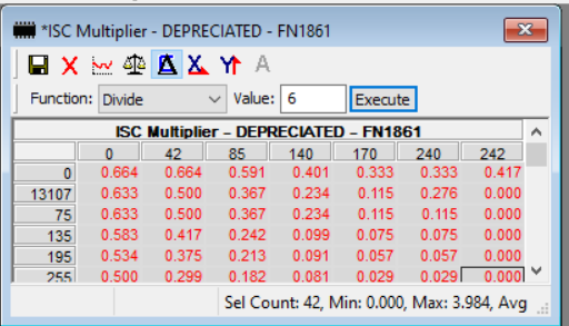

This is a screenshot of 1861 from A9L2
The idle air writeup says to divide all the cells by 6. That would be:
Which one should I use?

its already done

So, use the A9L2 version without dividing by 6?

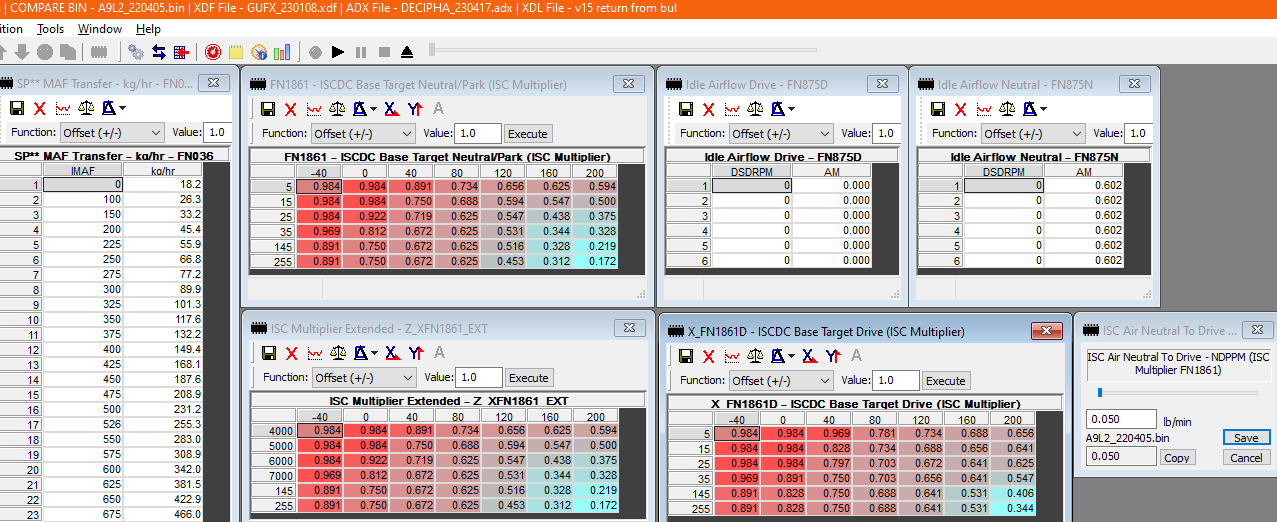

Here's a screen shot of the main functions mentioned in the Idle Air doc which are idle. Does yours look the same?
The FN875 ones seem like they should have values in DSDRPM as the doc implies . Per the doc the AM column for FN875N needs to all be changed to 0.602 (realized TunerPro / Strategy altered it to 0.602 after setting it to just 0.6 per dox but I see that's normal behavior to round up/down to nearest... voltage?) despite no value in DSDRPM. The FN875D (Drive) doesn't contain any data, just 0s.
That's where I think you and I are both getting lost/confused. Sound about right?

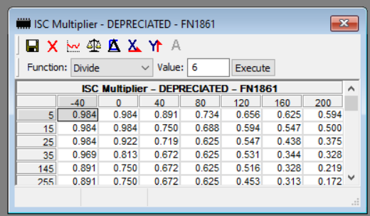

where the table reads .172 at 200 degrees engine temp. ( The first pic in this thread. ) That's a set, looks right to me.

Thank You Red :) I know he carved a lot out for us to make things easier and he's done an amazing job in every respects :) So for the FN875N and FN785D, still leave those as is in the screen shot now too?
- Posts: 197
Re: Mechanical idle - 1861
Hmmm. FN875N and Fn875D D is for drive on autos trans so I'm not sure since i'm on a stick shift car. He may not use it. I think on the write up he said make 875N and 875D match and tune D if needed.
