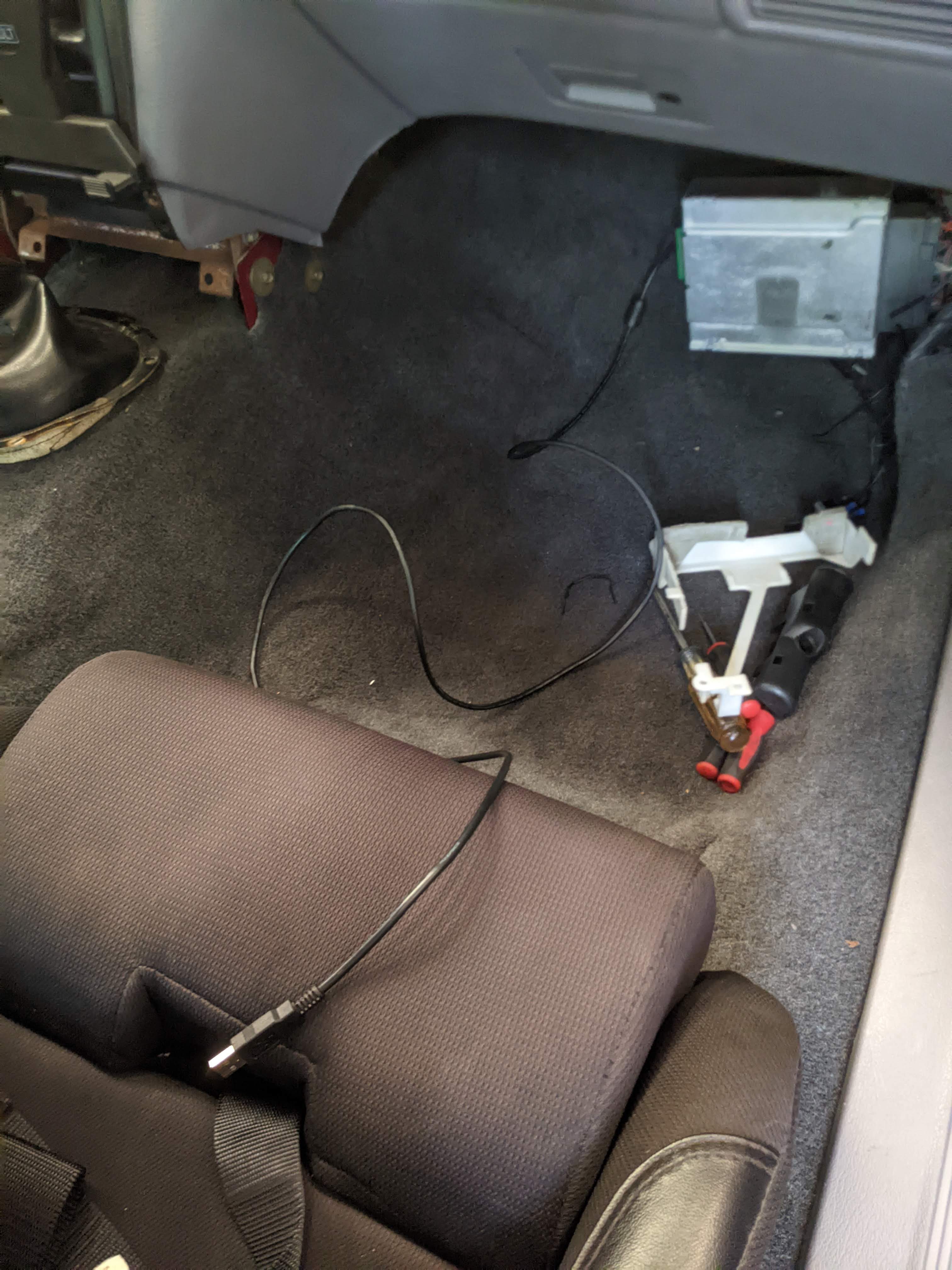

On my setup I routed the usb cable nicely under the glove box zip tied to the metal under dash. That caused an issue for my setup. So I went back to it laying on the floormat. My point is try changing the route of the usb cable if you have not already.

USB cable is just sitting on floorboard at the moment.
