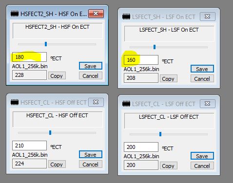

Is there a reason both the low and high speed fan off temps are higher than the on temps?
- Posts: 6953
Re: Couple questions
8x10
someone probably did that to either be lazy or remove the hysteresis
