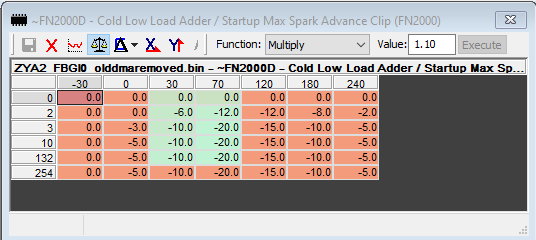

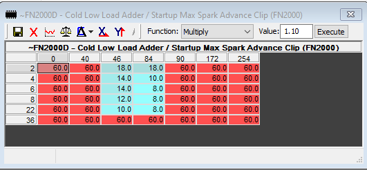

I noticed on the ZYA2 and stock Mach bin you posted that there are several differences. Fn2000D really stood out to me. Which bin is correct? Theres a huge difference in timing thats being added or pulled between the two.

both
thats a cold spark clip. read the comments

I read the comments. The comments are the same in both bins but the timing thats being pulled in the mach tune compared to the timing thats being added in the ZYA2 are drastically different. Thats why i was asking.
