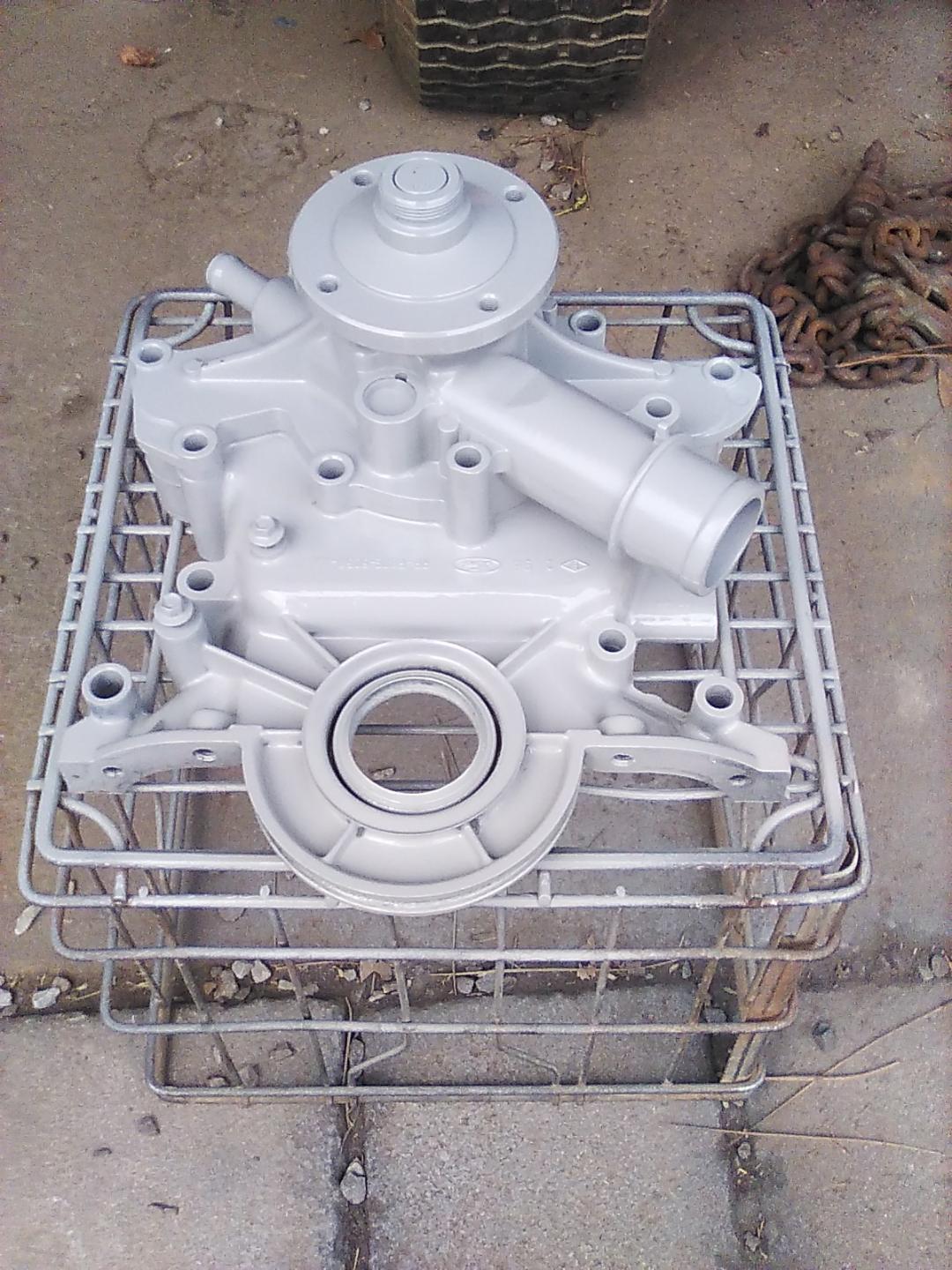

Original timing chain/gear set cover and new water pump cleaned & painted light gray sitting ready except for installing crankshaft seal.
