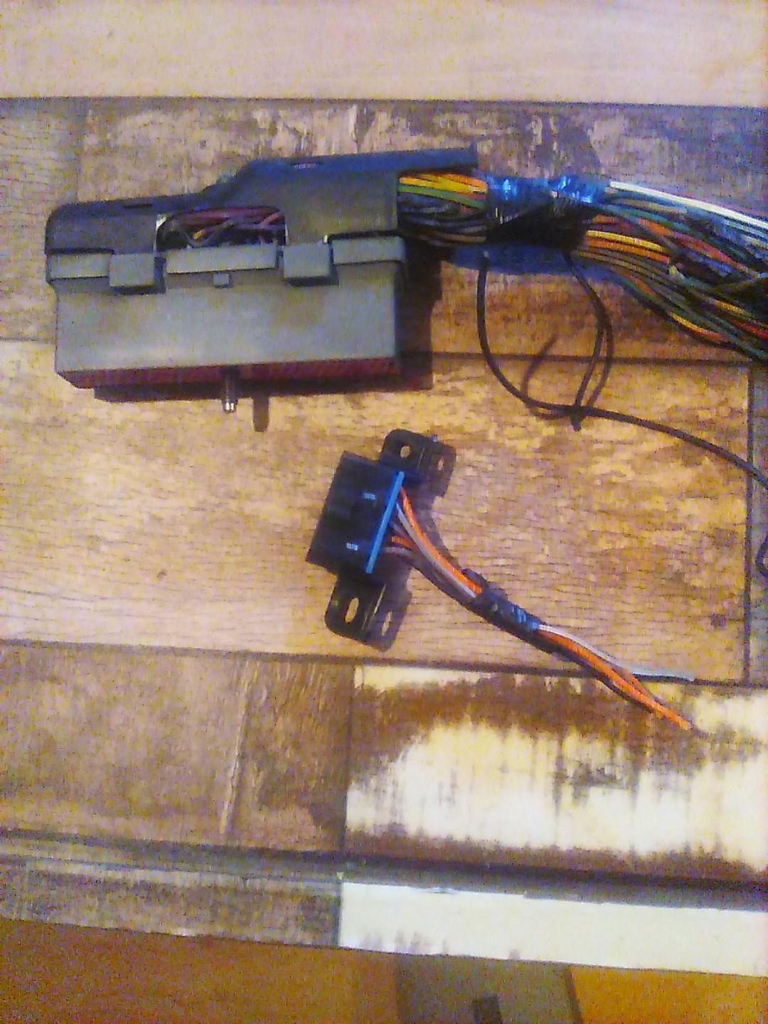

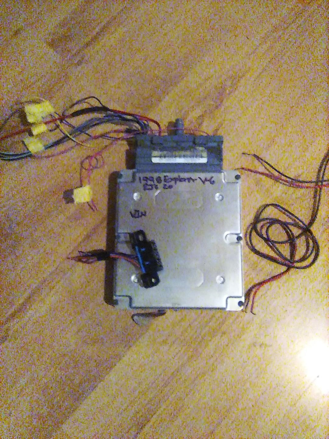

3 weeks ago, I purchased a junk yard 1998 explorer PCM and connector and data link connector for $20-, to make a bench harness to connect the PCM to the laptop via a pass thru device. Also the cheap PCM is to experiment with. Pic of PCM at bottom. I can't figure out how to rearrange pictures. I also purchased a nearly new laptop, a Dell with Windows 10 pro and an equipment case for this endeavor. I also purchased an inexpensive vLinker to connect to a vehicle to read the DTCs. I know that this is nothing more than a device to do such, but it is something that I should know how to do. The next piece that I need to access the PCM is some sort of pass thru device. I see Michael recommends a Mongoose however I haven't found a cheaper but equal device. Also, there is the J3 port way to access the EEC and it appears to me that it used to be the only way as it relates to EEC-IV OBD1 and involves a Quarter Horse however I'm not going to be doing anything OBD1 and the Moates people recently retired. So that points me towards the J2534 way of accessing. I saw where Cougar281 asked a question about this. Now I can't afford a FoMoCo Rotundra device which is a very nice tool but costs over $1000- dollars. This method of access would be good for me because it would allow me to flash program IDS updates, turn off PATS and a couple of other maintenance functions. It again seems like another logical step forward. Here is a link and picture to a J2534 knock off device. Has anyone used this particular one with success? It's not very expensive and if anyone and particularly Michael P. thinks it will work, It come with software for itself I presume. I can even ship it to him to try out before I try to use it. I'm not much of a PC guy so this does not help. It is a challenge for me to convert a picture from one format to another.
