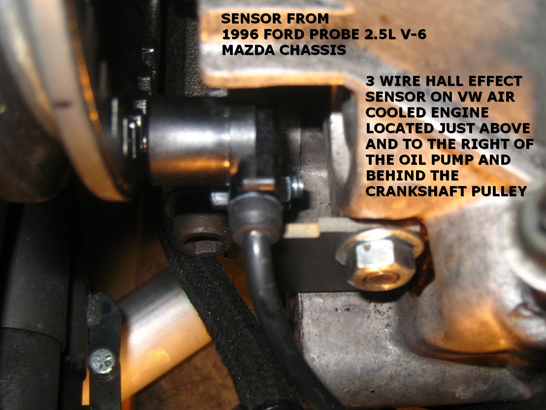

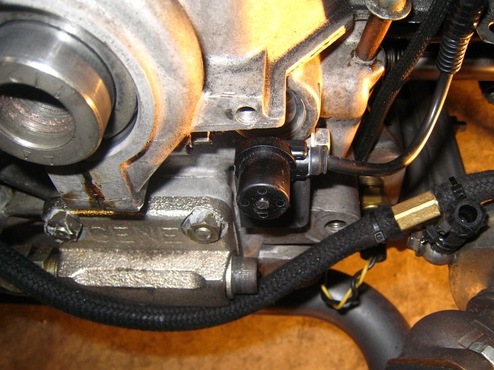

Regarding crankshaft and cam position sensors. From additional reading and listening to some Haltech videos about triggers, it appears that the Fords used a 2 wire 'reluctor' sensor and I am not sure if the cam position sensor is or was a Hall effect or a reluctor sensor.
What triggering signal types does the EEC-V accept?

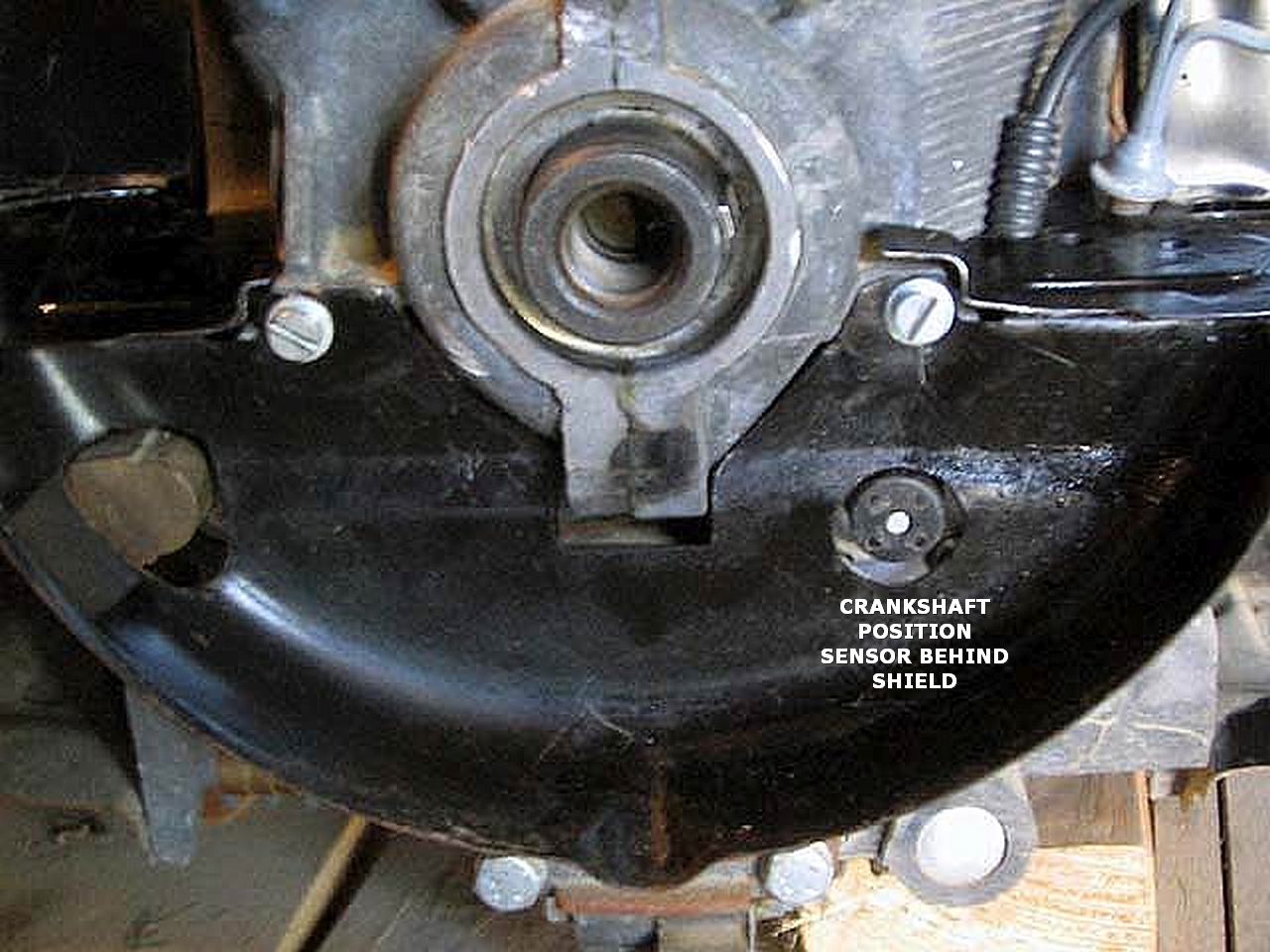

I could include a picture of the crank sensor location but I don't see any way to attach a picture. Any how it is not located in an air stream created by the pulley or the generator/alternator drive belt.
I understand too that the 2 wire sensors do not create as clean a wave form like the Hall Effect sensors produce, but the reluctor sensors will operate successfully at much higher temperatures. The sensor position for the crankshaft position sensor is located low on the right hand side just behind the lower cover for the crankshaft pulley. Will the Ford EEC-IV computer be able to use a Hall Effect output for either the crankshaft or cam shaft position sensors? If not I will have to find a sensor that fits the physical location as well as the proper signal for the particular sensor that was originally used.What triggering signal types does the EEC-V accept?

Yes Ford use a VR sensor for crank position. For the cam position, some strategies can be set for hall or vr but the signal is different so the EEC hardware would need to suit.
You need setup the crank sensor, cam sensor, ignition module and EEC the same as the donor.

The crank position sensor I showed in a previous post was also used on the 4 cylinder 1.9L Escort engines. I was planning on using identical sensors to those used on the Ford Escort 1.9L engine. For the cam position sensor I was going to use the same type as used on the Escort engine but set it up in a new VW style distributor body I found on Amazon for $30. This way I don't need to destroy a good original distributor that was designed to be used with a vacuum advance. I found some pictures of the position tooth that is made with the camshaft and it would not be difficult to make one from steel or iron. I have also considered purchasing a distributor trigger wheel (iron reluctor wheel) for another vehicle and modifying it to work with the distributor shaft, while removing all the extra teeth. There are aftermarket devices setup with a single tooth wheel that use the same dimensions as the VW distributor with a single shaft in the body with the trigger device and sensor already mounted. The only supplier I found that is or was making one for the EEC-IV ignition module is no longer making that type due to a lack of the proper sensor on the market. That supplier was CB Performance. I got the crankshaft position pulley and wheel from them and they also supplied me with the compatible cam sensor information is case the supplied sensor fails. I found the identical sensor on Amazon for $10 versus $40 from CB Performance.
