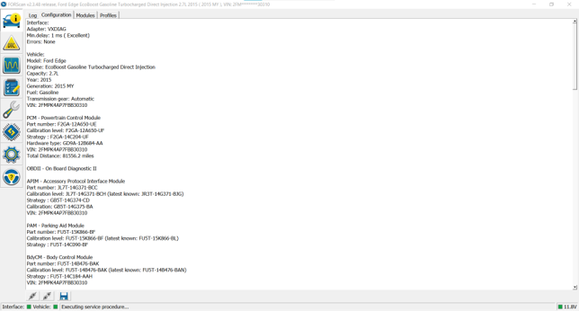

New to diy tuning here! got my interface, just trying to figure out how to pull the bin and then find a definitions file for fortunerpro. Or is there a base tune file out there that I can use as a starting point and then just flash that?
Thanks!

what interface do you have?

You are not going to be able to pull the bin using vxdiag and forscan. I know some people like them, but I would not trust a vxdiag product to read and write to an ecm. Most vxdiag devices try to act like some other type of diagnostic interface. I own the blue and black vxdiag interface. Very glitchy doing the job it is designed for (gm stuff)
Depending on what you are trying to do, you may have an easier time with a commercial product such as HP tuners or SCT. I haven't used SCT in about 15 yrs and that was on eec v stuff. I am a current user of HP tuners product. The learning curve is not as steep as it would be for you to figure out the diy method.
For example
-buy interface/software combo
-license the PCM you are wanting to calibrate
-read, make changes, and write!
With diy stuff
-obtain the software to read write your PCM
-obtain compatible hardware to read write your PCM that is compatible with the software you are using
-figure out if there is a definition file (xdf) publically available for your strategy and obtain
-figure out if definition file is complete enough to make the necessary changes to your strategy. (This is also an issue with commercial products)
-then read, make changes and write. (Hopefully the software you have corrects the checksum)
Maybe someone else can chime in and give an opinion on current sct products that would be compatible with your vehicle.
None the less welcome to the world of "tuning" and good luck with your project.

forscan is incapable of custom tuning or accessing any tune parametera to edit Thats far beyond the capabilities of its current coding the software would basically need to be rewritten.
