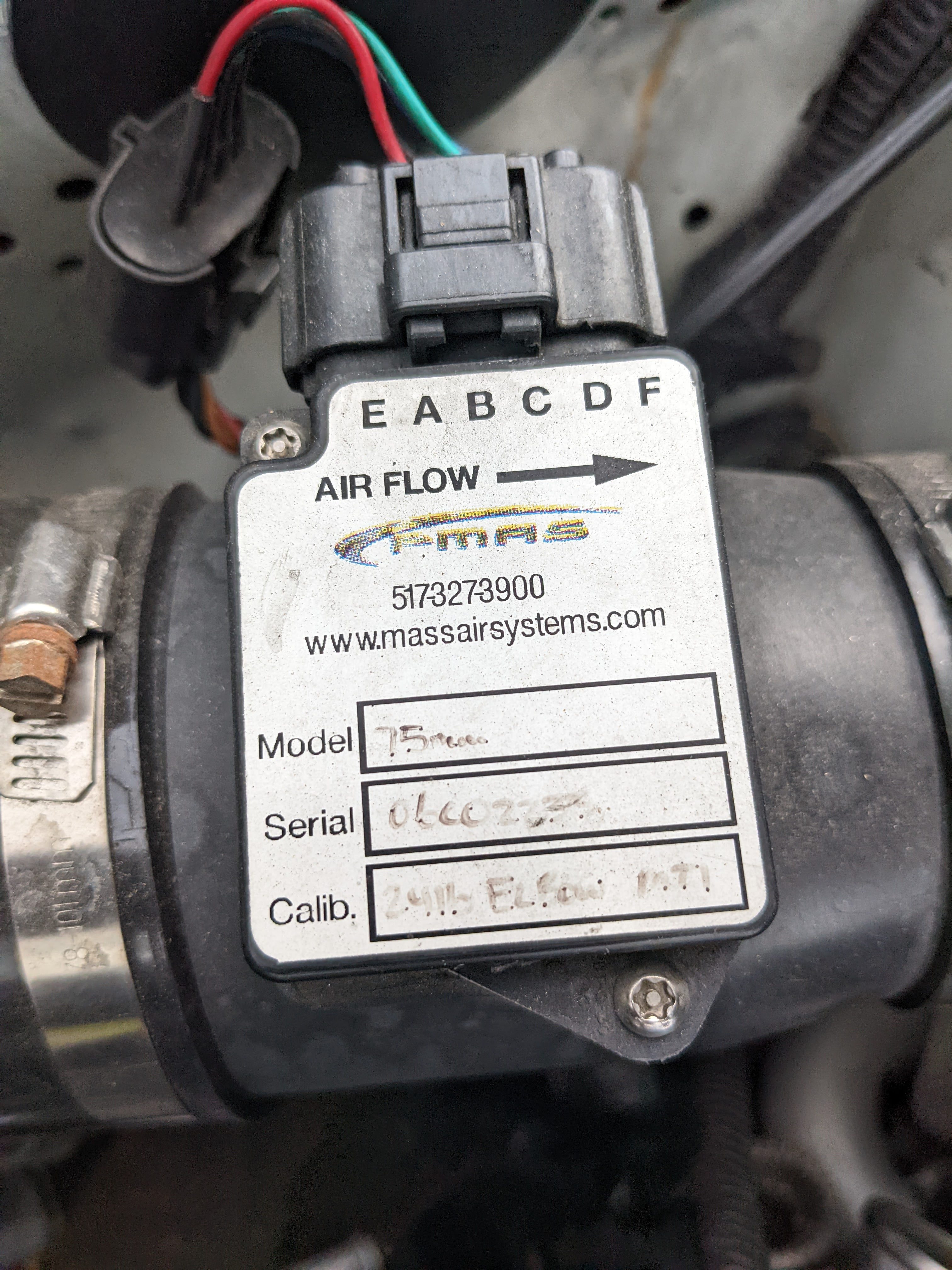

It's a little older, I don't see it on the website. I'm not sure if this photo will show up or not.dleach1407 wrote: ↑2022 May 17, 16:57 https://www.pmas-maf.com/transfer-function/
If it's a newer style sensor it should be clearly labeled which sensor it is. If it's an early one its harder to identify. The outage listed above should help you identify which you have. Both of mine are 10 years old and still going strong. They are the first generation sensor.
- Posts: 471
Re: Not enough MAF Points?
That is not a slot maf, thats an old school "tonsil" style maf. You should be able to use a stock maf curve and just multiply the whole curve by .90, maybe .85 to get it close since its calibrated for 24s. Youre going to have to dial it in regardless.
