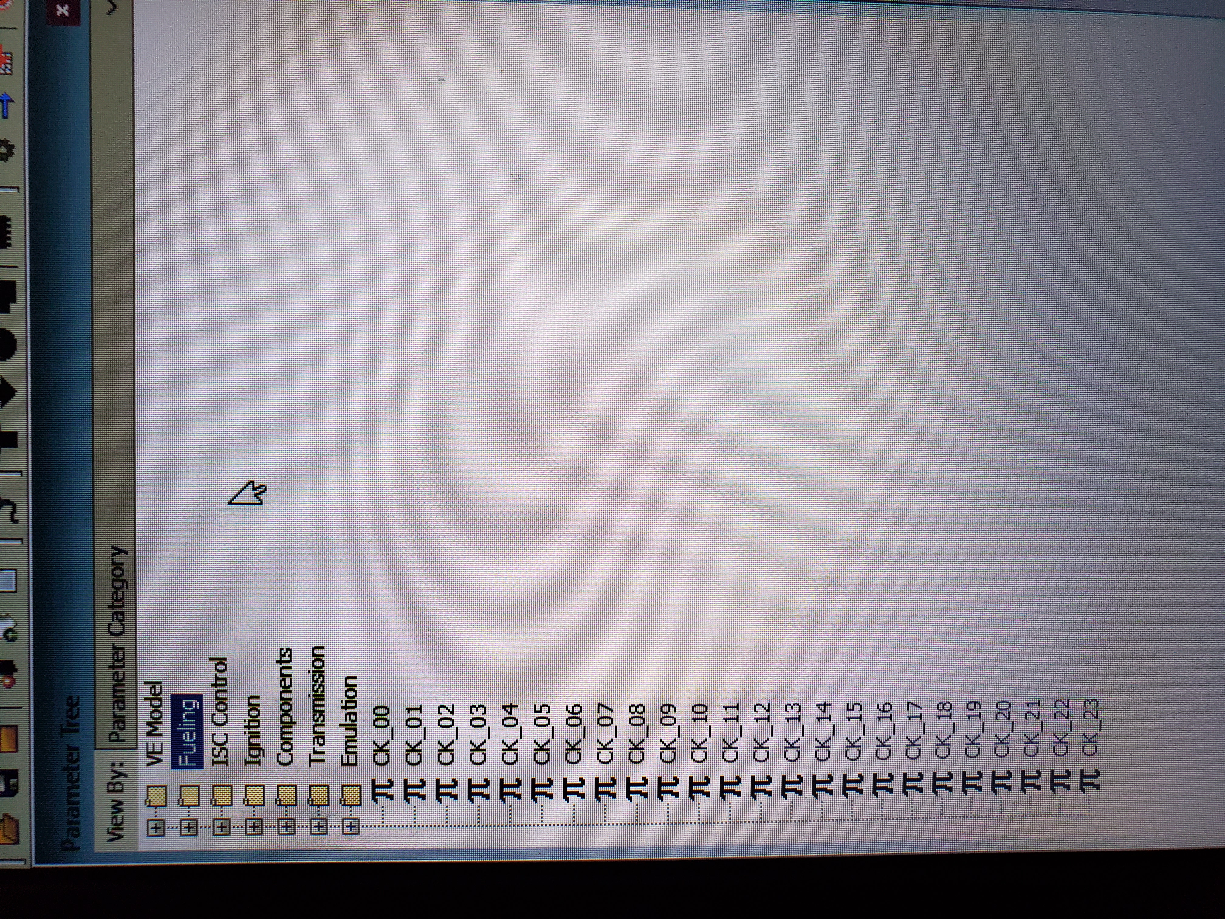

Hey guys I have a 5.0 ranger I've been trying to get running for a while now. I'm having troubles getting the base tune calibration all set up. First of all tuner pro has a different layout than the picture posted in the calibrations write up, (ill try to attach a photo if I can) and that's been quite difficult in itself as I am very new to this. I have no "Tuning/Engine/Configuration" drop down. despite that I've got the stock map from the ECU uploaded and have a majority of the base calibrations dialed in.
I'm stuck on a couple things. First, the Fuel pump voltage. where can I find this information? as well as axel ratios I and F, what do I do here? is there something I can reference for these tables?
I tried to figure out the Crank PW with no success. There's multiple options in the dropdown for fueling> cranking, labeled with crank PW in the header but I'm not sure what I need to adjust. Maybe I'm overlooking something?

Re: Tune configuration help (5.0 Ranger)
http://www.efidynotuning.com/started.htm#calibration
There is no pump voltage since the explorers use a return style fuel system just like the 98 and older stangs and the 11-17 stangs do. Its jut a simple on/off.
if you hold down control and press F you can bring up the find box. Type in crank pw and press enter and the cranking pw parameters will pop up.
double click a parameter to open it and Press f10 to read the comments. EVERYTHING is fully documented out in the comments.
You apparently missed the fuel write up too on the homepage as cranking fuel is specifically covered there as well.
