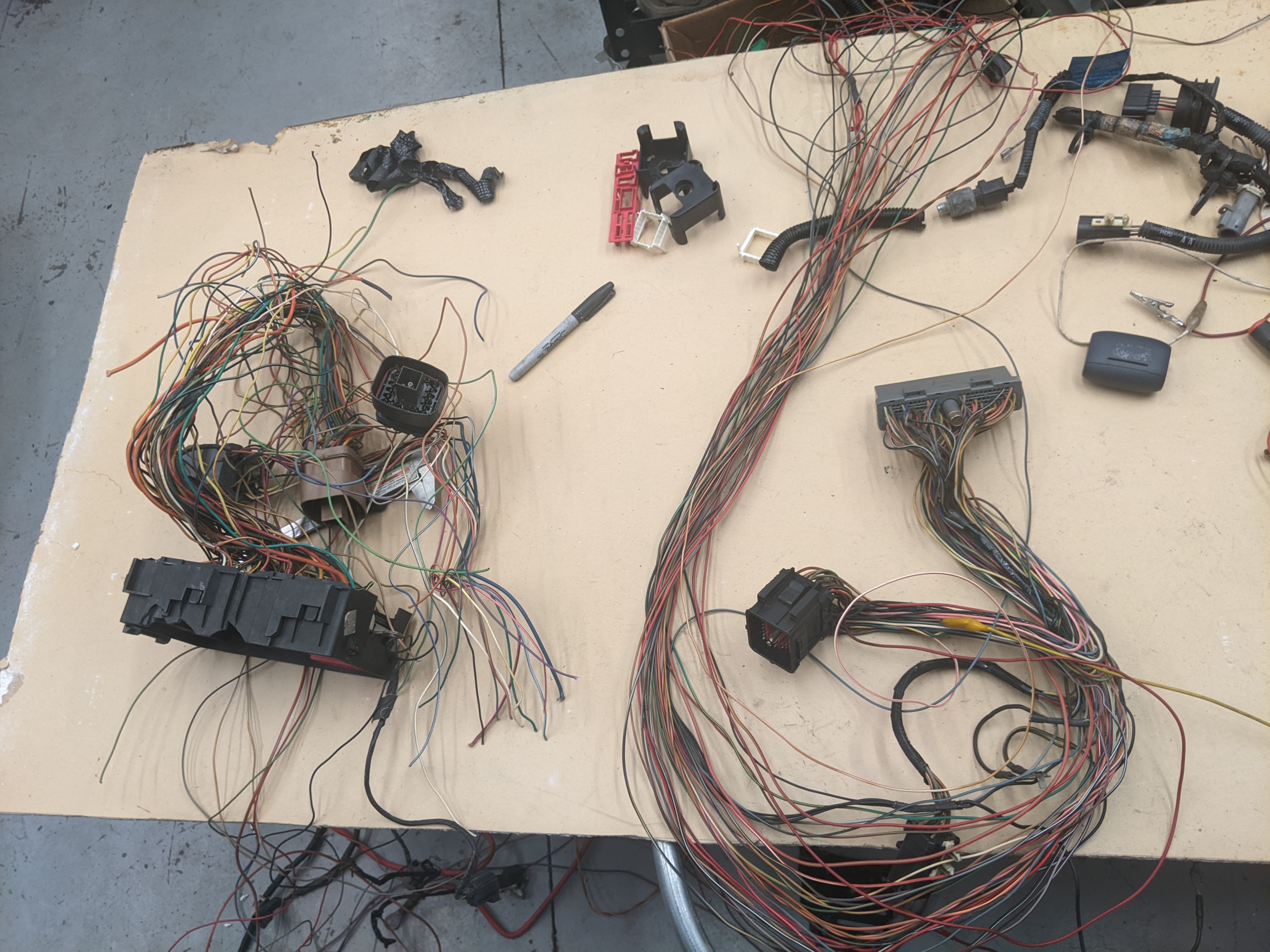

Before doing any cutting or splicing, I need to map out each harness. I'm doing this by creating a spreadsheet with each connector on the harness and using a multimeter finding continuity from pin to pin. It's very tedious, but I want to know what every wire does. That way I have a good plan going forward and remove connectors I don't need.
Shown below is the passenger fender harness from the SN95 mustang. My plan is basically rebuild this harness with the EECV connector. Most of the mustang specific connections will remain.
Once I know where all the wires go I start cutting the harness apart. Right now I'm not trying to cut any wires but remove them from their connectors. But it becomes quite a mess and can be overwhelming.
But take it one wire at a time and I eventually got the EECV connector separated from the F150 engine bay harness.

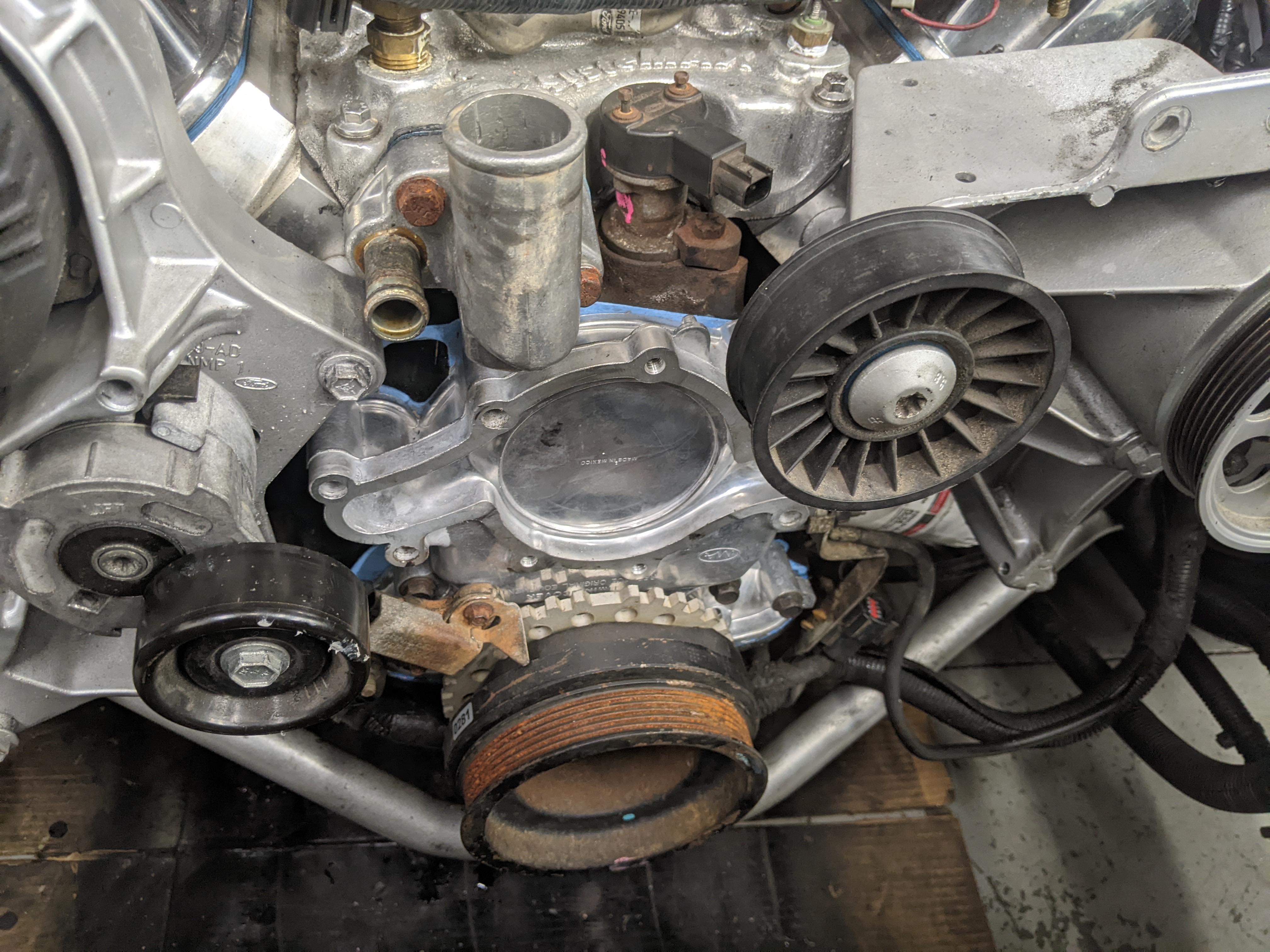

So I turned my attention to hardware changes on the engine. I installed the Explorer timing cover and cam sync sensor. Then test fit the Explorer harmonic balancer. As expected from online research the pulley is too close to the block and out of alignment with the SN95 accessories.
Since the pulley is part of the harmonic balancer it can't be easily spaced out.
Trying to figure out the best course forward for getting a trigger wheel installed onto the car. Then also how/where to install the coil packs.
