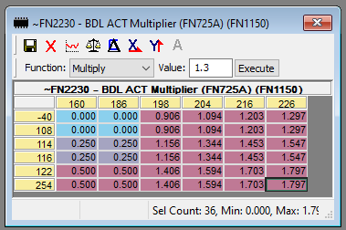

Well I opened a can of worms on this one. Seems like you want higher temps for better efficiency & h2o evaporation but the issue is keeping the intake temps low. This all aluminum intake heat saturates pretty quickly. FN2230 is stock. My primary spark table is the stock MPG table + 6 degrees (removed the +4 from WOT adder). I think this explains the noticeable drop in performance when temps go up.

Re: Lower temp thermostat
that should be all 0.1
you have tunerpro setup wrong

I am running the stock tune and I left most everything stock except what I explained above and Injector slope/VE. This is how ford setup fn2230 for the 4.9 EFI fast burn heads.

I'm not opposed to doing what you mentioned above and in the timing write up, But some of the functions are not listed in the XDF so I assumed speed density is just a different beast.
nah just not in there
