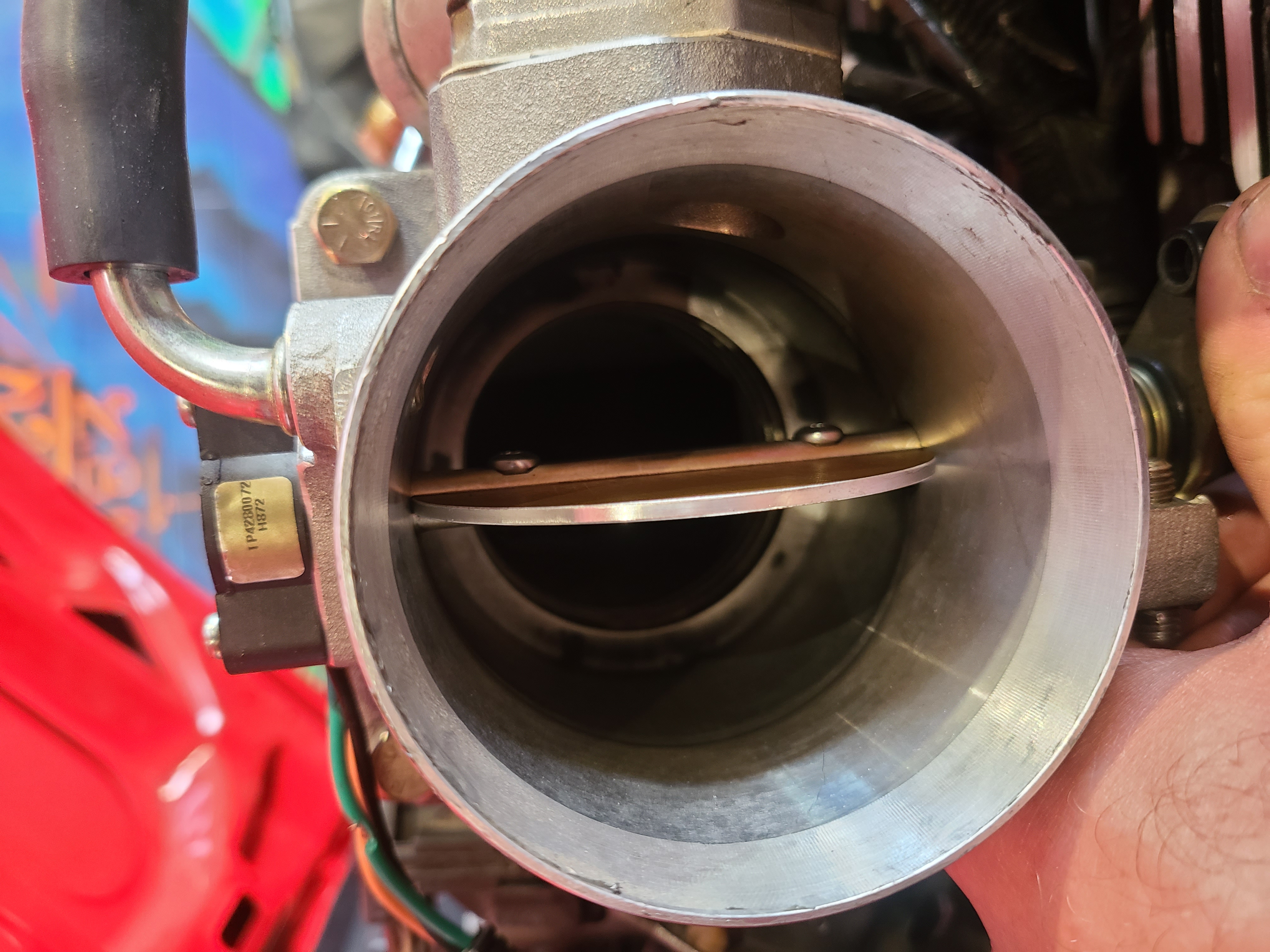

Issue I'm having is its starting and running good but I can't get IPSIBR under 0.70 lbs/min and if I lower the TB set screw approx 1/4-1/2 a turn it will then come down and idle where were commanding but then on a restart its back up to 0.70 ish and then if I open the TB set screw a bit ( engine not running) and re start I can get the numbers down to 0.000 but then its idling to high. Can't seem to find a happy medium within 1/4 turn or so of this set screw.
Smoked the exhaust and intake manifold with no leaks found and all systems seem to be working decent. Any ideas?
x3 logs attached, Warm idle should show commanded being met but IPSIBR is to high
Warm-Idle-2 shows idle screw opened up a bit and the IPSIBR is 0.000 but idle is to high of course
Warm-Idle-3 is with the TB screw turned back down 1/4-1/2 turn and its idling, then I shut it off and restart it and the IPSIBR is back up.

Its doing exactly what you told it to do. You have obliterated the idle air model.
FN875 never requires any adjustment. You raped the isc multiplier and basically have the idle air valve shut off and then commanding more air as the engine gets more stable which is completely backwards.
All the logs are useless as the engine wasn't running long enough to check the throttle stop.
The throttle stop is to set idle air for a stable engine. That means 200+ degree ECT and its been running for at least 255 seconds or 5 minutes.
Everything prior to that is done in the isc multiplier table to get IPSIBR to stay near 0.

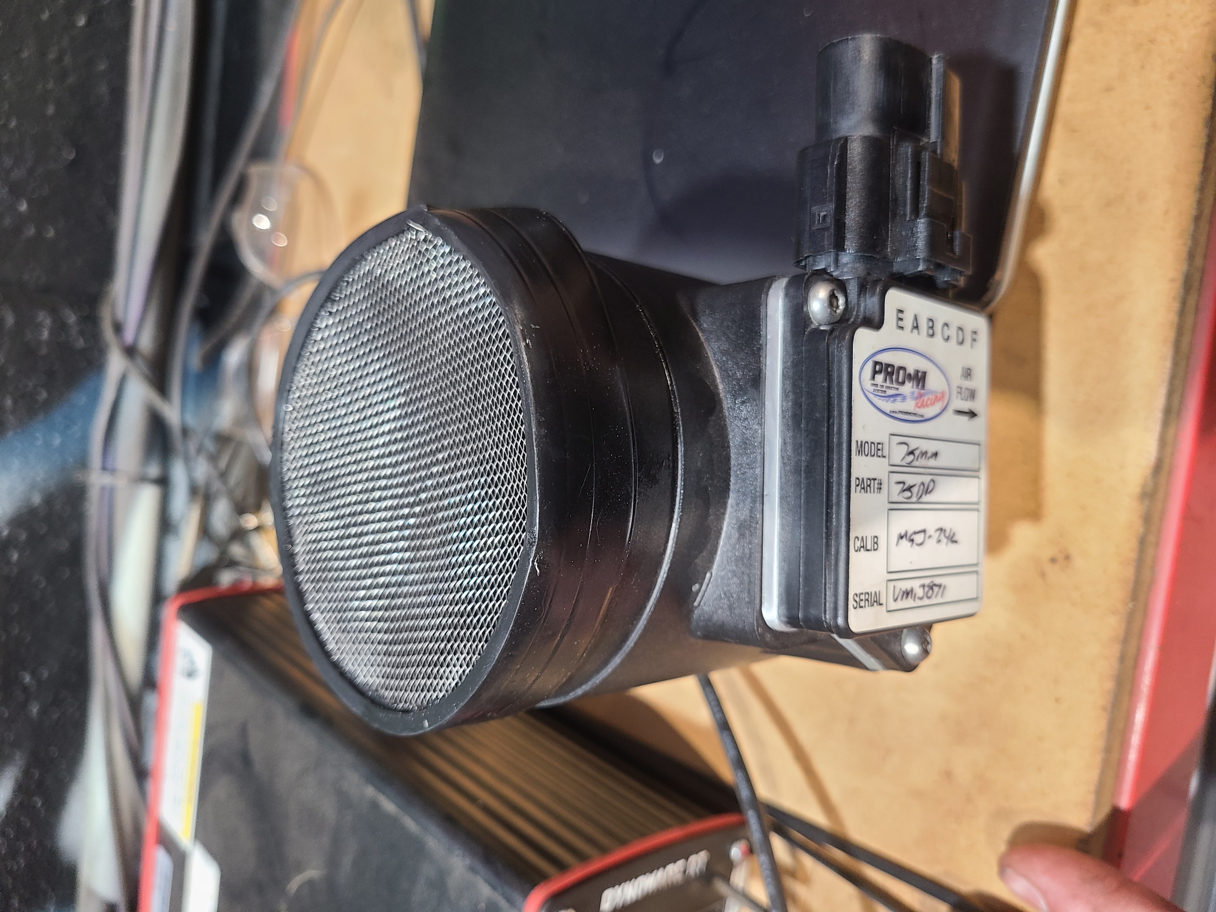

Does the screen material actually help straighten the airflow compared to a honey comb style filter ?
- Posts: 7113
Re: Idle Issue
they both do
