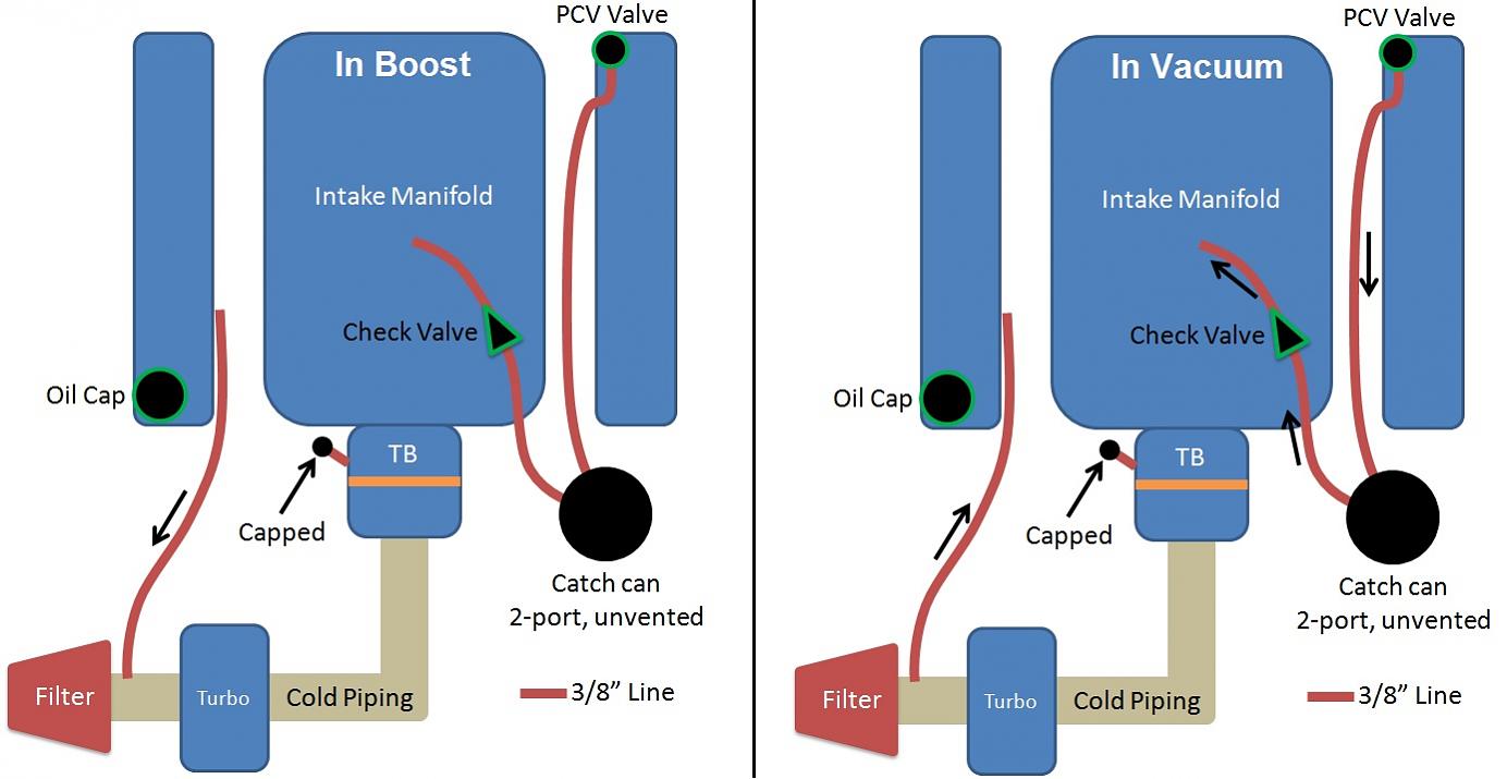

Here's a drawing I came across:

You already have a check valve on the pcv itself. I.e. Use only PCV valves that have internal checks.
You can put a catch can on the inlet if you'd like as well no biggie.
Yes pre-turbo fitting would be on the inlet piping between the turbo and air filter.

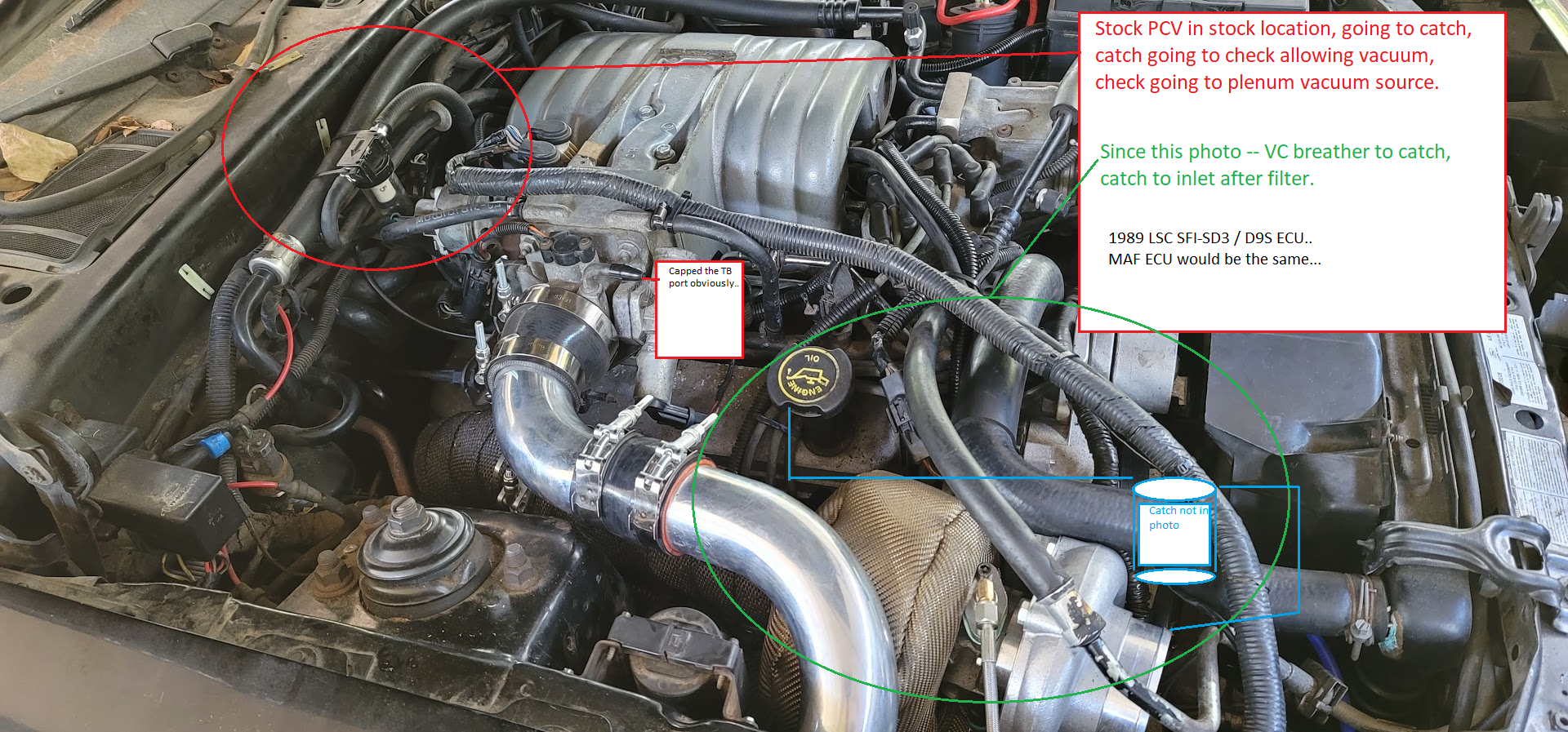

My rigged setup.. works like it should

034v wrote: 2021 May 19, 09:26 My rigged setup.. works like it should
Thanks for the detailed pic. How well does that air compressor separator work at catching oil and moisture?
You're running a check valve between intake and pcv?
034v
Posts: 126
Joined: 2021 Feb 22, 09:00
Location: Denton TX
Vehicle Information: 1996 Lincoln Mark VIII LSC - Custom Turbocharged
Re: PCV with boost
Unread post by 034v »
Fasterthangas wrote: 2021 May 19, 12:55
works good so far. yes running a check downstream of the catch.
