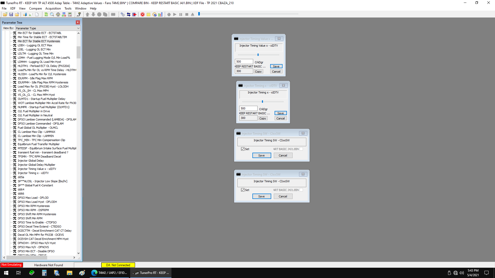

Hello, could someone please give me a brief explanation of what the pictured scalars do in relation to the injector timing table? Thanks
Posts: 6639
Re: Scalar Function
It bypasses the injector timing table and sets injector timing to 500 at idle and in neutral

What happens with the table and injector timing when out of idle, and in drive? Does "Frequency Input Falling Edge" log this?
Posts: 6639
Re: Scalar Function
Those scalars don't get used and the table does instead.

decipha, just to be sure these parameters are dependent on one another, I'd like to ask ... from the attached picture, does changing these two switches to "un-set" cause the other two, 500 degree injector timing values to have no effect? I only want the Injector Timing table and Injection Timing ECT modifier to be used. I'm not currently using 500 degrees in my table.
Posts: 6639
Re: Scalar Function
correct
