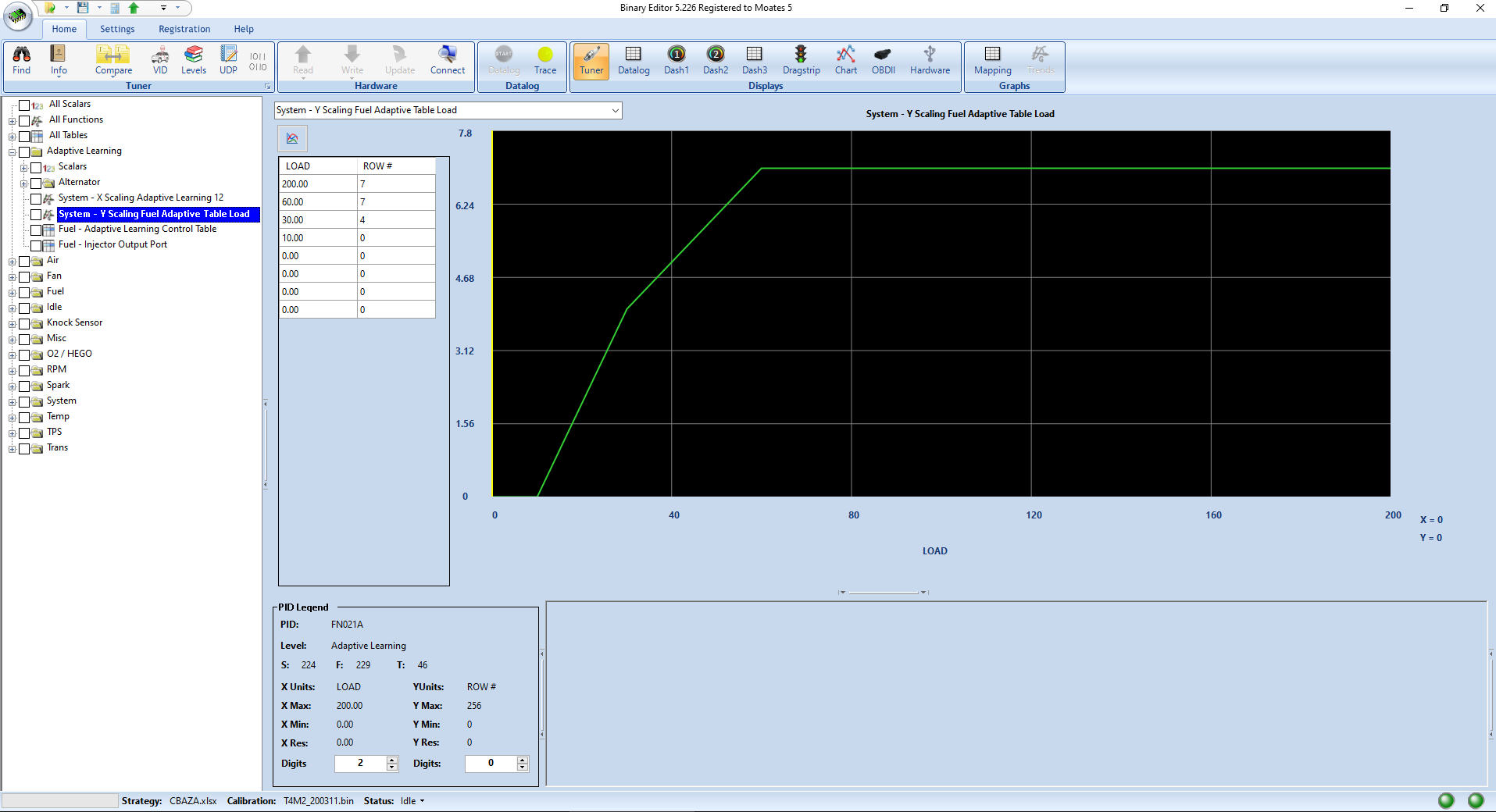

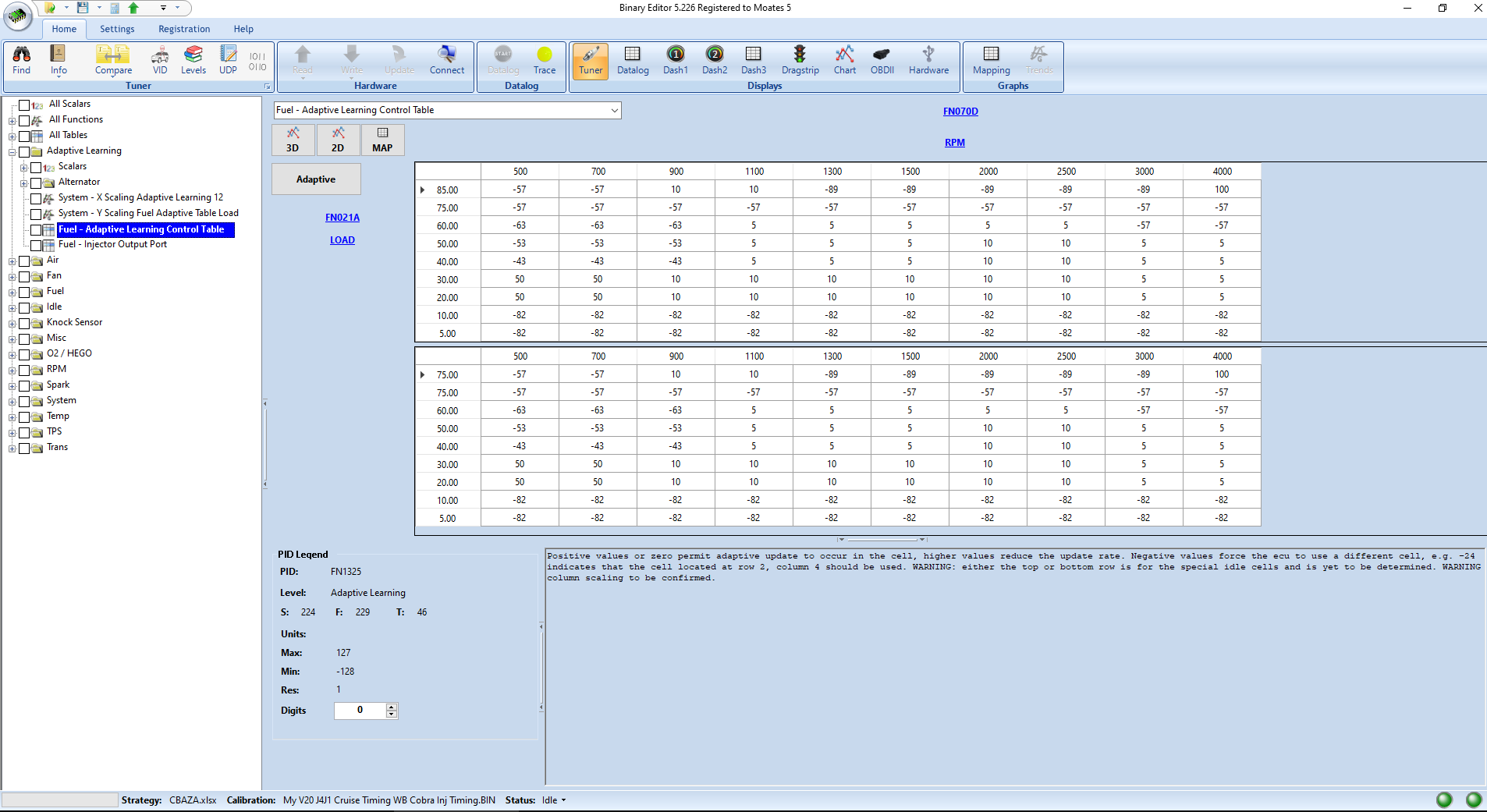

Hi, is there a reason the Y axis in this picture has two identical top entries in the Adaptive Learning table Y axis? I see the table in the T4M2 tune is setup for a lower RPM range and lower load axis values, but it retains the double entry, so I assume there must be a good reason it's there. The Upper table in my picture is modified on the Y axis, lower table is stock.

You corrupted it.
that table is only 8 rows not 9
the top row first 4 cells are the special idle cells
at wot you should be in open loop so theres nothing to learn. So at wot and areas where your in open loop you can reference a cell learned elsewhere that would apply there.
Adaptives should never be turned off they can only improve fueling.

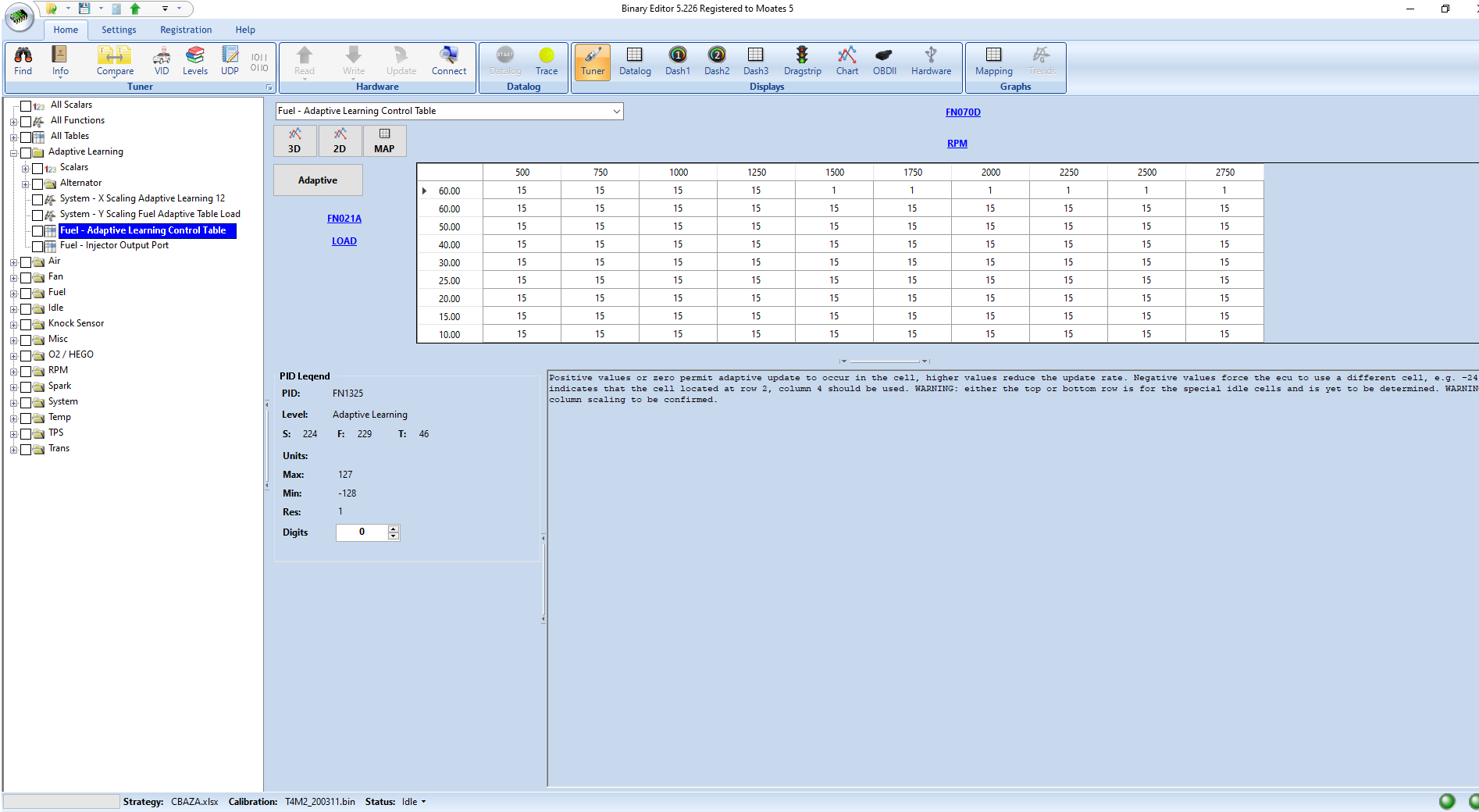

There are 9 visible rows in this table in every CBAZA tune file I have, including the T4M2. Here's a picture of the non edited T4M2 - it has 9 rows with the two top, Y axis load values repeated. Considering your reply, I assume my Y axis, top row, just needs to go back to the 75 load value as it was originally, and the table, cell values will reference the same cells as original, to uncorrupt the table. Forgive me if I am misunderstanding the reasoning behind how this table is arranged. Thanks for the reply.

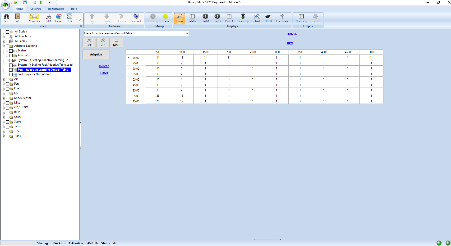

Now that I look at the non modified, T4MO.bin, it gets even more strange with the three, top row, Y axis load values being the same.
