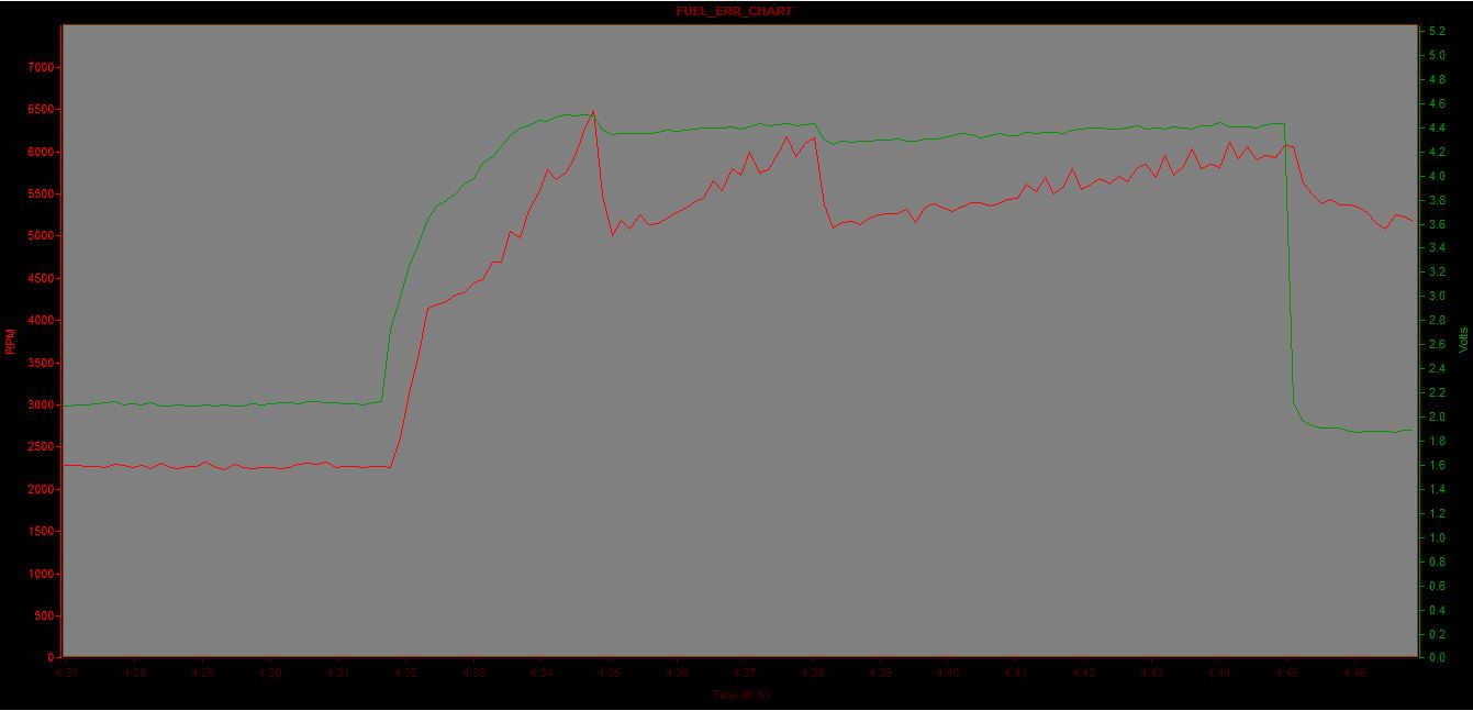

Attached is a pic of how rough RPM is compared to the MAF signal.

Re: Datalogging RPM
graphs do nothing for me im more of a numerical value person
if its not giving you any trouble then i wouldn't be concerned with it. Otherwise you could have some resistance in the wiring.
oh and just because a part is new doesn't mean its working correctly
