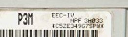

Here is proof it is an EEC-IV 8061:
- Posts: 281
Re: SFR+100 and R+100 8065 memory access
Yes, now you see it.
STB put 0x0064 at address R13A.
R3a,R3b Endian unadjusted has 0x3a,0x3b.
Endian adjusted the value is 0x3b3a.
No word R3b.
- Posts: 281
No its not proof.
8065's in boxes labelled as eec-iv are like weeds.
Suck the code out of it, it is 8065 code.
Pull the lid off it, it is an 8065 inside with 8065 support chip.
U gonna hafta do betta than google pic search
I don't refer to eec-i/v, I say 8061 or 8065 these days.
- Posts: 281
Run the test bins, no need to assume.
No, it is 8065.
P3M hardware is 8065 and the test result show that sf/r+100 did not work on that hardware.
VILE hardware is 8065 and the test result show that sf/r+100 did work on that hardware.
