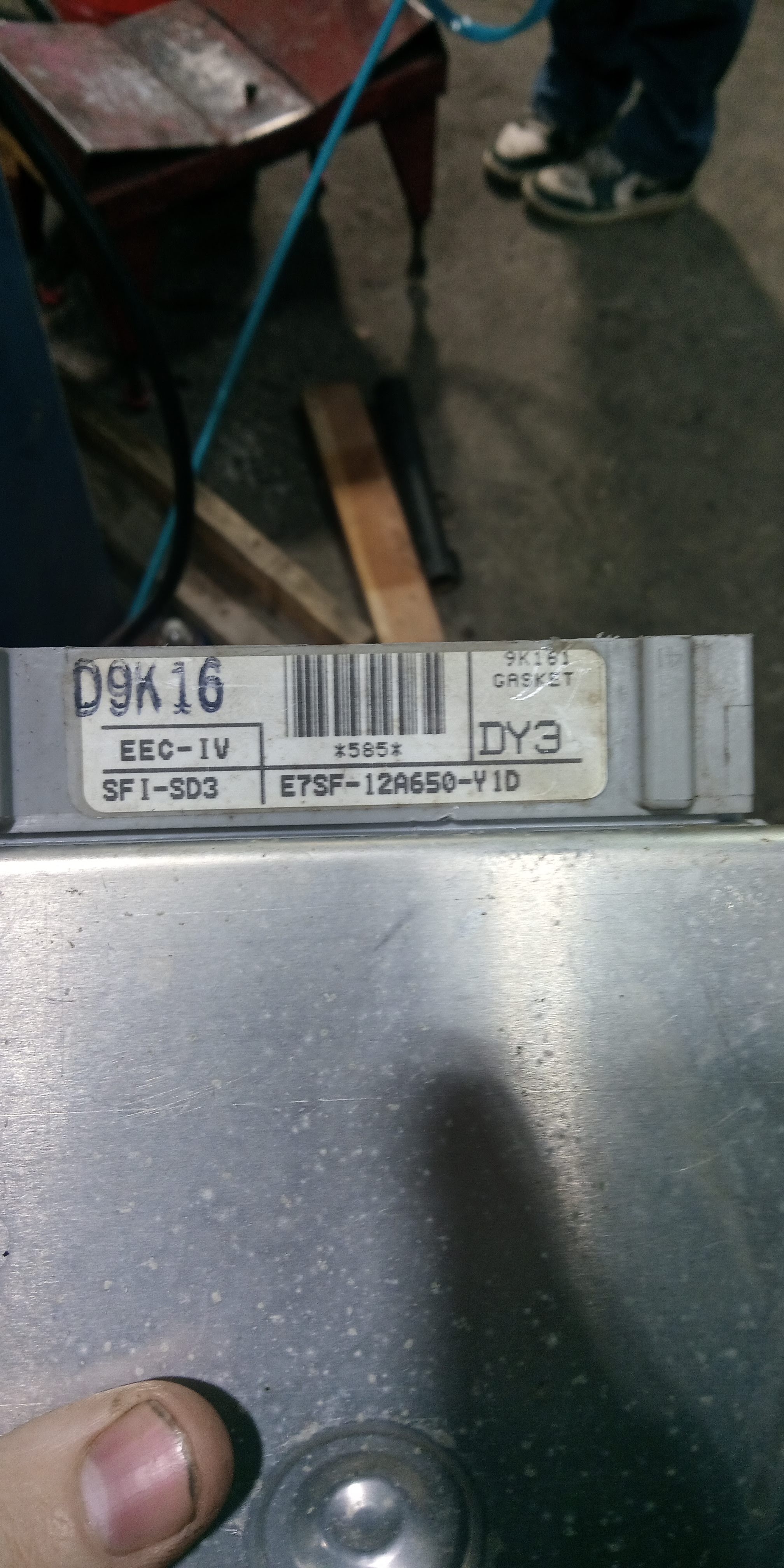

Good morning everyone.
Does anyone know if there is a definition available for an sfi/sd3 eec-ic? I haven't been able to find one listed for it or if a sfi/sd1 definition will work. I have attached a couple pictures that give the eec info.
I should also add that this came out of a 1990 Lincoln MK VII 5.0 and I'm using a quarterhorse with Tunerpro RT.
Thanks for the help.

unlikely
try a1c if that doesn't work then c9c1

Sounds good, I'll try that and post back with results, much appreciated.

Give D9S a shot.
1989 Mark VII LSC
I also have a full XDF.
1989 Mark VII LSC

Hey 034V, do you mind posting or showing where to get that XDF?

It is located in the link.Dashing ZX2 wrote: ↑2025 Dec 18, 22:45 Thanks Decipha, I'll keep that in mind.
https://mark8.site/tuning-store/other-f ... s-xdf.html
It has all listed below

Well, I finally got a crack at trying out those definitions and bins. Took awhile to to get the motor swapped but its running now.
Using A1C it will sputter and try to fire, but it doesn't sound like its trying to fire on all 8, never got it to fire up. I didn't go looking around in it yet if there's some configuration for number of cylinders.
C9C1, fires up, but barely and it won't hold an idle. It generally ran like crap but it did run, sounded like all 8 on this one too.
For some reason the tunerpro dash wasn't giving data, so I couldn't do any live troubleshooting. So, does it seem like these could work with some configuring?

I'm getting around to messing with the C9C1 bin to try to get it to work. I noticed that C9C1 is batch fire since NUMOUT is 2 and INJOUT is 4, but I this engine should be sequential. Would changing these values to reflect a sequential setup work?
Another thing, since C9C1 is for a truck engine, it would be for the flat tappet cam engine and this Lincoln engine is roller like the mustang, so different cam specs. Could it be that it's just running poorly due to different amounts of air getting in the engine so the fuel requirements are different? If so, it should be possible to play with the VE table to get it to run well whether it is batch or sequential. My assumption is that, at least for idle, the VE should be less considering this cam is more aggressive than a flat tappet truck cam.
Last thing for this post, is there a readme file or something for the xdf? When hovering over the different parameters the popup goes away too quickly for me to read much. I'd like to be able to read all those notes easier.

Re: Definition for SFI/SD3
press f10 in tunerpro for the comments
No, all that you said doesn't make any sense.
you can sequential a batch ecu, not enough outputs, doesn't make any difference though
that lincoln ecu is probably going to be a different hardware class altogether. Here's a v8 5.0 c9c1 tune. Change the injector size to 19 from 24 (which it actually has 30s) and give it a go to see if it actually runs correctly and fires all the cylinders, if so just put your actual injector data in and dial in the ve table. You will need to kick up the crank pw by multiplying by 1.57 (30/19).
make sure you have the correct adx loaded in. Did you enable datalogging in your tune file before writing? This file has the datalogging patch already enabled.
enjoy and post back your results
