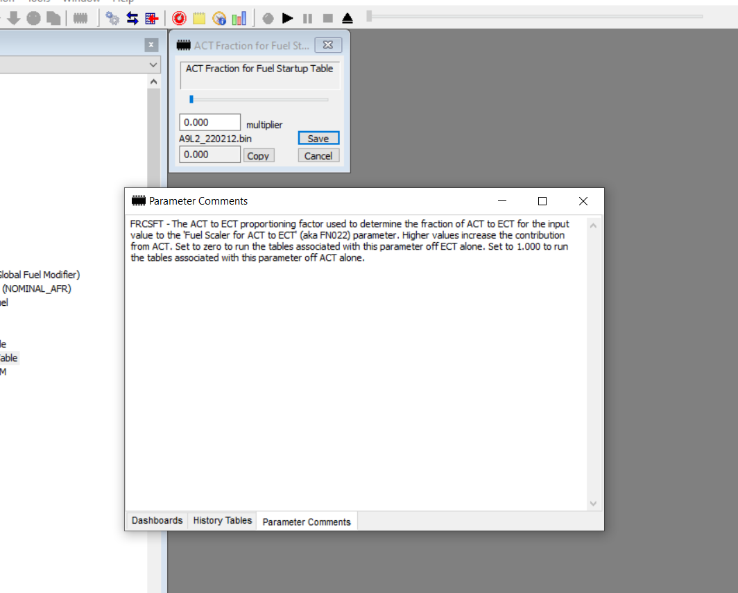

I found this wondering if it could help?
