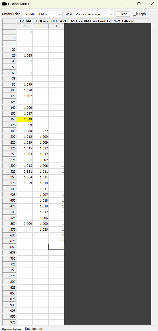

Ok, I'm back ... after doing a whole slew of mechanical work the last several weeks to ensure my exhaust is leak free so that I could get through the tuning process without any question marks about skewed results and the like. So I am back to it, and deep into what I feel is the steep part of this learning curve and trying to understand some results and fueling behaviors to understand if I have a mechanical problem, or not.
I'm at the point where I have been dialing in the MAF using closed loop to get my fueling errors and creep up on that 1.01-1.03 sweet-spot that I've read about in some of the threads the search function led me to. In the attachments is a snapshot of the fuel error histogram from my last drive.
Not fully there ... but on it's way. Or so I thought ... until I started looking at the log data in more detail, specifically to understand how my wideband was matching up to commanded LAMBSES. Here's some relevant information ... I have not yet started dialing in IDLE AIR as I think there is a bit of refinement to warm stable fueling still to be done. This means I have not yet touched FN875N or ITHBMA. I have set the throttle screw and by and large the car seems to idle great other than a stall condition that happens occasionally coming to a stop with the clutch depressed. I am running longtubes on the car, I have not adjusted HEGO delay or bias or anything of the sort as the fueling corrections made sense while I was starting to dial things in. I have an AEM 30-4110 WBo2 in the Bank2 (driver-side) pipe ... not more than 6-8 inches downstream of the Hego in the collector of the longtube. Here is what I'm seeing as I try to digest the numbers in the logs:

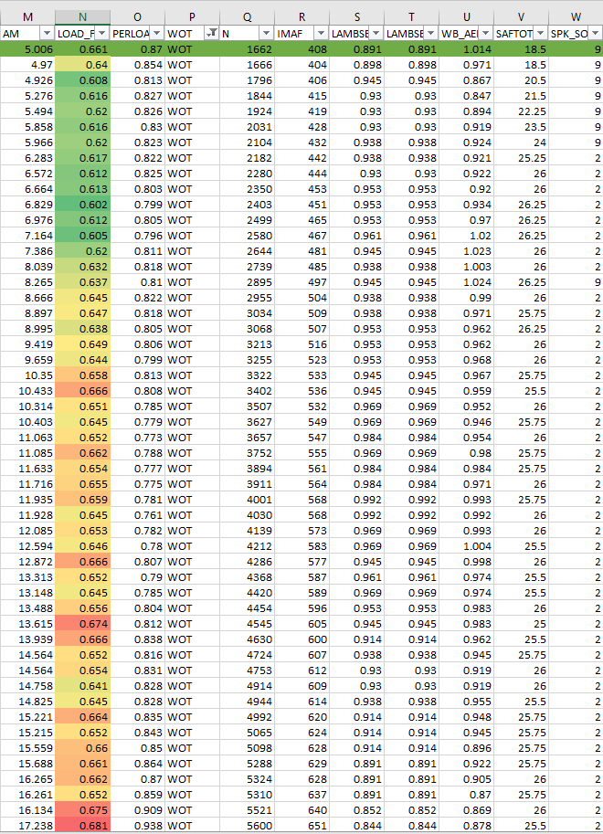

1) For dialing in PERLOAD (Which I have set to 0) ... which histogram has the corrections that would apply for CBAZA?
2) My guess thus far (based on some interpolation and reverse math from my logged WOT runs) is that LOAD_FG would be the ACTUAL load the ECU is registering and using to calculate PERLOAD. Is that correct?
3) I currently have the Kenne Bell bypassed, running a short belt, and dialing in fuel, load and spark with it NA before I dive into Boost. in NA form during my WOT runs Load_FG remains between 0.600 - 0.700.
From a number/validation perspective, would that be normal for an N/A - stock bottom end HCI 302? Nothing really radical about the engine, Edelbrock Performer heads, fairly tame Crane 2031 cam, ported gt40 lower intake. Of course the Kenne Bell is sitting on top of all of that, I was wondering if running that compressor bypassed is hindering the engine's ability to ingest as much air as it can. I can't recall if my vac/boost gauge was registering 0 during the runs, I was much more focused on the WB readings, but it should have been 0 at WOT unless the bypassed supercharger is restricting airflow to that extent.
