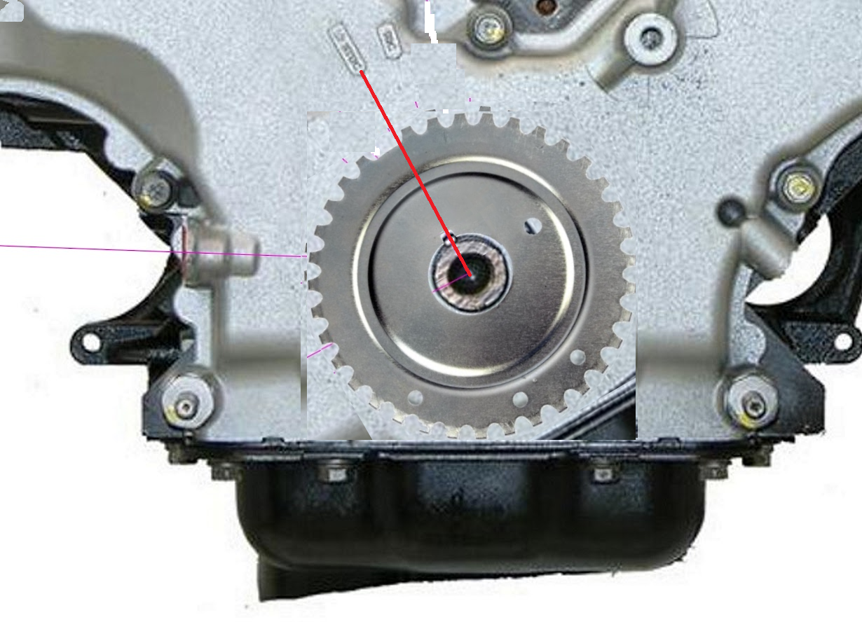

Is the following correct when looking at the position of the 36-1 wheel and crank keyway.
I'm comparing this to a 351w setup I have.
- crank keyway is at TDC, around 30 degrees
- crank sensor pointed directly over tooth, 90 degrees mounting location
- missing tooth exactly 5 teeth away
Image was done in ms paint, not precise and I think it gets the idea accross.
Posts: 7101
Re: 5.4 modular 36-1 alignment
Yes, at tdc the sensor needs to align with the 5th tooth
