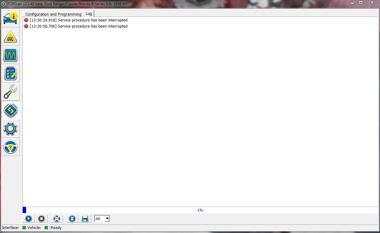

Not being aware that these older pwm/feps based pcm's were very restrictive in their ability to retune..what do I need to interface with the pcm to do simple tuning?
Forscan can do basic monitoring of the pcm's readouts but cannot retune anything as Forscan will not communicate with pwm or feps to retune.
I came across Michael Decipha Ponthieux webpage on *how to get started* ...I take it that a J3 cable & a J2534 interface is needed to communicate with this old pcm. Will TunerPro get me to where I want to get to?
All I want to do is alter the engine idle rpm profile & alter the trans upshift/downshift parameters to remove (what I regards as) an error in the sequence that the pcm commands the trans upshifts & then downshifts.
thx in advance

What makes them awkward to retune?...I'm assuming it's because Forscan altho it can communicate by a J2534 adapter cannot program to this pcm which is PWM/FEPS because a J3 cable is needed?. my Forscan program & the Vgate adapter are FTDI based. At every attempt to run a *service* there is an interruption in the process due to the inability of the of the Forscan program & the pcm to communicate.

The Vgate is limited to FTDI, its drivers are all FTDI, it is J2534 pass-thru capable, but not J3 capable. where the *control/programming* side is concerned the pcm doesn't recognize any scanner program that is interfaced by an FTDI adapter. I CAN monitor but not program.

the *FEPS* requires a signal on pin 13, the adapter has to be J1850, Forscan is 2534 capable but not J1850
as far as I can decipher pin 13 on my FTDI based adapter is dead
