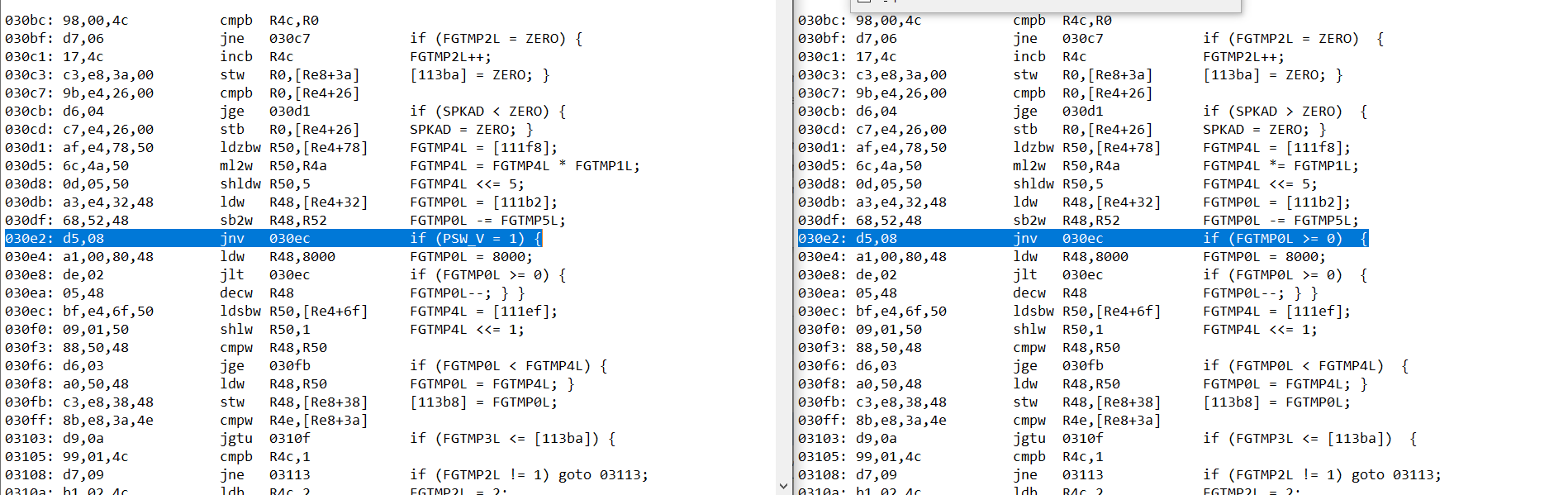

Got one small issue I noticed really quickly. I posted a screen shot below, the panel on the left is v5.0.7 and the one on the right is v4.012.
Both are of my eqe3 bin file.

PSW_V = Program Status Word _ Overflow Flag V
For the instruction JNV, PSW_V is correct.

I wasn't sure that 'overflow' (PSW_V flag) was interpreted correctly for previous ops. CARRY (PSW_C) had errors too in earlier versions, but I reckon that works right now. So I temporarily dropped the lookup of previous ops for overflow flags. I do intend to restudy the Ford manuals and put it back, in some cases it's obvious, but some aren't, so it requires going through opcode by opcode to make sure.

Ok, so it was incorrect in the older version then.... I am still learning, so it is good to know. I just noticed the whole line pretty much changed witch completely changed the way I was following the code. Thank you for the clarification.

SAD attempts to find the PSW flag setter and print the relationship relevant to the jump type.
In this code snip, SAD has not found the PSW setter.
SAD has printed 0 > 0, which is clearly incorrect.
341f: 29,2b scall 354c Sub_354c ();
3421: d1,03 jleu 3426 if (0 > 0) {
The choice of V instead OVF, is intended to align SAD with the Manuals and Handbook.
When SAD was first released the manuals and handbook were not publicly available, so OVF was chosen on other criteria.
Now, the user can search the manuals and find PSW and the V flag to understand the meaning.
Jump statements were incorrect in some cases but not all.
Hopefully as some point, SAD will find all the PSW setters and correctly print relevant statements.
Would V_PSW be more appropriate than PSW_V?
