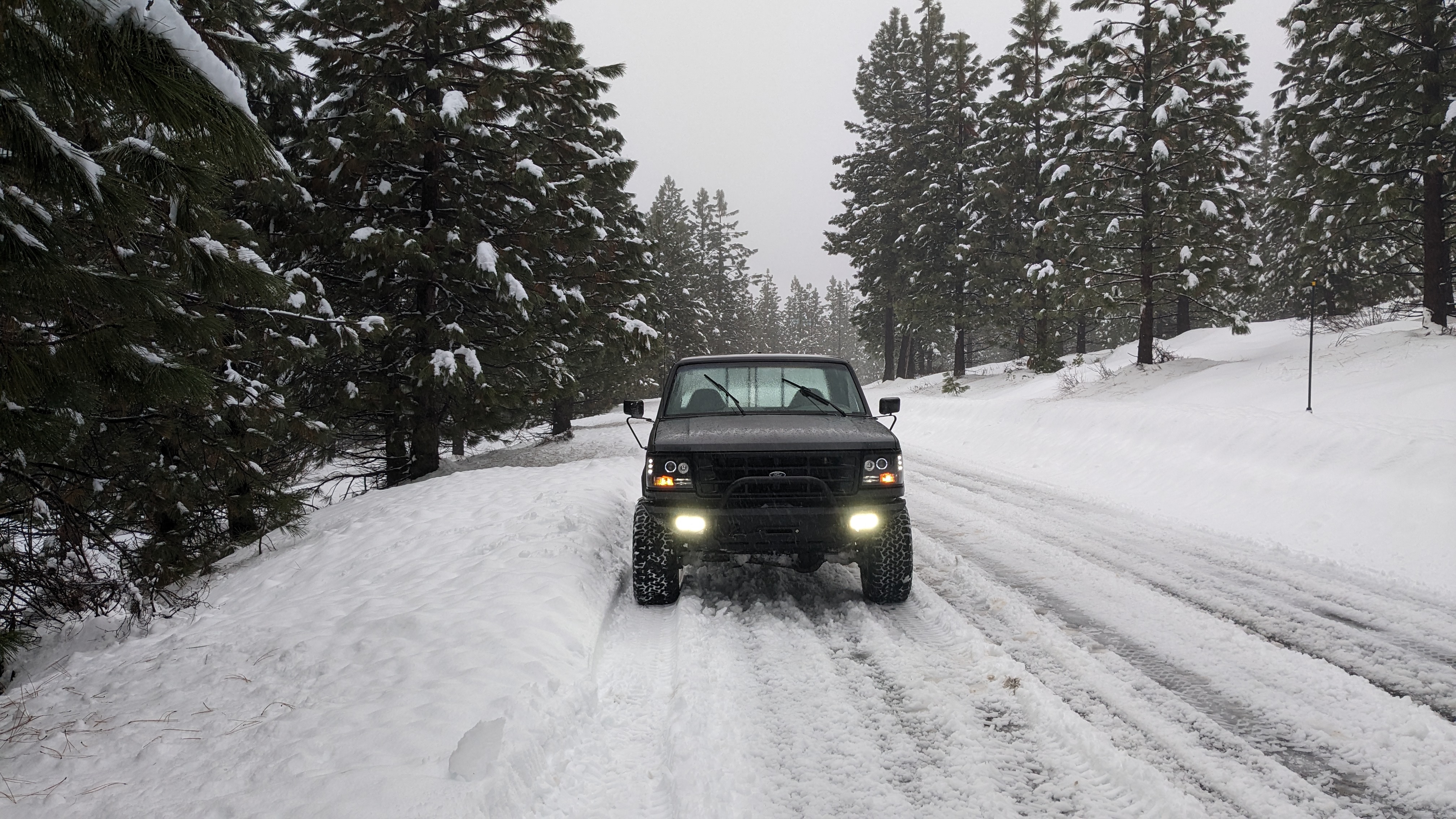

Naw too heavy. There was a 7.3 power stroke stuck in the ditch when I took this pic.
