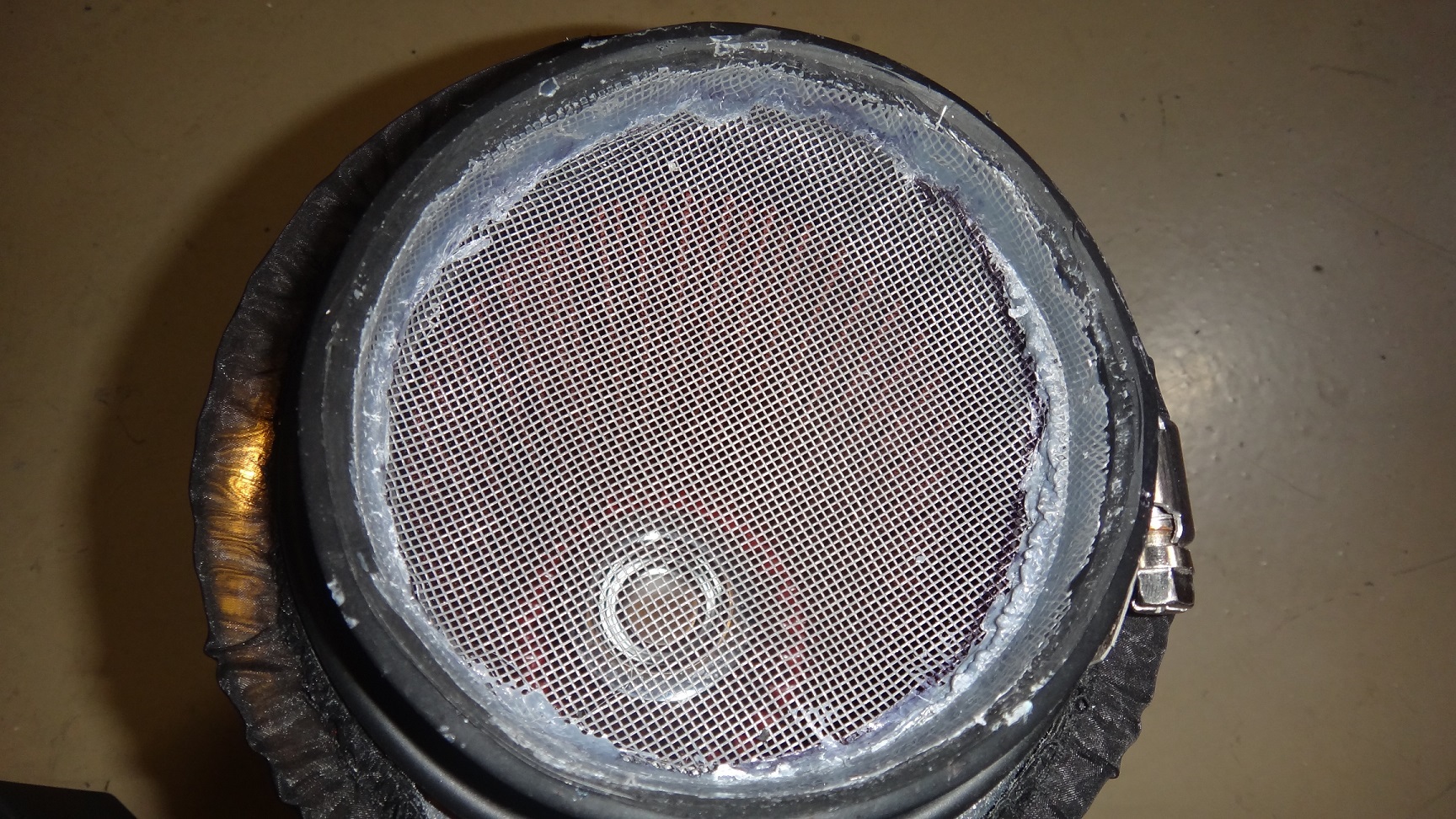

Intake Build Info:
As for the new intake, it's 102mm (4"~) I.D. intercooler pipe with the MAF and ACT sensor mounts I designed and 3d printed. ACT is about 10-20* over ambient now (AZ summer time, so ambient is about 100-110*) and very consistent (while moving, idle obviously will be higher). Just opening the hood vents, I was about 20-30* over ambient. Prior, basically stock for the intake system and the ceramic coated exhaust headers, I was about 50-70* over ambient then wrapping the exhaust below the headers up to the first cat reduced to about 40-60* over ambient. It does raise if I sit at idle but it's still way lower because of the open vents on the hood. The TB is 52mm x 2 inlets so 104mm total and the intake tubes are 55mm I.D. x 2 (minus those "tube shaping coils" they have inside). The original MAF setup was roughly 3" I.D. overall with a 55mm Mustang MAF sensor body choke point in the center.
The Y-Coupler I designed is 104mm I.D. at the large opening with the two 52mm I.D. outlets (104mm minimum volume at any given point in the coupler) that go to the main intake tubes w/ a 22.5* bend at the center of the coupler. My friend is WAY better at CAD than I am (he designs parts for a living) so he's re-designing it for me (and he wants one too) to look more like a real part ;) Next time I'll prob print in a special TPU (Thermal Plastic Urethane) I have called NinjaFlex which is awesome for structure, tear resistance, and heat tolerance. I might even build it with some ABS structure since I can print w/ two materials at a time which would allow a more rigid structure at say the connection ports with ABS or say 75% ABS, 25% TPU with a more flexible portion around say the mid-section using only TPU. TBD.
One thing w/ MAF (ya'll prob know this :D ) is it needs laminar (even/level/not turbulent) air flow to measure accurately. MAF setups usually have a mesh screen to make this happen so I had to make sure I added that which I did. Since the pipe and air filter hide it, it was ok for it to not look pretty but it's nylon screen so it's tough and I used ABS plastic slurry to form the outer ring and basically mold it into the filter and around the pipe. Works very well :)

Intake Build Info:
