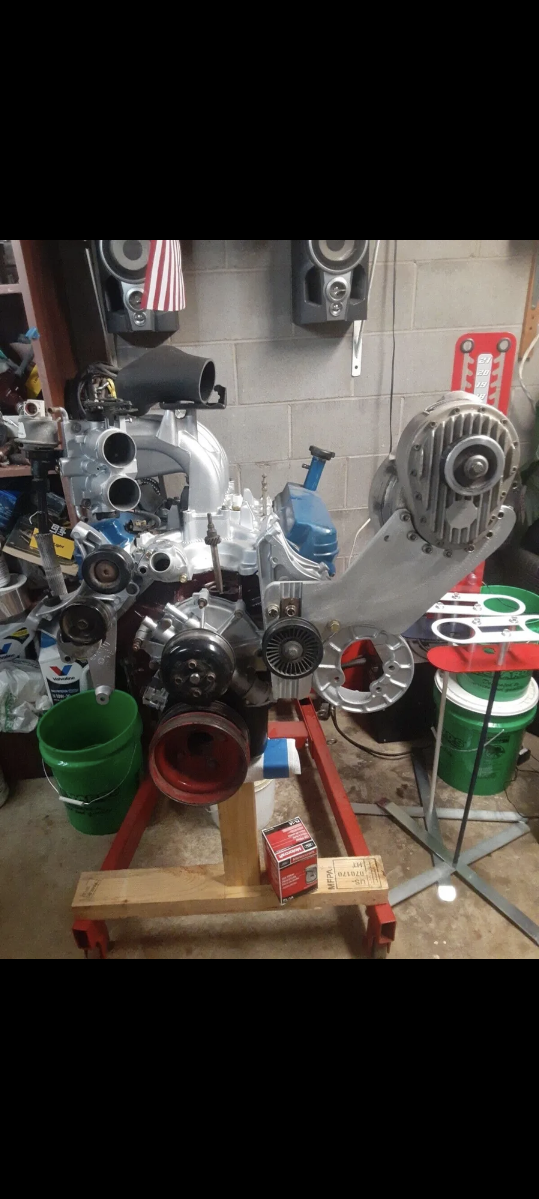

Is there any hope of a centrifugal sc doing a decent job below 3k rpm?
Https://www.ebay.com/itm/255310524650
This looks like something I can tackle with my skillset. Fabbing from scratch certainly is not.
