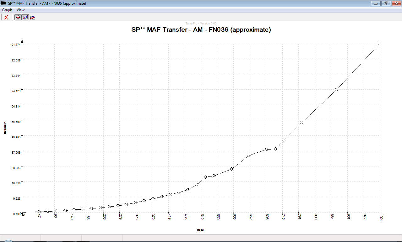

Yeah that split second of richness on decel after you closed the throttle is from too much decel fuel. I reduced it quite a bit should be much improved.
Yeah something is definitely going on at that 4500 area. Looks almost like the ignition is breaking down. How old are the plugs? Have you tried running them wider than 40 maybe around 60 or so? Are you running the vb921 coils?
The fueling seems to be jumping back and forth up top.
imaf err
775 2
750 0
725 .92
700 .96
650 8
600 5
550 11
525 16
There's a bit of turbulence in the maf right around that 525 imaf range thats causing fuel to fluctutate a touch and again up top. Heres the maf curve to give you a visual.
In any case, load this in and shoot me back another.
