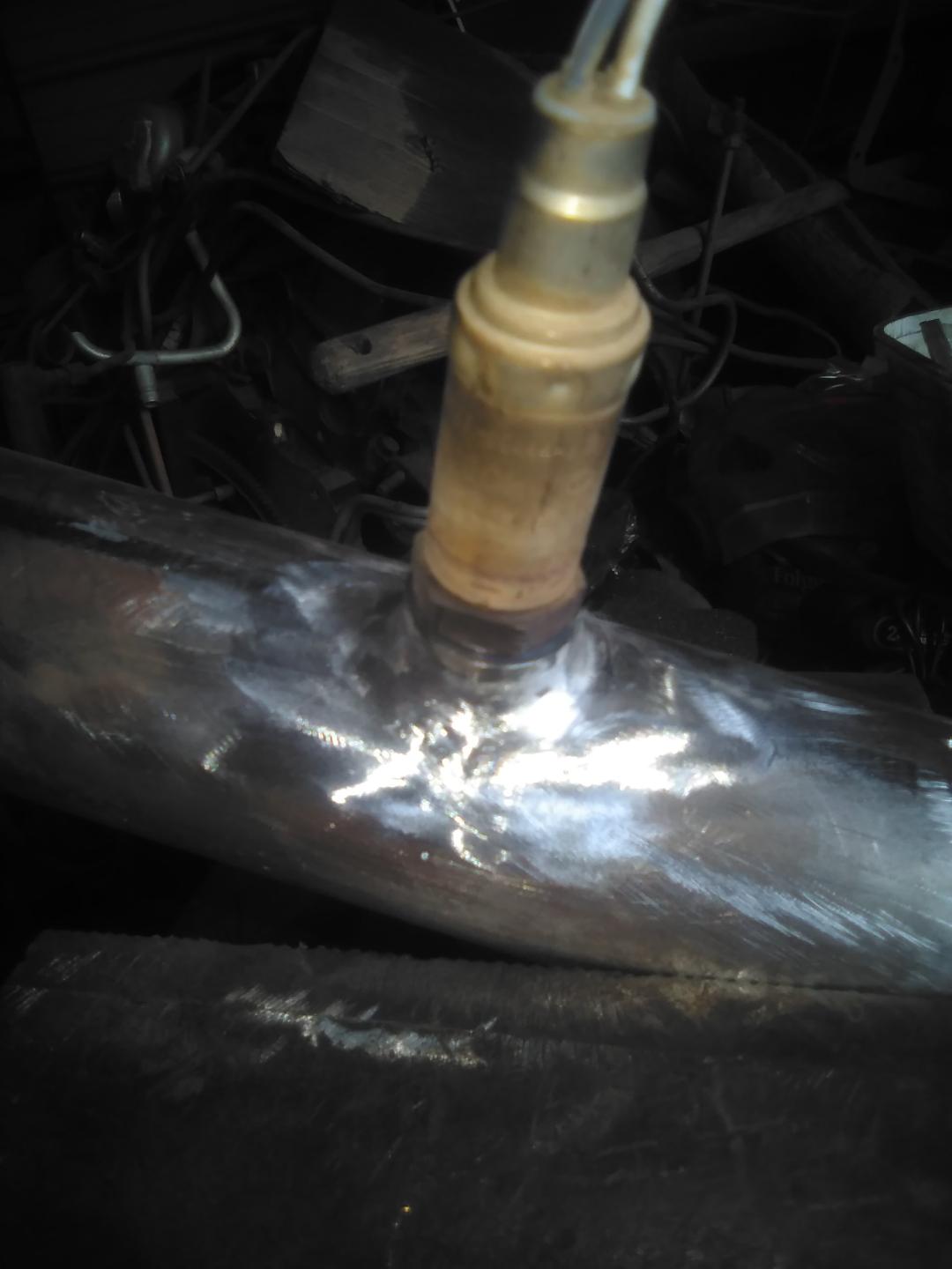

Left o2 sensor too far back plugged.
Hole for bung.
Clamped ready to weld bung.
Left narrow band o2 sensor installed.

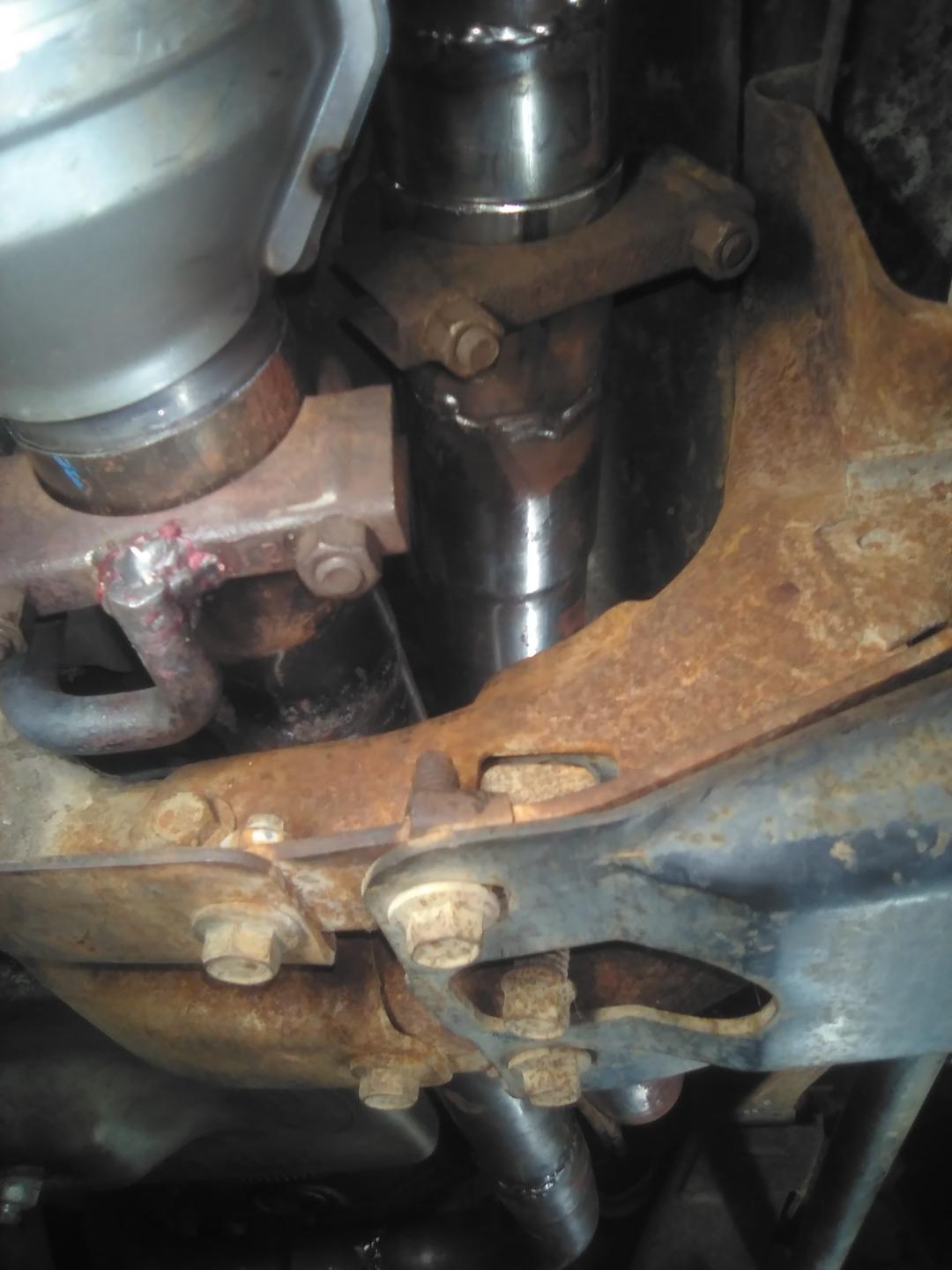

Hanger made from jack handle.
Recycled muffler clamp.
Hanger & clamps installed
