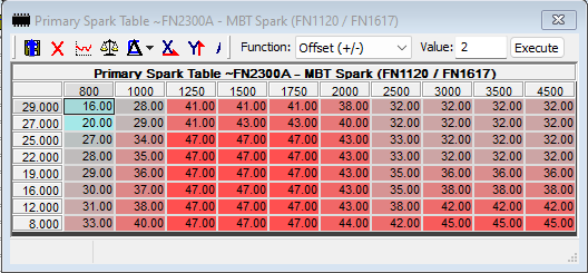

Running injector cleaner for a few thousand miles cleared everything up. Anyone running AFR heads able/willing to share their spark table? My truck runs great with this table but was hoping to compare with other similar setups. It needs a lot of timing below 2k rpm as you can see.

Posts: 7101
Re: 400hp 351w startup tune
that looks horrible
41 degrees at wot between 1250 and 1750 rpm is significantly over advanced
the mbt guidance on the homepage would get you much more in the ballpark
Posts: 441
It just doesn't make any power otherwise. It looks terrible because load is 22+ at cruise under 2k. Even the slightest incline will push it to near 29 at less than half throttle.
Posts: 7101
pull 15 degrees out right there and it should make significantly more power
Posts: 441
Cool I dropped 12 degrees and it made slightly more power but was rougher. I added a few back and it smoothed out. I am thinking one or more of the injectors are still gummed up and the extra timing is helping the inconsistent mixture light off better. I really don't want to pull the upper intake as I have to make a custom gasket each time. I am running Lucas injector cleaner. Do you have a better recommendation?

what rpm is in question? example; 1600 lugging in a high gear with tall tires is gonna be rough with a bigger cam. Stock cams are superior in this area.
Posts: 441
In od I am running 1500rpm at 55mph. It actually cruises nicely as long as fuel delivery is happy. Is the tfs1 considered a big cam? I have 1.73 rockers as well
