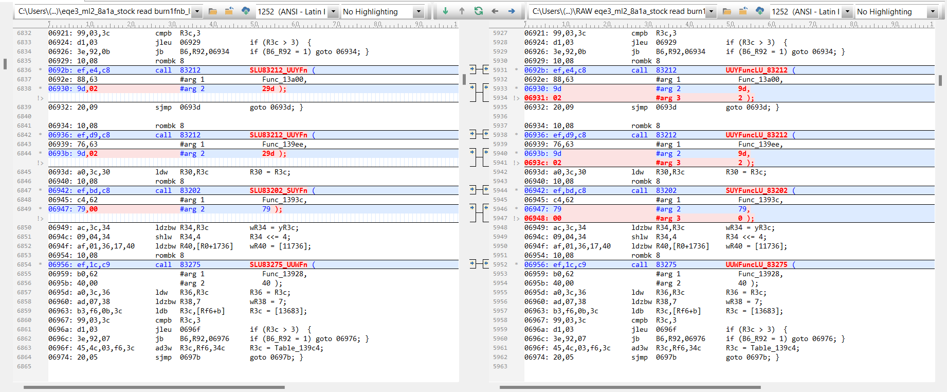

Raw MSG
rbase f0 12060
sub 83212 "UUYFuncLU_83212" $ F uuyflu 36
Sub 83212 "SLU83212_UUYFn" $ F uuyflu 36 :E4 F0 N :WN
0692b: ef,e4,c8 call 83212 SLU83212_UUYFn (
0692e: 88,63 #arg 1 Func_13a00,
06930: 9d,02 #arg 2 29d );
06932: 20,09 sjmp 0693d goto 0693d; }
As TVRfan mentioned SAD does not always get the size of arguments correct.
For the 1st command option;
E4 is Encoding method 4, you can read about it in the SAD docs.
F0 is the Rbase to be used.
N name the address. SAD has a default function name to display.
For the second command option;
W defines the second argument as a Word, not two bYtes as SAD had determined automatically.
N name the address. When register 29D is given a name by using the SYM command, the name will be displayed in place of 29d.
The changes should be present as they have been commanded by the user...but are they correct...to the best of my ability, yes.
