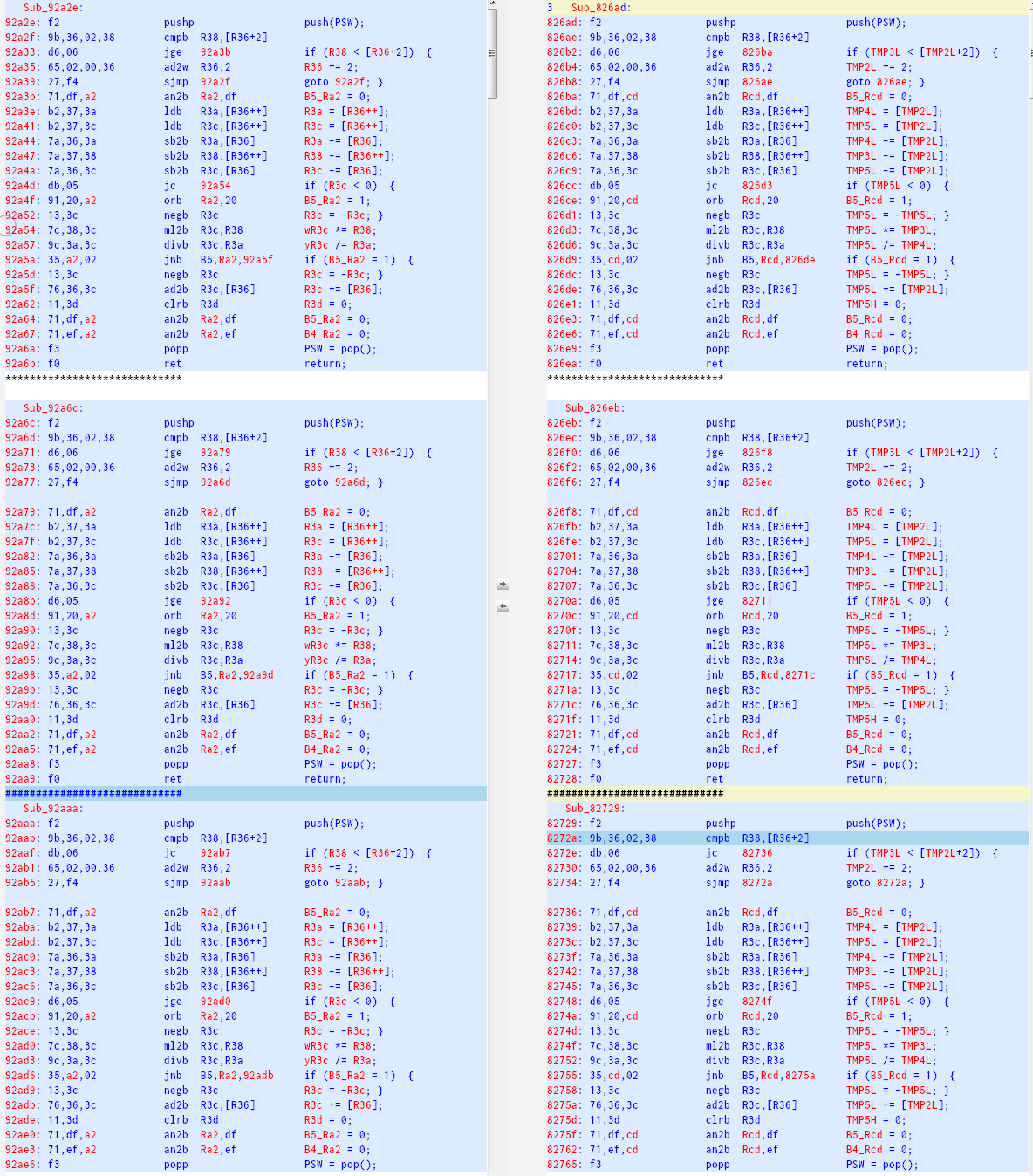

From this screen grab, you can see they match off RZASA 92a2e <> OMAE2 826AD.
Put the lookup subs in OMAE2 dir and change/rename the addresses.

##### Function Lookup Subroutines: R36 Fn_Addr Reg, R38 Input Reg, R3C output Reg
SUB 92A2E "SLU92A2E_SUYFn" $ F suyflu 36 # Undiscovered by SAD4.07.16
SUB 92A6C "SLU92A6C_SSYFn" $ F ssyflu 36 # Undiscovered by SAD4.07.16
SUB 92AAA "SLU92AAA_USYFn" $ F usyflu 36 # Undiscovered by SAD4.07.16
SUB 92AE8 "SLU92AE8_UUYFn" $ F uuyflu 36 # Undiscovered by SAD4.07.16
SUB 92B26 "SLU92B26_SUWFn" $ F suwflu 36 # Undiscovered by SAD4.07.16
SUB 92B62 "SLU92B62_SSWFn" $ F sswflu 36 # Undiscovered by SAD4.07.16
SUB 92B9E "SLU92B9E_USWFn" $ F uswflu 36 # Undiscovered by SAD4.07.16
SUB 92BDA "SLU92BDA_UUWFn" $ F uuwflu 36 # Undiscovered by SAD4.07.16
SUB 92C16 "SLU92C16_**YFn" $ F uuyflu 36 # Un/Signed In, Un/Signed Out
SUB 92C62 "SLU92C62_**WFn" $ F uuwflu 36 # Un/Signed In, Un/Signed Out
###### Byte Table Lookup Subroutines: R3C Tb_Addr Reg, R34 Column Input Reg, R36 Row Input Reg
###### R38 Column Quantity Input Reg, R3C Unrounded Output Reg, R3E Rounded Output Reg
SUB 92D8E "SLU92D8E_Y16SYTb" $F sytlu 3C 38 # Byte Inputs *16, Signed Word Out
SUB 92D93 "SLU92D93_Y16UYTb" $F uytlu 3C 38 # Byte Inputs *16, Unsigned Word Out
SUB 92DA0 "SLU92DA0_WSYTb" $F sytlu 3C 38 # Word Inputs, Signed Word Out
SUB 92DA5 "SLU92DA5_WUYTb" $F uytlu 3C 38 # Word Inputs, Unsigned Word Out
SUB 92DF3 "SLU92DF3_yTb.Interpolate" # Interpolate 4 byte cells to find Control Value Pass 1 & 2
SUB 92DF7 "SLU92DF7_yTb.Interpolate" # Interpolate 4 byte cells to find Control Value Pass 3
###### Word Table Lookup Subroutines: R3C Tb_Addr Reg, R34 Column Input Reg, R36 Row Input Reg
###### R38 Column Quantity Input Reg, R3E Output Reg
SUB 92E33 "SLU92E33_Y16SWTb" $F swtlu 3C 38 # Byte Inputs *16, Signed Word Out
SUB 92E38 "SLU92E38_Y16UWTb" $F uwtlu 3C 38 # Byte Inputs *16, Unsigned Word Out
SUB 92E45 "SLU92E45_WSWTb" $F swtlu 3C 38 # Word Inputs, Signed Word Out
SUB 92E4A "SLU92E4A_WUWTb" $F uwtlu 3C 38 # Word Inputs, Unsigned Word Out
SUB 92E8E "SLU92E8E_wTb.Interpolate" # Interpolate 4 word cells to find Control Value
