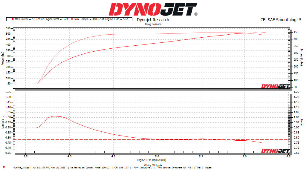

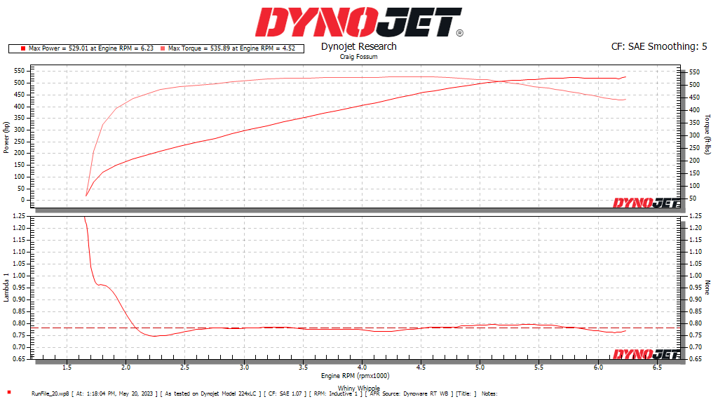

Attached is a WOT pull in 3rd gear, Don't mind he wideband reading as I've come to the conclusion that the owners old ass ori AEM wideband seems to be all over the place and I do not trust it by any means. My dyno's wideband seems to be working well and is currently at the tail pipe. I will crawl under the car tomorrow and temporarily install a AEM X series wideband I'll analog into the EEC on pin 65 and see if I can get it working better for logging.
The dyno run attached shows the Lambda reading which I have a reference line of .780

This is what I can tell from the dyno graph.
513hp at 6240 rpm
448tq at 5610 rpm
wot rpm lambda imaf spk load
5700 .78 537 16.25 1.84
5500 .79 530 16 1.85
5000 .785 516 15.75 1.88
4500 .835 500 15.25 1.91
.8 commanded
that's perfect. Depending on the compression ratio, boost and fuel grade you may be able to squeeze a few more degrees of timing in her and make a tad more. Without the vehicle info sheet its impossible to know.
513hp at 6240 rpm
448tq at 5610 rpm
.8 commanded

I do agree about starting the dyno run low rpm wise and just didn't want to load it up that hard yet not knowing where load, spark etc were going to end up as all I did was use the 91 octane SCT value file for this thing when i first started with SCT on it.

You could summarize that as being bone stock running 93 with a 3.4 whipple at 20lbs using bad injectors, a high flow slot in the crusher and a return fuel system swap.

Also you should always leave the smoothing factor on 0 on your dyno. You want to see those little dips and instabilies on the graph.

Hitting the rollers today for a bit while its quiet around the shop and I can somewhat concentrate. I'll surf the new file a bit and see if I can make heads or tails of the changes made.

Wow, minimal idle adjustments, minimal CL maf adjustments, Did a pull to see where I'm at and she laid down 515 wheel already without breaking a sweat. I noticed load and perload are maxing out. It sure sounds a lot cleaner and is idling way better.
I don't see a WB transfer for the ZT-2 and only ZT-3, not sure if they are the same but looks like it dipped pretty rich on the Dyno Jets WB compared to the ZT-2 Gauge which is currently logging using the ZT-3 gauge selected. Dynojet WB is installed in the tail pipe using the clamp from innovate.

Well this is this is where I'll stop the wot stuff for now, it feels good and sounds good but time to review this a bit more. Looks like I may have to bring load down to leave room for error or if the owner doesn't plan on a smaller pulley anytime soon should I leave it be and it will just clip the top 2 rows of the borderline spark table? EDIT just read back and I do agree can't run this thing any harder anyways so probably not a big deal to leave load hey ?
Another question I have is when looking the datalogging screen do we watch Borderline Spark or spark actual PID.
Edit : just noticed I forgot ro get rid of the smoothing, I'll Def get that back to 0 so we can see any bumps and lumps!
