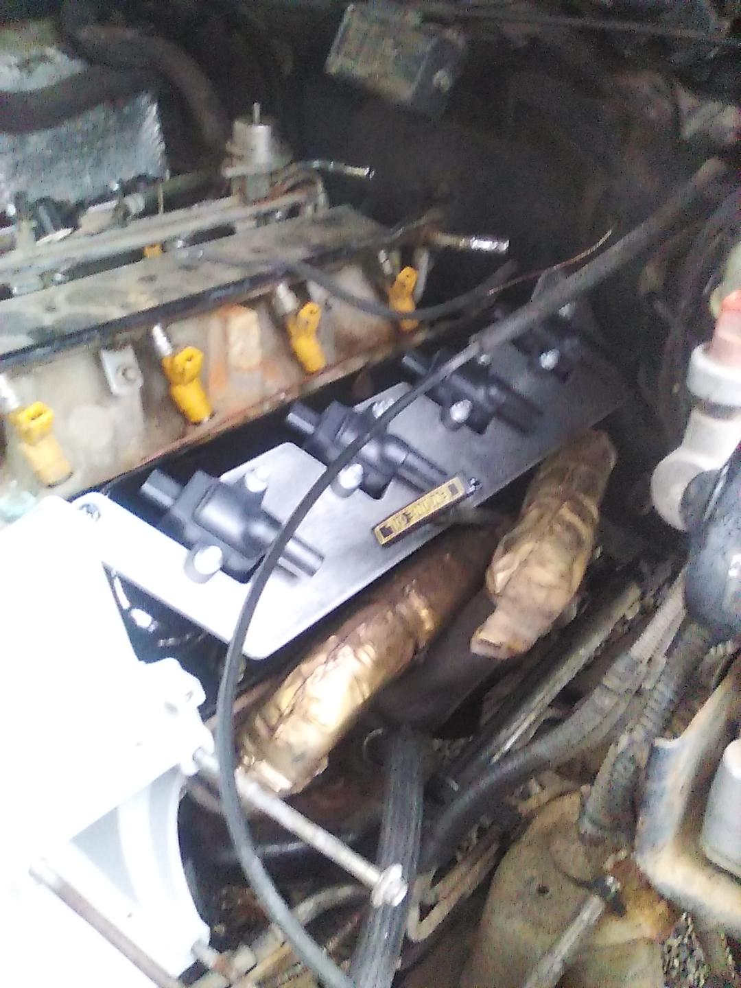

At work where the truck is and blocking antique Mustang restoration projects, early in this week I have been able to get the coils on the brackets fitted for the first time. I had to get quite persistent with the Fabrication shop to finish up and then cut the brackets. If I was more PC literate, I would have designed them myself and used the online send-cut-send service. These were cut on a plasma cutting table and all of the edges look like cutting torch edges.
So as soon as I get the word as to what to do with the EGR wires, I can move forward on the harness. I have today that I could stay home for a while and could maybe even get close to finishing the harness to get it back on the powertrain.
Pictures below of fitting the brackets for the first time. The 1997 Mountaineer/Explorer one year only headers interfere. I'm going to have to do something different as it has to do with the exhaust.

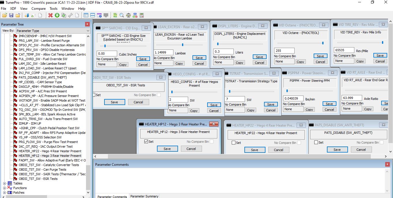

In preparation for the first firing, I'm doing a little work in TunerPro on the laptop here. I have a 1999 CV passenger car bin file loaded into TunerPro along with the CRAI8_230620 xdf file. I'm wanting to switch off PATS and adjust the gear ratio. Also, I want to switch off the rear O2 sensors. Also, you can see by the open parameter windows, I have several questions. I haven't changed anything and I assume that when I do, I will "save as" the file with a new name.
This snip is a pic of the PATS info as it is in the virgin bin file AFAIK. Also, in the snip you will see what I found when I searched for PATS and rear axle. Here is a snippet of the bin file identification at the end of the file in hex. Saturday early morning. I have been looking through parameters and flags.

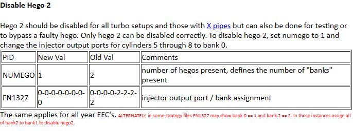

Now I'm studying about the Disable Hego 2 Any tips would be appreciated.

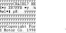

You cant edit a craib file with crai8 its two different strategies, youll corrupt the file
also all you have to do is open the scp id scalar in tunerpro and it will show you the strategy / cal code tag
you need to download the yya2 file in the crai8 downloads, thats a stock 99 crown vic cal. yya2 is the police bin so theft is already disabled. 63.99 if max value (0xFF == null) which means your vid block wasnt setup on your ecu. Thats not uncommon.
the original bin file you read out can be deleted its absolutely useless since you dont need the pats code or vin from it.

I've just opened the YYA2 bin obtained from this site and I'm looking at the end of it. So even though it says CRAI8, it is different but it works with the xdf file?
The 2nd PCM just mentioned has an ARA1 sticker on it but has been dealership or motor pool flashed to ARA3.

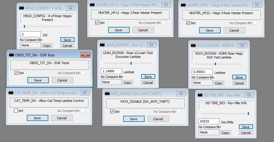

I'm looking through parameters and I have several in the capture pic. Some of them I feel confident about switching off. Some not. I see PATS is switched off. Number of rear hegos could be changed to "0". OBDII_TST_EGR can be not set to skip test. Others I'm not sure of.
