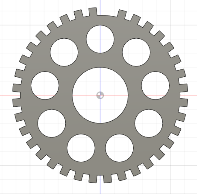

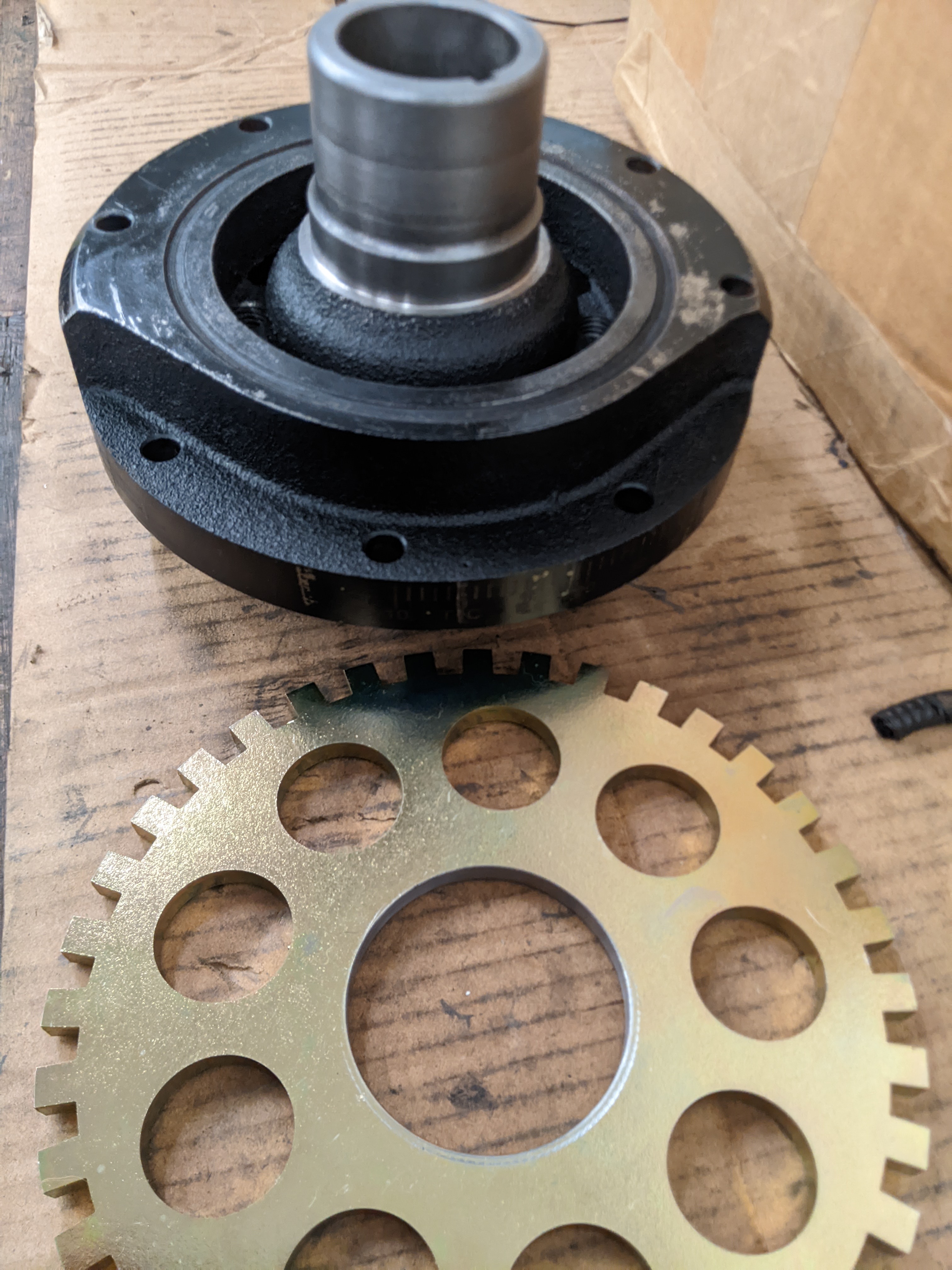

The trigger wheel has been harder than initially thought. The SN95 5.0 can't easily sandwich a trigger wheel between the harmonic balancer and crank pulley. The Explorer integrated harmonic, pulley, trigger wheel assembly does not work with the SN95 mustang serpentine system due to different depths. I tried adapting the 64bit Tuning trigger wheel to the back of the SN95 balancer unsuccessfully.
So what know? Time to do it myself. I'm going to take the balancer to a machine shop to get a lip machined on the backside snout. Then use SendCutSend to get a trigger wheel cut out that will press onto the newly machined lip. Maybe a few weld tacks to make sure it stays in place. This will allow use of the explorer timing cover and sensor.

Oh yea, found this enough about trigger wheel design:
In general, for the stongest, cleanest signal:
The tooth should be as wide as the gap,
The gap should be as deep as the tooth,
The wheel should be at least as thick as the sensor element (not the whole tip, just the sensing element - typically ~1/8 inch).
Source: http://megasquirt.free.fr/sources/MS/ma ... 2/36-1.htm
The explorer wheel has a thickness of ~0.25 inch. The 64bit Tunning wheel has a thickness of 0.125". I'm leaning towards the 0.25" thickness for mine.

I'm finally getting back on this topic and think I'm better prepared this year to complete it.
I've designed, cut, and machined a trigger wheel to fit on the stock SN95 harmonic dampener. The back of the dampener was machined to accomplish a press on fit of the trigger wheel. The machined surface ends 1.7" from inside end of the dampener. This put the trigger wheel in the center of the explorer crank sensor when using the explorer timing cover. I've started design of my coil brackets. They will mount above the valve covers using stand off on the valve cover mounting studs. Coils will be Ford Godzilla coils with LS plug wires. I'm using trick flow valve covers and can't bring myself to grind and weld on them at the moment. Hence the bolt on solution for coil brackets.
