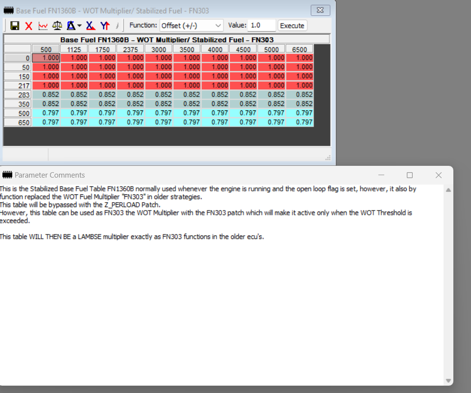

But that's what I've never understood is basically with narrow bands these ecms don't really know what is going on and just to kick into OL at a certain TPREL and follow base fuel table for commanded lambda so then Lambse (stft) would then command lets say .780 lambda and then do you basically just tune the maf to follow the commanded lambse. After reading the parameter comments it says this table is treated as a multiplier, so basing that on 14.10 stoich value x .780 = 10.99 AFR or am I mathing wrong.
With that being said I noticed there was no OL flag in the SCT live link to check out but I can watch the trims switch to the commanded .780 I was commanding at WOT so I thought maybe the EEC just says hey were in OL lets command .780 and then said tuner would make it all happen with MAF and or Failed maf and use the tables as a reference to where its all set and suppose to be. LMK if I'm off kilter here lol

Re: 03 cobra - SCT Tuning questions
correct the table is in lambda no need to convert to AFR that can only give you errors. Use Lambda learn lambda and you can never be wrong. If you use AFR you will almost always be wrong and can almost never be right.
