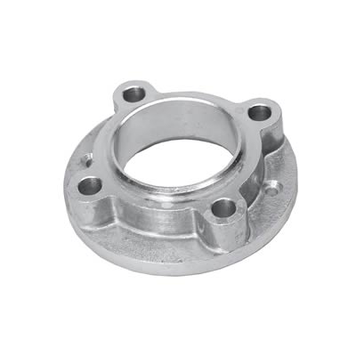

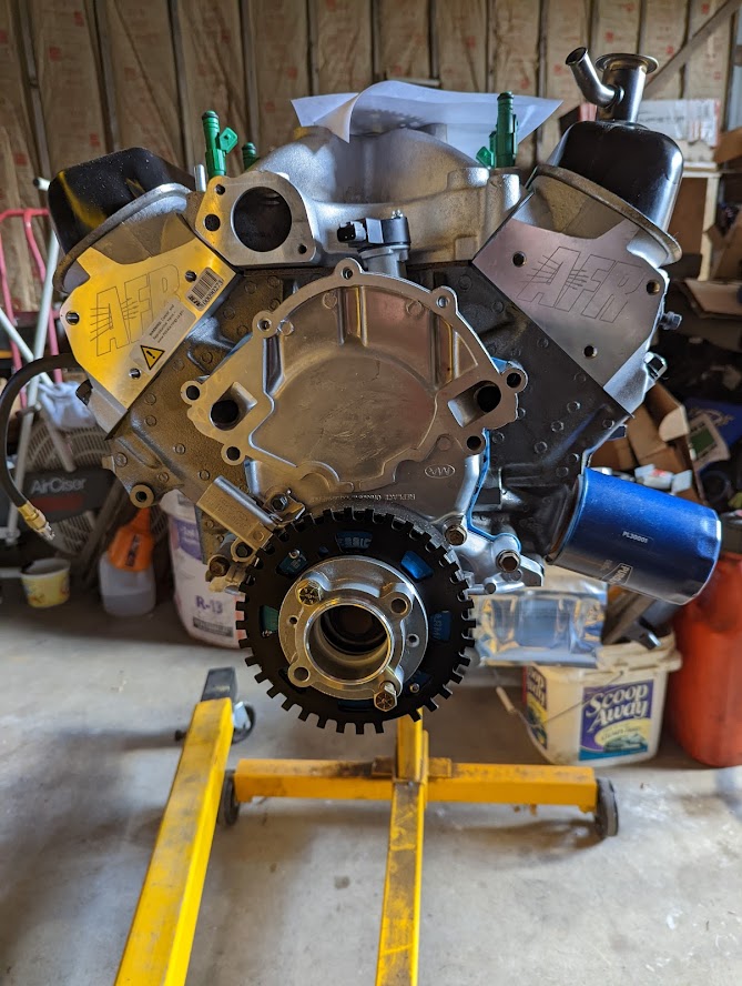

Here's my 408. I am using the 9006 Professional Products Damper, the 81007 Pulley spacer, the 64 bit wheel, the 64bit cam sensor. Just got an Innovators West Crank 931-3125 trigger bracket. It will be easy to take an 1/8th of the back or the pulley spacer. And I think the PCE626.1001 from speedmaster79.com will work.
- (9.47 KiB) Not downloaded yet
- Damper Spacers.pdf
- (49.62 KiB) Downloaded 1756 times
- Posts: 471
Re: Mustang SBF EECIV to EECV Swap
The way you have that mounted, the hubcentric ring is not used so the adapter is not being positively centered which means the pulley won't stay centered. The wheel is supposed to go between the adapter and pulley. You need to shorten the front of the adapter .120 which is the thickness of the wheel. You still need the lip that centers pulley and the wheel. For sn95, that won't work because the sn95 pulley of not flat on the back.

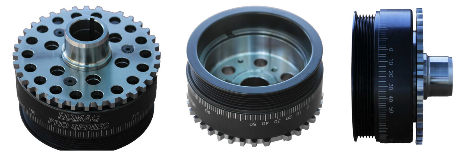

Anyone ever tried this balancer, its a Romac.
There's a video on YouTube of a a guy putting this into a cobra.
Looks good, I'll have to do some measure measurements to verify fitment compared to stock.
It is for a 302/351w, 28oz.
