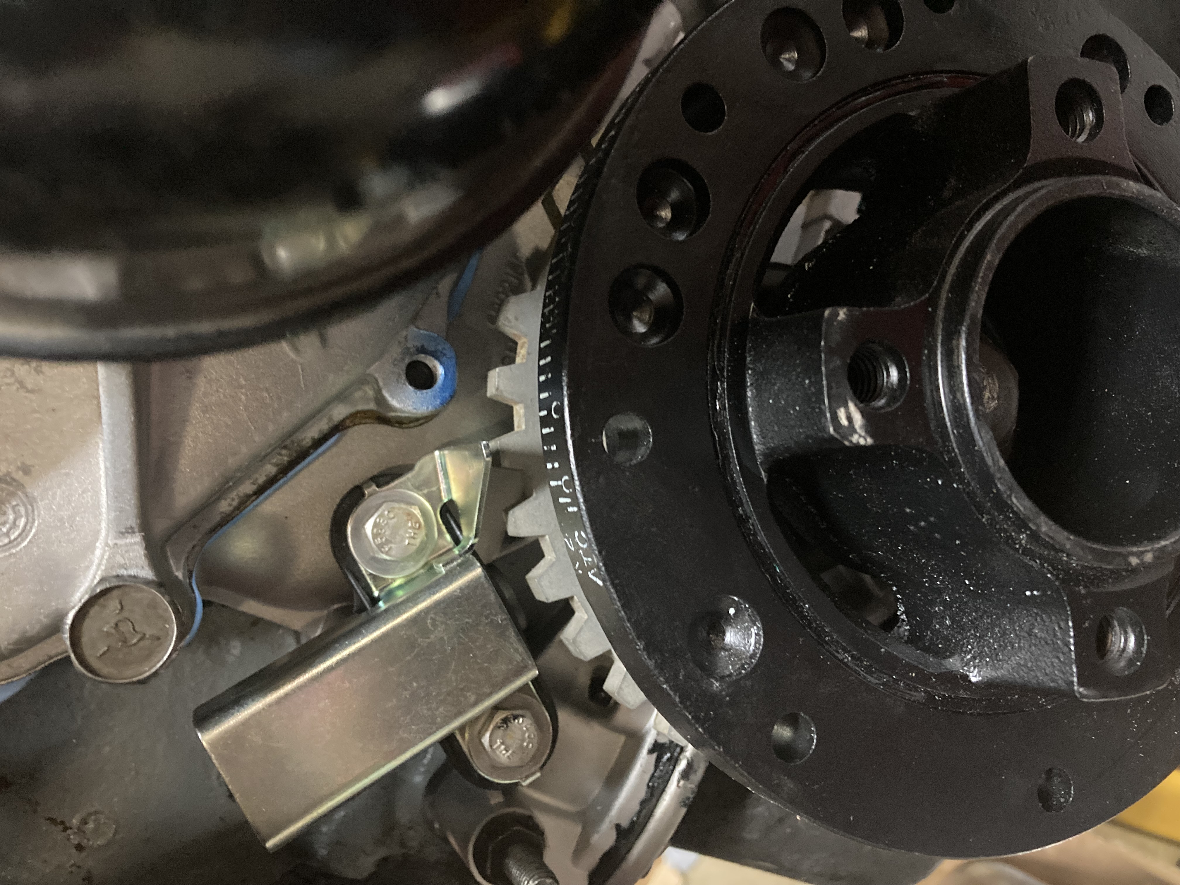

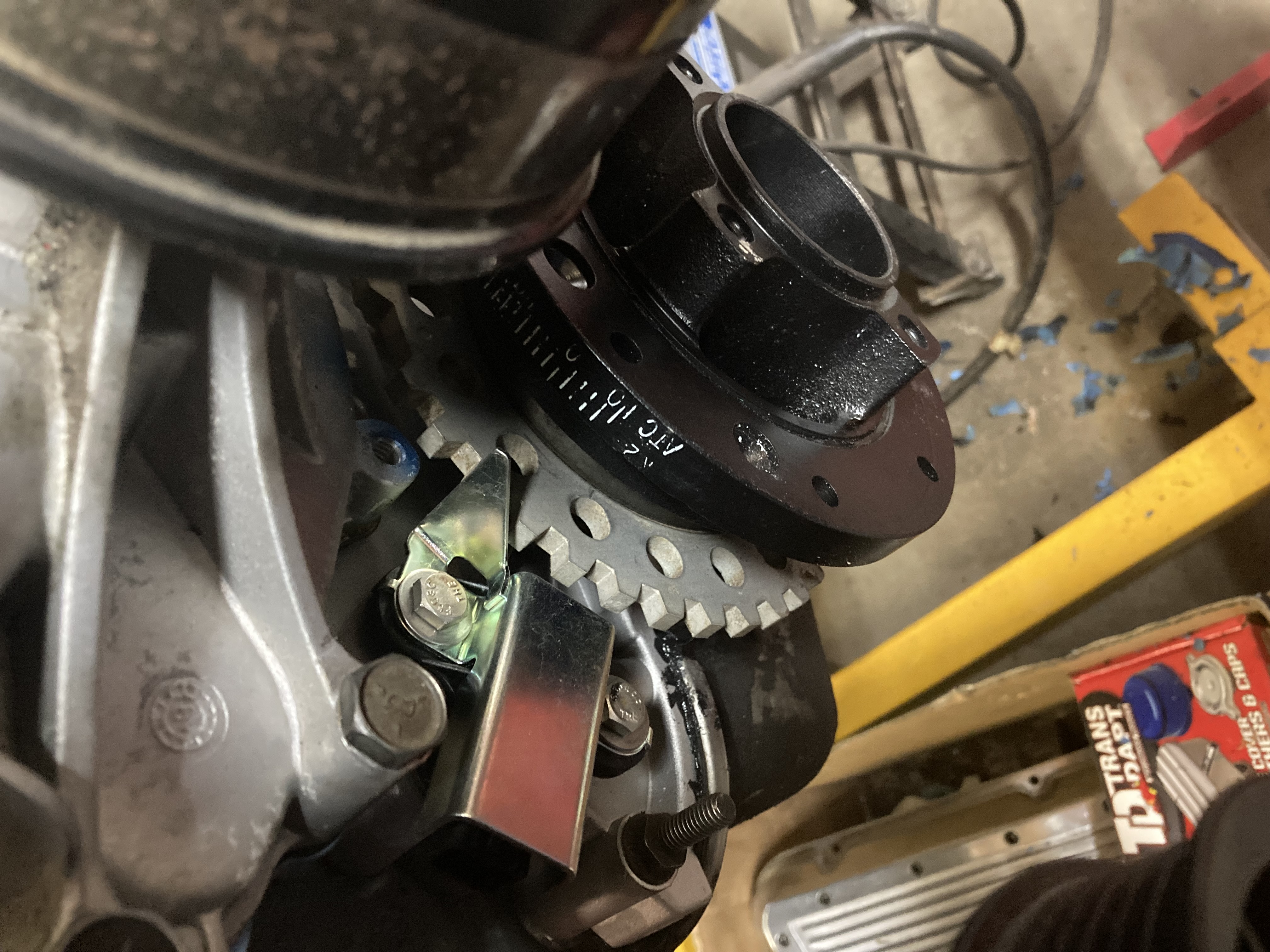

- Posts: 417
Re: 351w 36-1 alignment
Just a picture of what I’m working with.
- Posts: 287
Is that a new Windsor damper that you found?
- Posts: 417
Used, E1TE-C3A, listed on eBay as a E1TA.
Just got another F6TA-JA, very hard to find.
