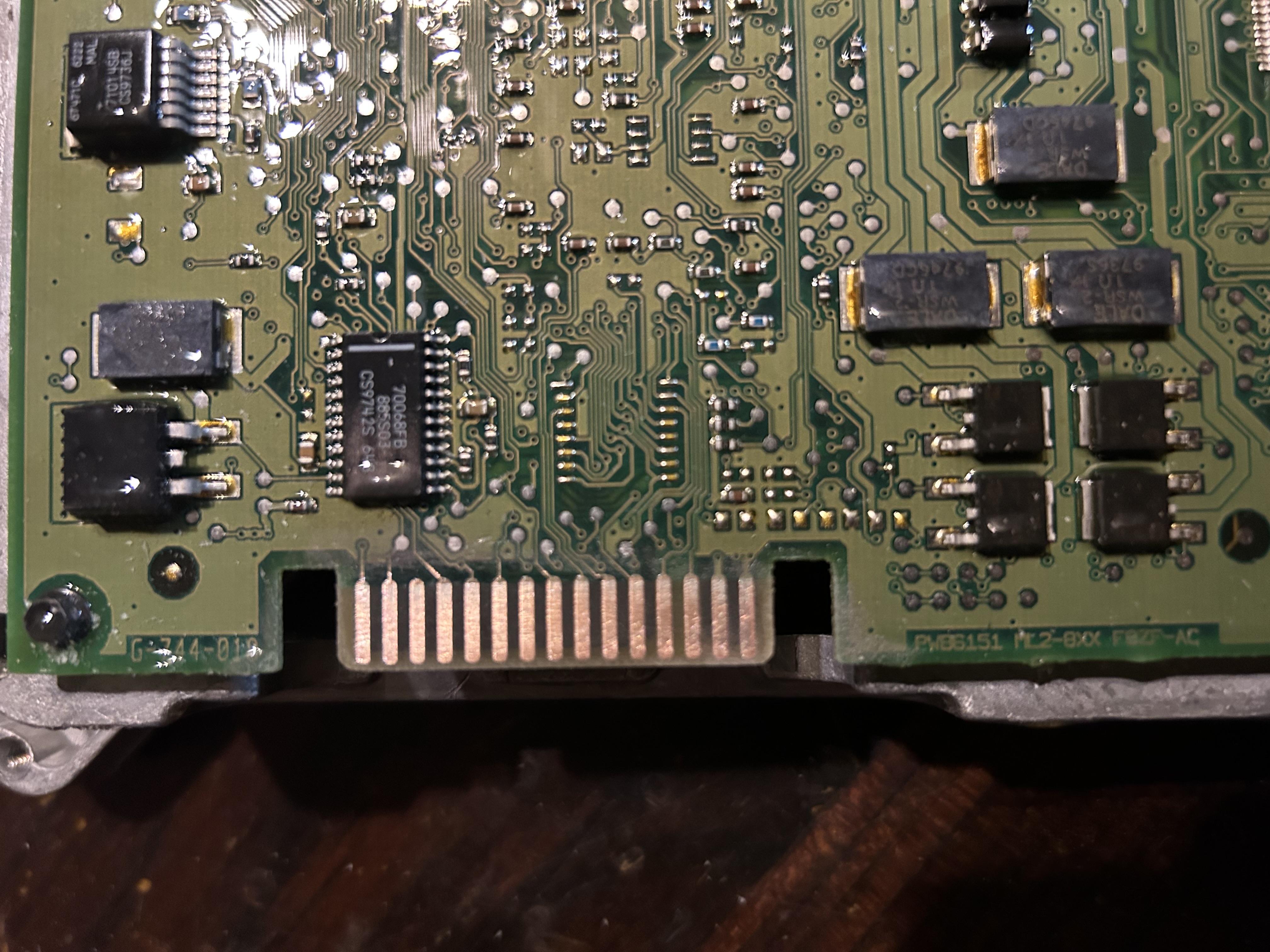

can you post i pic of the circuit board? could rule out jsa's point about the shoulder pads

Well as it turns out the port infact was not cleaned properly. I was under the impression all that needed to be done was the dialectic grease cleaned off the pins. I lightly scuffed the port with some sandpaper until the contacts were copper colored reinstalled in the car connected my chip read my stock tune flashed it to the ECU disabled pats and it started and functioned as intended. Tho I did notice for some reason in my xdf under “cubic inch displacement” my factory bin shows as 4228 cubic inches. When I changed this in live tuning with the engine running my idle spazzed out. Aside from that all is well and works as intended. I appreciate the help and suggestions.

rusty_lawrence wrote: ↑2023 Nov 13, 14:21 can you post i pic of the circuit board? could rule out jsa's point about the shoulder pads
This was after a light scuffing
